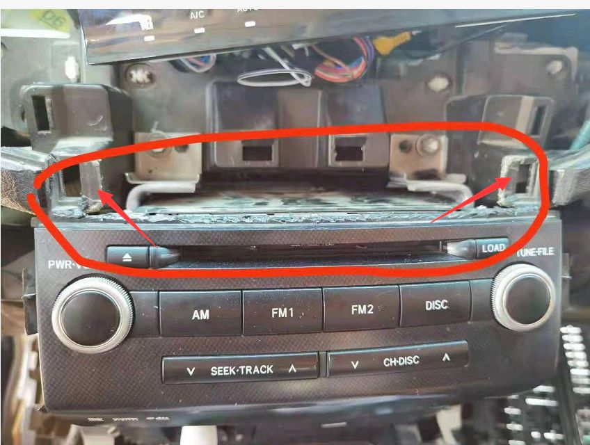

FWIW, I purchased one of the EIKY Units and could not get it to work. No sound, but did not spend a lot of time on it. I asked which one worked and they told me STYLE A and I bought it. For a 2010 200 with JBL.
Issue is you cannot install it without hacking a bunch of plastic to make it fit. Not prepared to do it. Also not sure if it would fit better with the JBL.

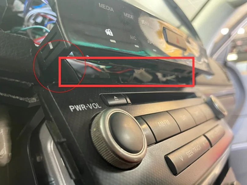

Wondering if anyone has some advice. This weekend, I was trying to install one of the Tesla-style units on a 2013 200 series. Installation went well enough but ran into a few issues - the biggest one was none of the cameras worked. Nothing insurmountable but based on my review of these threads, I think I'm missing a few parts.
Here's where I need some help. I removed the screen and reinstalled the OEM parts - everything works well except none of the cameras now work (front, mirrors, and rear). When I shift into reverse or hit the camera button, I get a black screen. All other items function (radio, cigarette lighter, etc). When I went into diagnostics mode, it showed the cameras as "OK," however, when I hit the camera button on the screen in the diagnostics setting, the screen would go black and would not reset until I restarted the LC. I figured maybe I blew a fuse that controls the video processing unit for the cameras but when I visually inspected multiple fuses I couldn't find one that was blown (I actually don't know which fuse I should be looking at - I inspected all the multimedia/radio fuses I could identify.).
Anybody have any thoughts or recommendations? Would certainly appreciate it.
