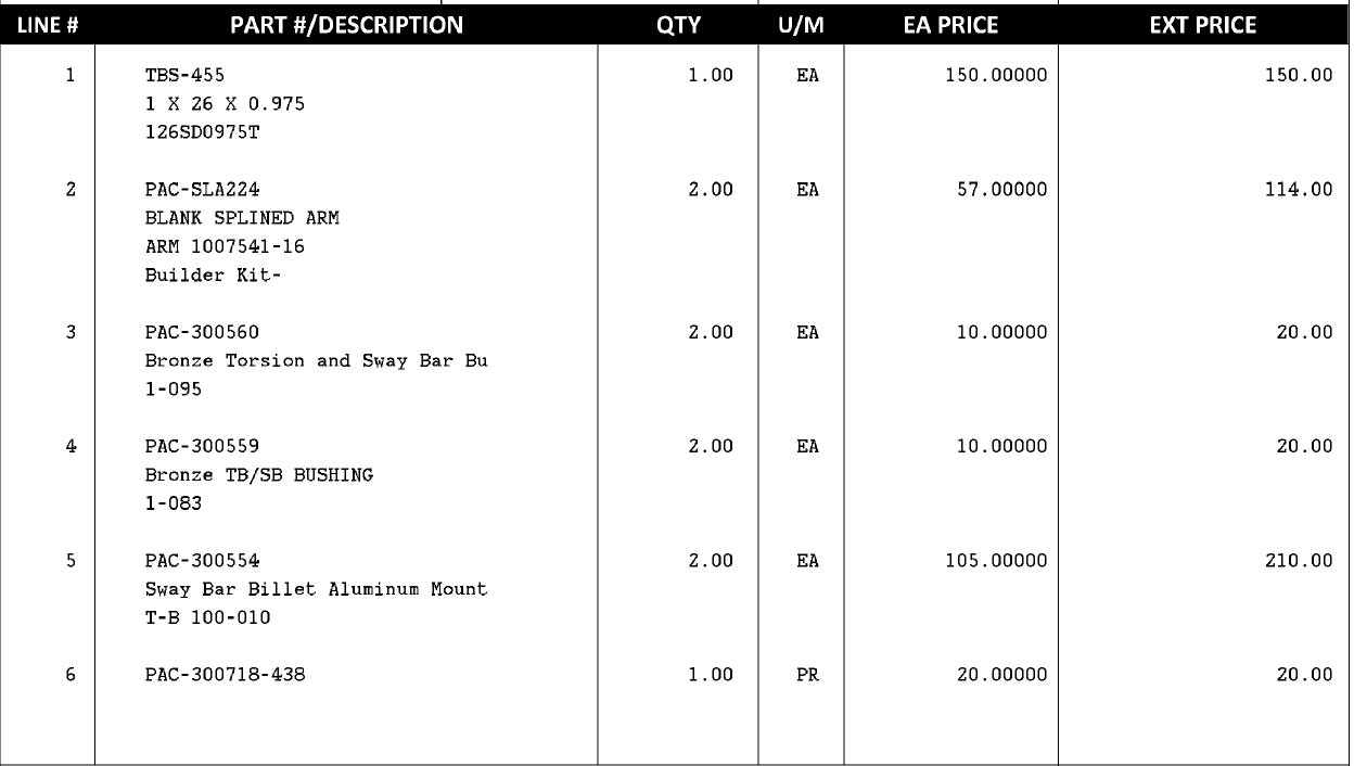

One of my sway bar arms broke so I decided to just start over and build a new setup. I didn’t have any issues with the old one but I decided to go with steel arms instead of the aluminum arms and ½” rod ends instead of the old 3/8” I used before in the hopes it will survive another ice chest attack.

What diameter bar and arm length on the sway bar? How’d you break an arm?
New bar is 26" long and .975 Diameter. Part numbers for new set up.
Old bar was 26" long .875 Diameter.
