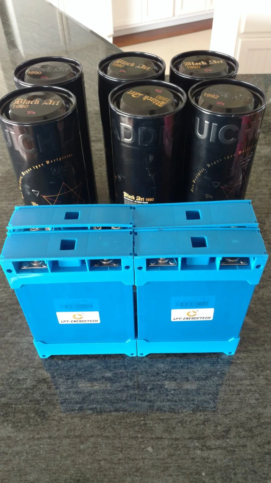

As if I didn't have enough distractions batteries and booze just showed up in the mail today, still waiting for the BMS I ordered to show up and I'll start experimenting with the batteries. I'll most likely start experimenting with the booze right away.
What's BMS?? IM Stupid 🤪😎
battery management system (bms)
If I'm understanding what I'm reading correctly these little LiFePO4 Cell batteries should be close to the capacity of my two AGM batteries and weigh just under 20 LBS when it's all said and done.
Going to mount everything in a case to test out and if everything goes to plan I’ll come up with something to make them permanent in the pig.
Amazon product ASIN B07S5GWSXZ
