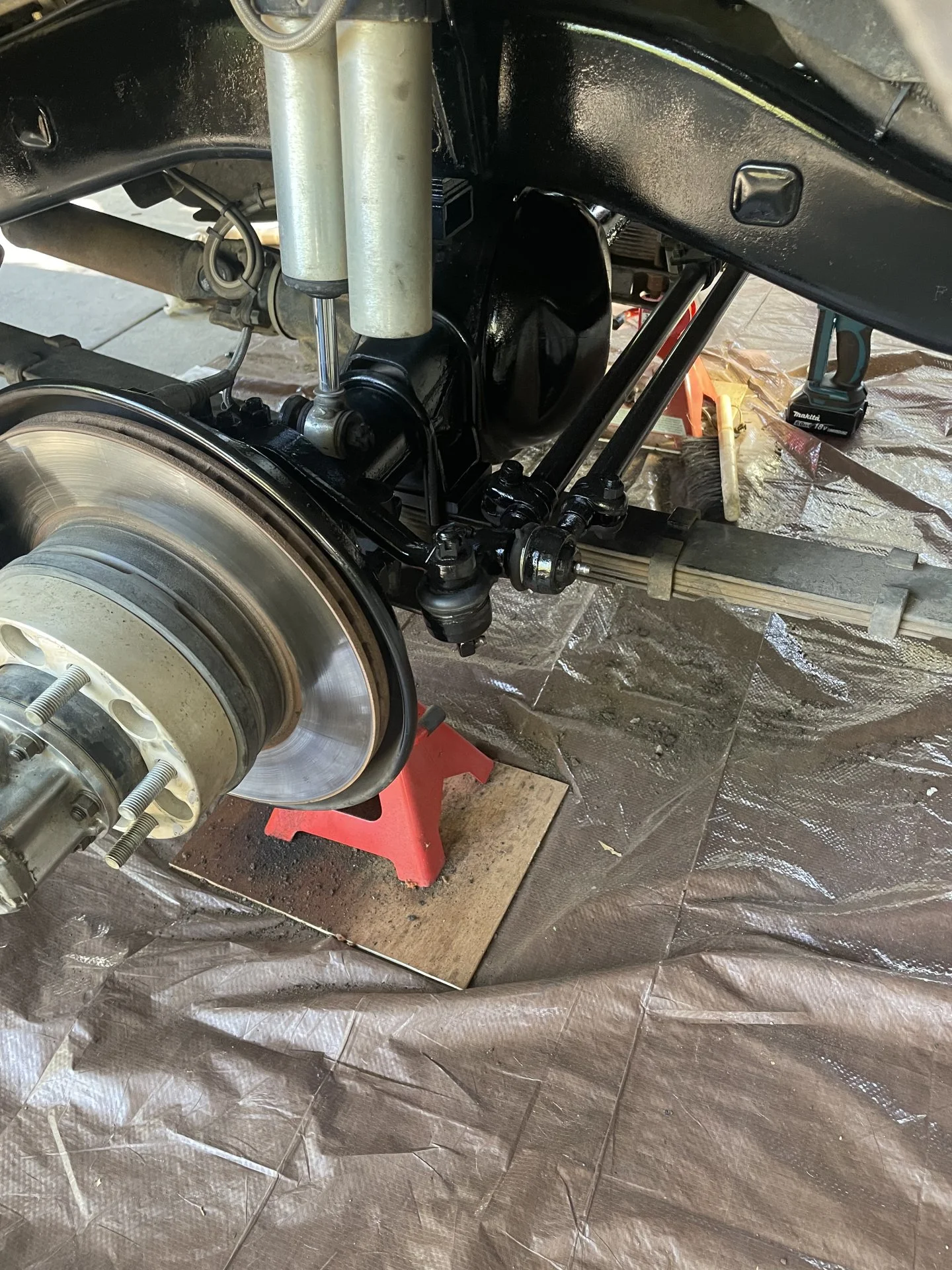

Checked the torque on all the passenger side component bolts and checked for excess movement. All appears fine on passenger side.

confounded on how I lost 3 steering arm bolts

Get yourself some marker paint and run a line so you can make a visual check

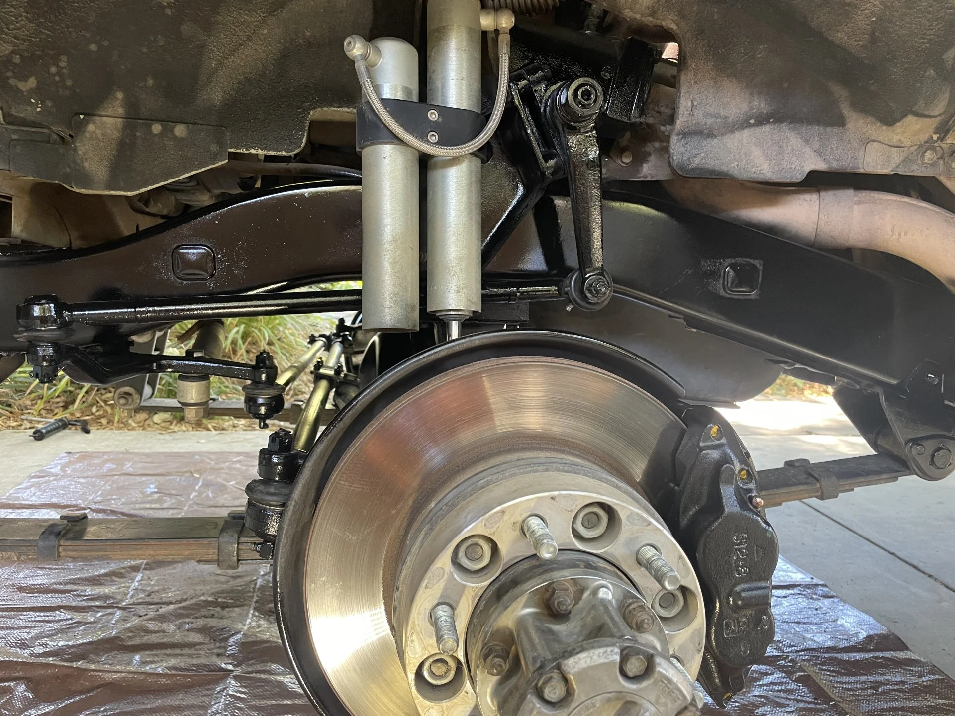

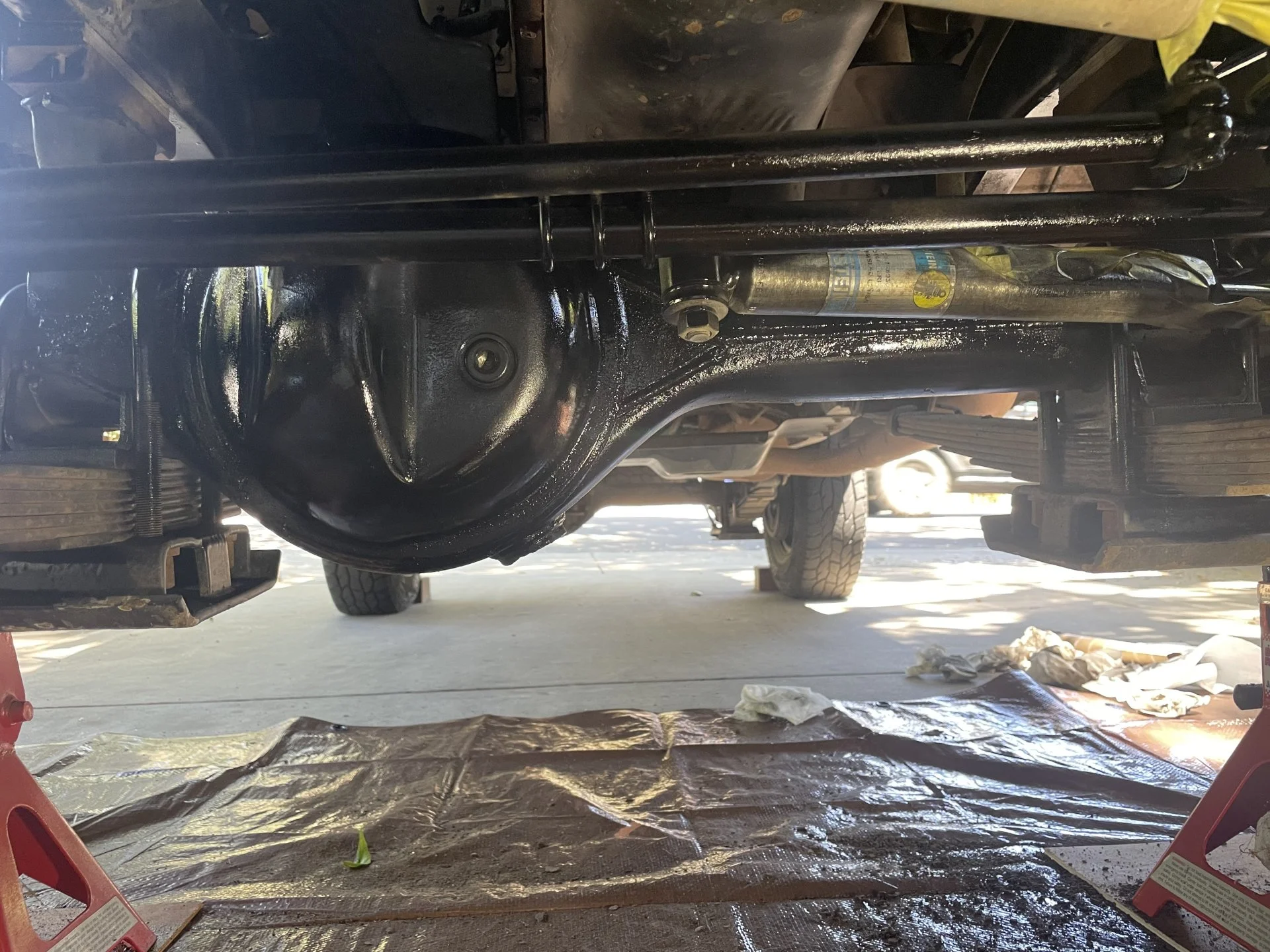

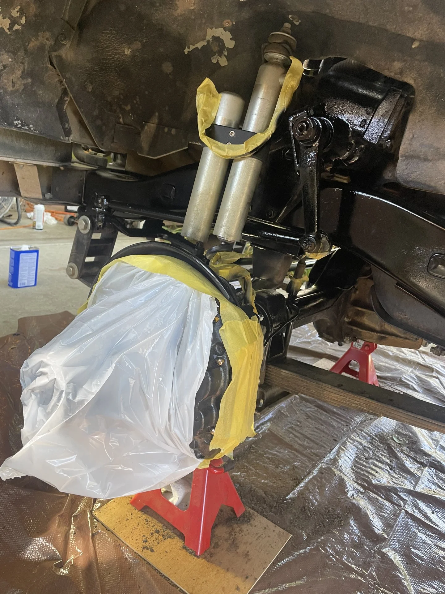

So finally got some time to spend on my sweetheart. Misc. Service, repairs and tidying up areas that that could use TLC. After the close encounter of possibly biblical consequences I will be more diligent on inspections.
-Made sure the passenger side wheel bearing is properly torqued. Used the 10 lb rule. Left side was done when knuckle rebuilt.
-Installed new calipers on the front wheels ( need to give them another bleed)
-Thoroughly cleaned, inspected and painted steering components.
-Replaced a bad grease bladder. (2 more to do)
-Greased steering ball joints

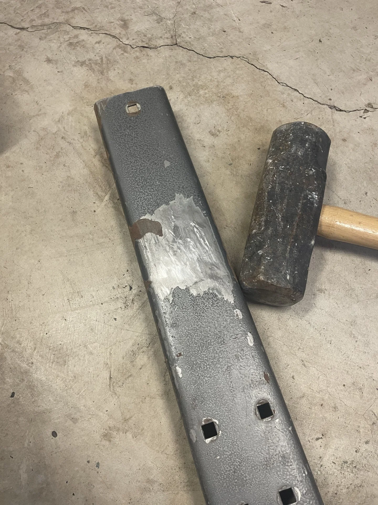

-Removed rear bumper to massage out the bends and dents.
Working on rear bumper repair.
Had to get out my metric body alignment tool to put the finishing touches on the center section.
