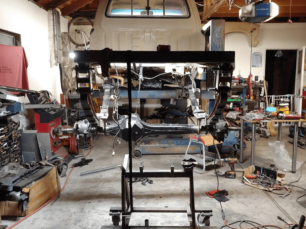

Hoping I have time this weekend to install and fab hydro brackets and complete my PSC ram kit.

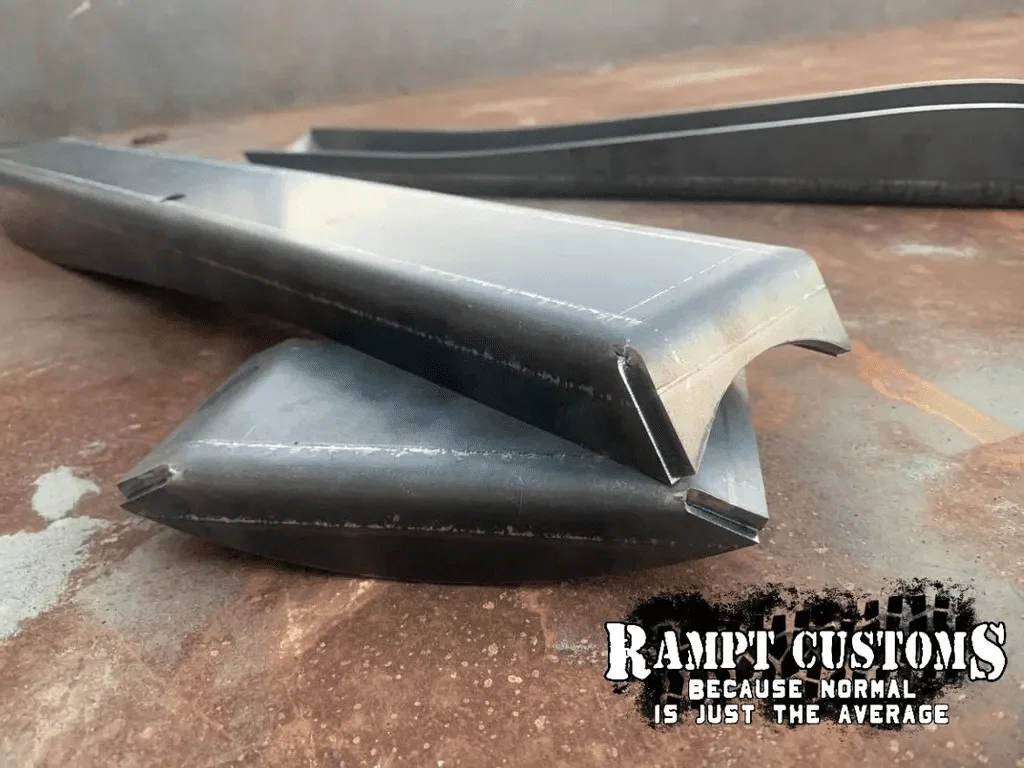

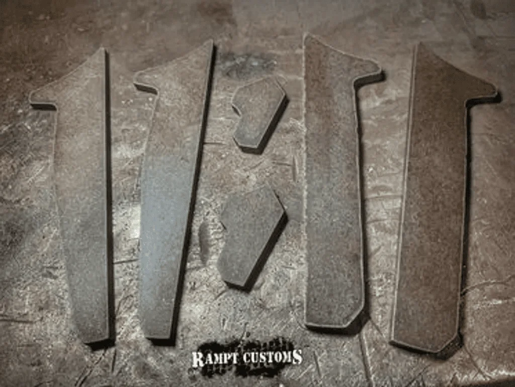

Also ready for install is the Rampt Front Axle Truss kit and Rampt Knuckle Reinforcement kit. Will tackle all this since I'm under the front already welding it up.
The prices are right for sure. Damn, those are some serious knuckle ball guests. Is the truss to support the bigger tires? Do you plan to jump your 80? I’ve slammed mine around pretty good and it’s still straight. I think ...... seems to be.
I bought them same time I ordered the ps box plates. Already paying for ship so I just did it. It's an easy install and I'm a sucker for while I'm in there stuff.
Also forgot I have a Marlin front diff armor I need to weld on too and a Ballastic Fab 8 inch Front Axle Bottom Skid Plate.
I'll be burning things in under the front for at least 2 days. Maybe more

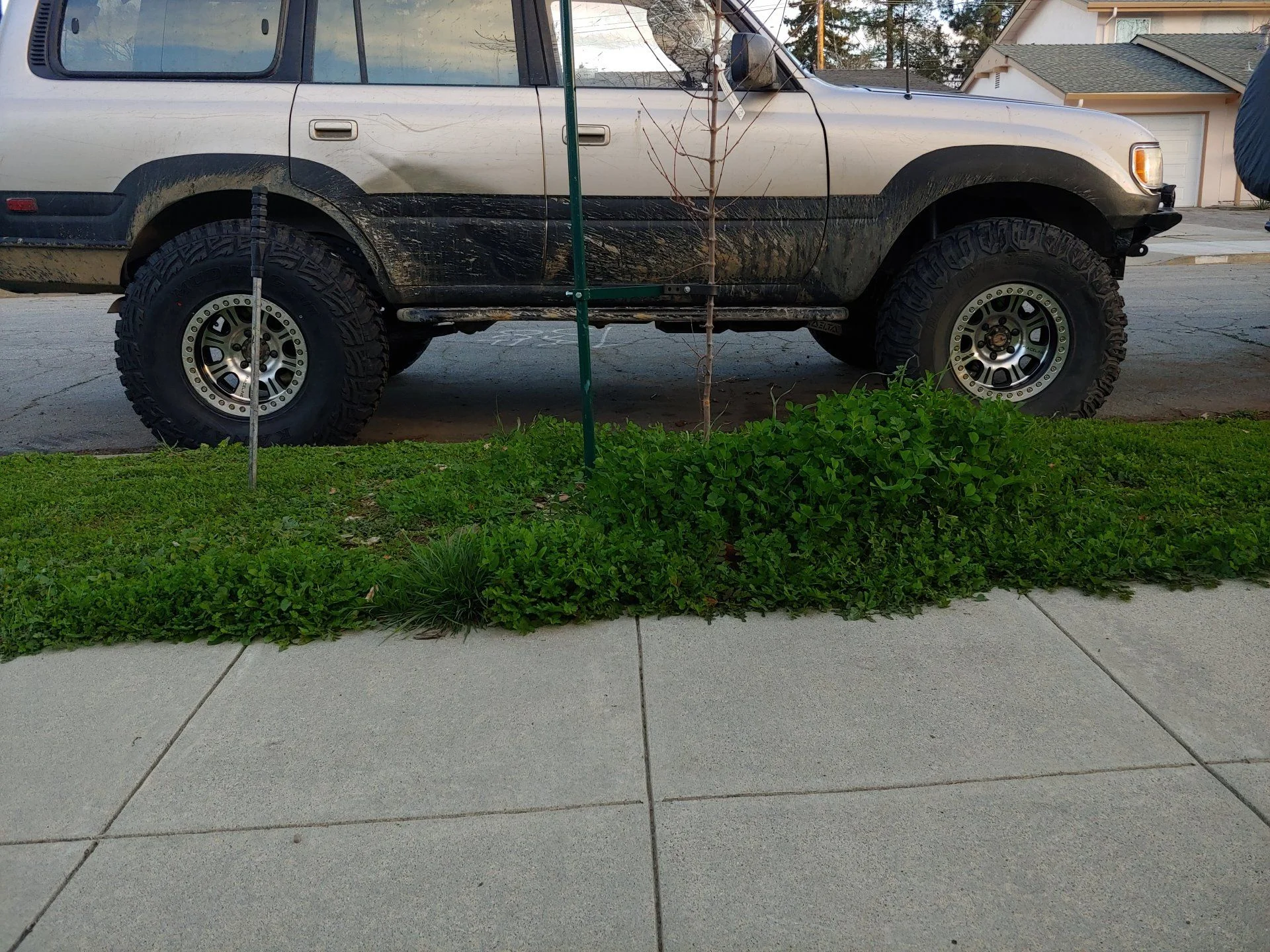

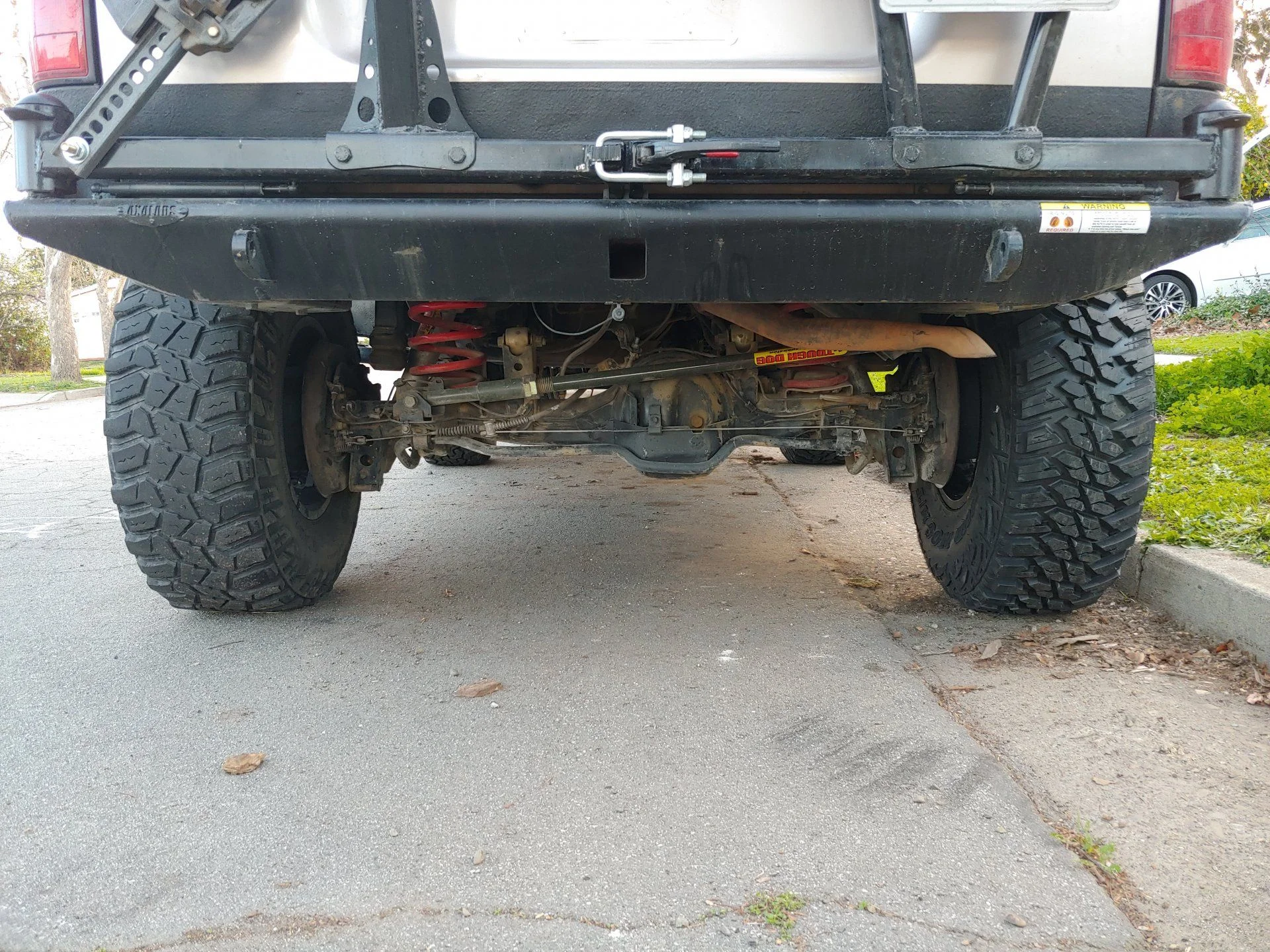

I did not plan this but it did happen, I never thought the old fat girl would get off the ground but she did.

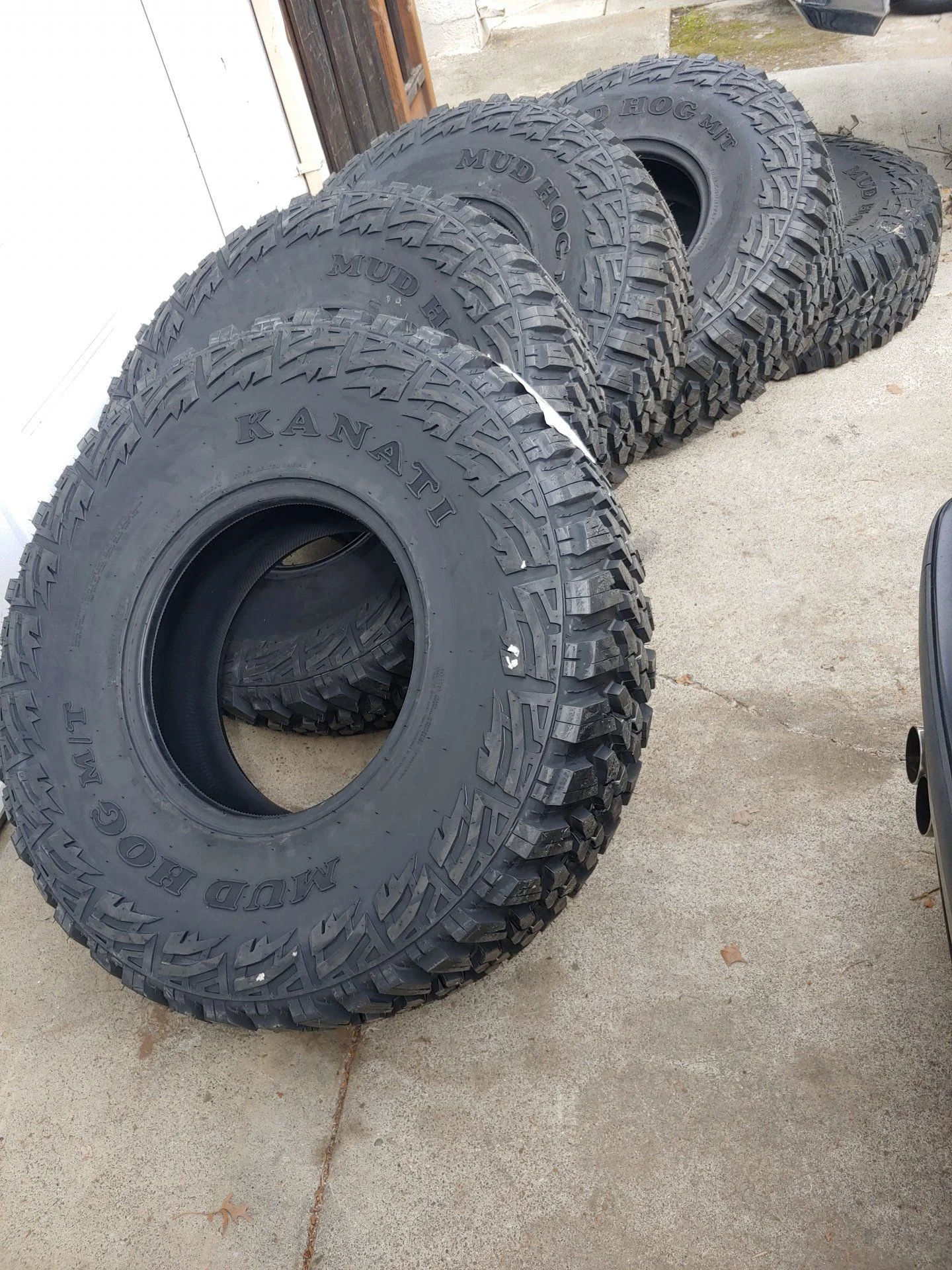

Tire porn

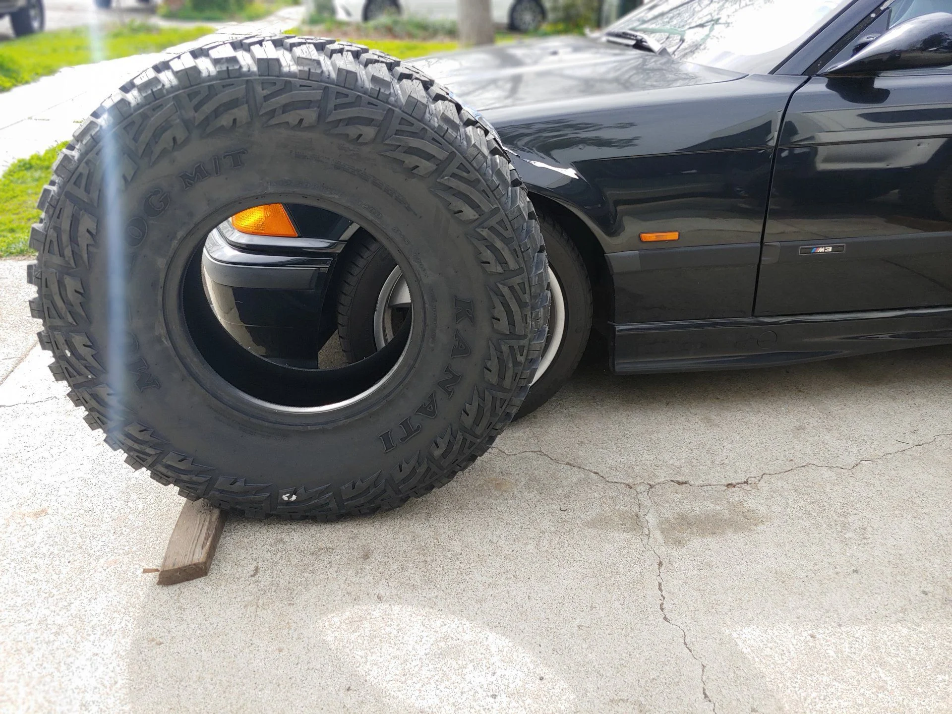

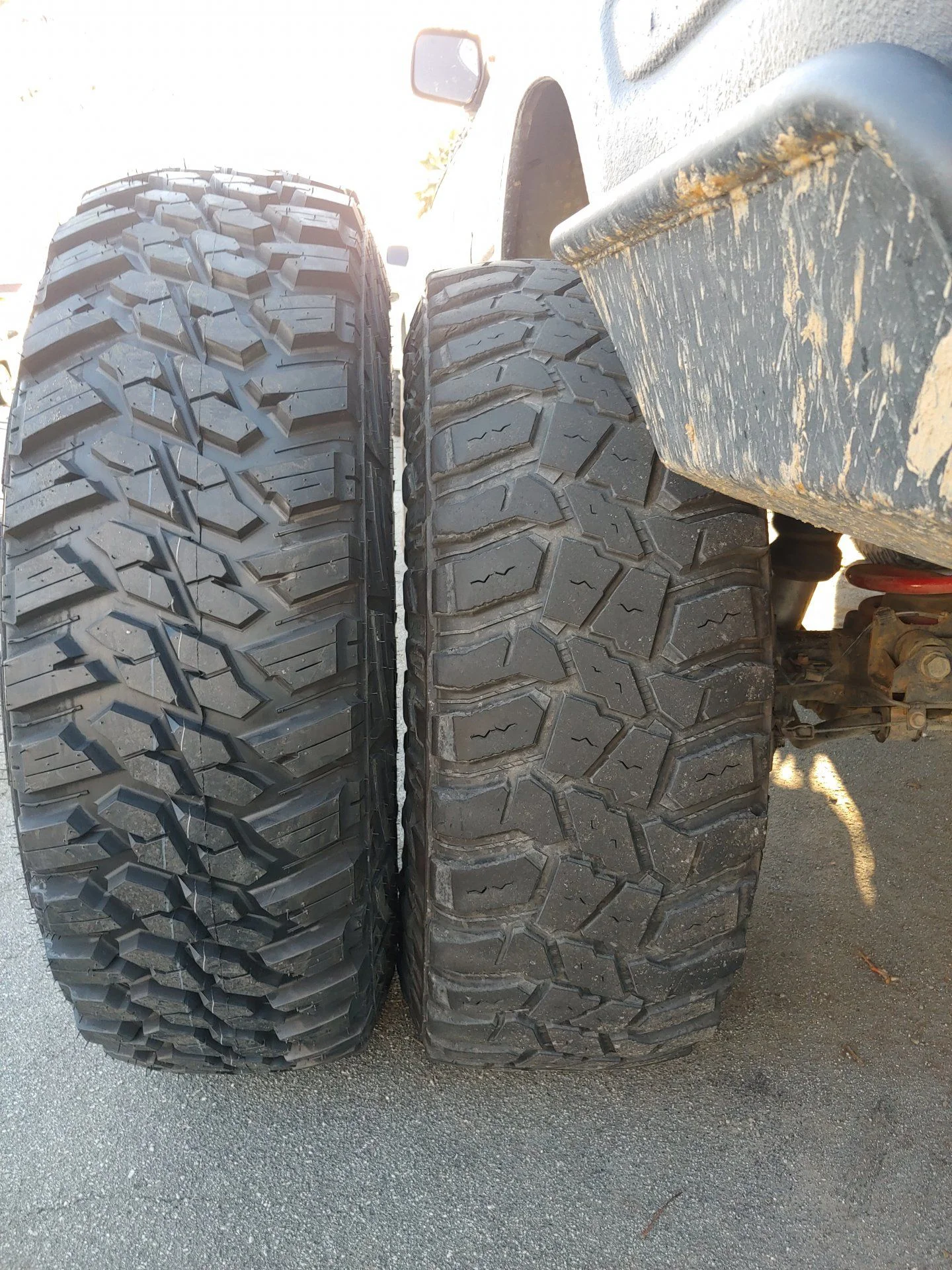

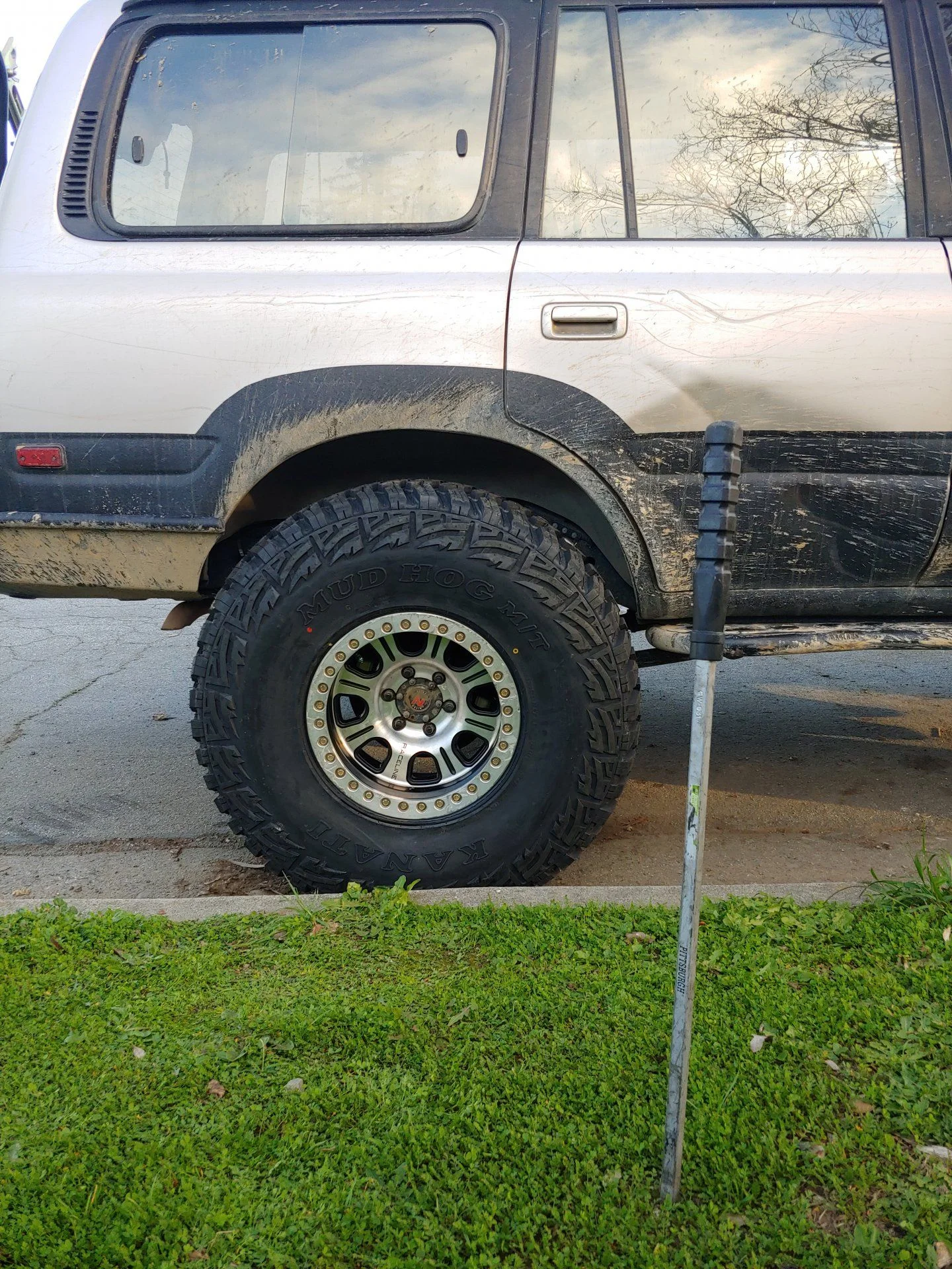

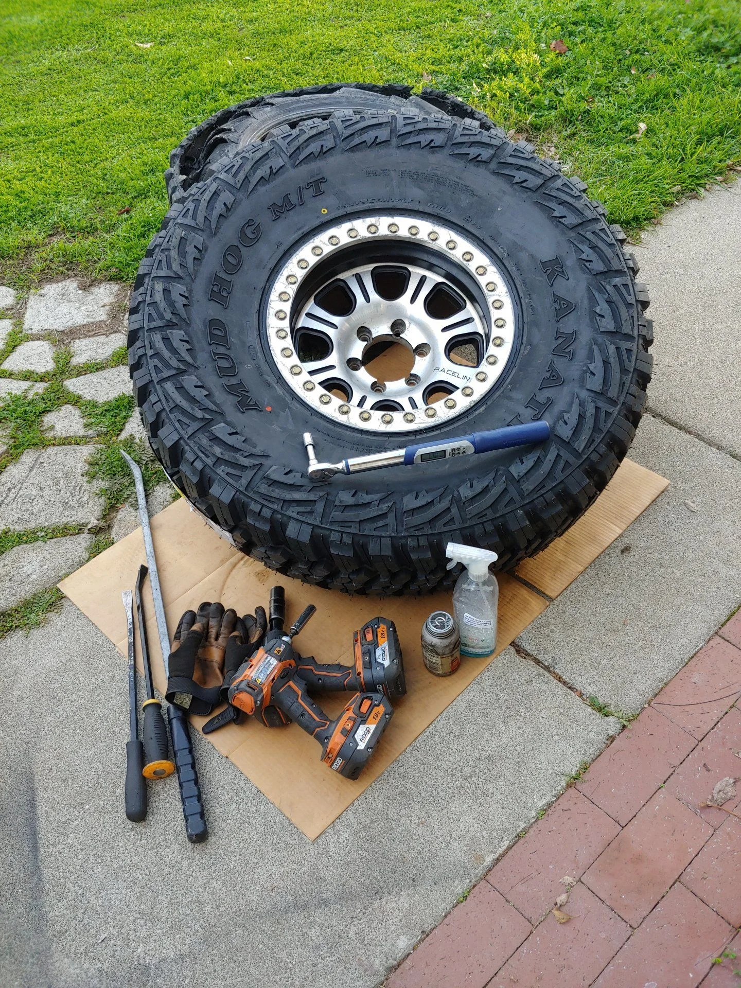

Where'd you get the Kanati's from? I have been running them in 37's and love them, but it sure seems like the price on them has gone up now that I want 39's
Wallyworld 272 each delivered. Just wait till they restock. There's a big tire shortage in the states right now cuz of the whole covid-19 and the shutdowns doesn't help manufacturing process
Those wheels a super nice. Get out the sawzall....
