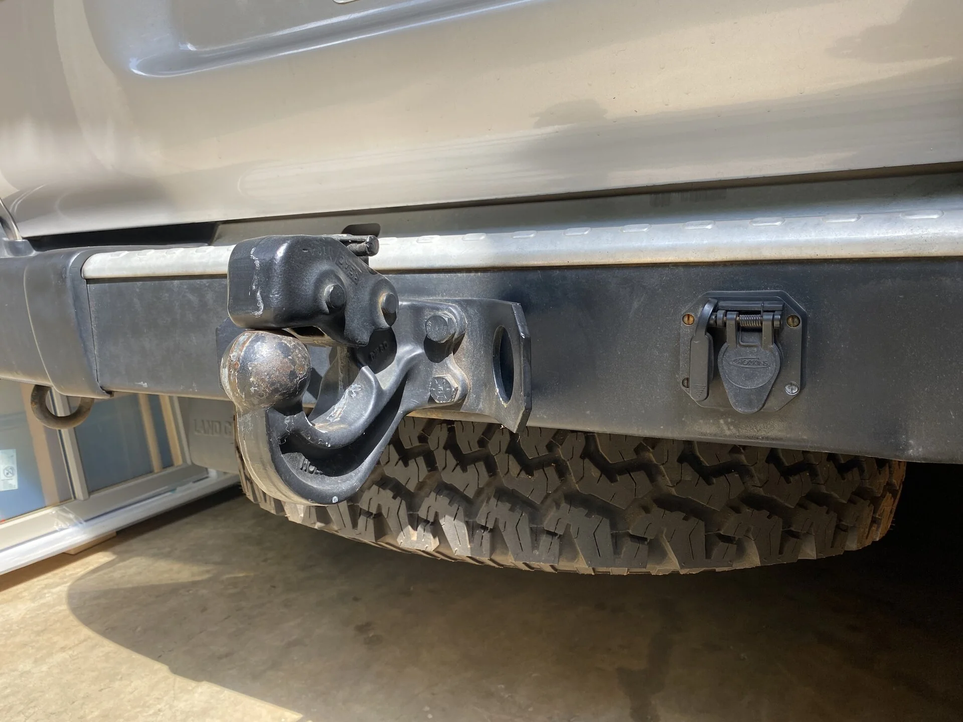

I was going to suggest the same as @Living in the Past . I use a Pintle with built in ball on my 80 series. It works well.
Edit: Here's a photo:

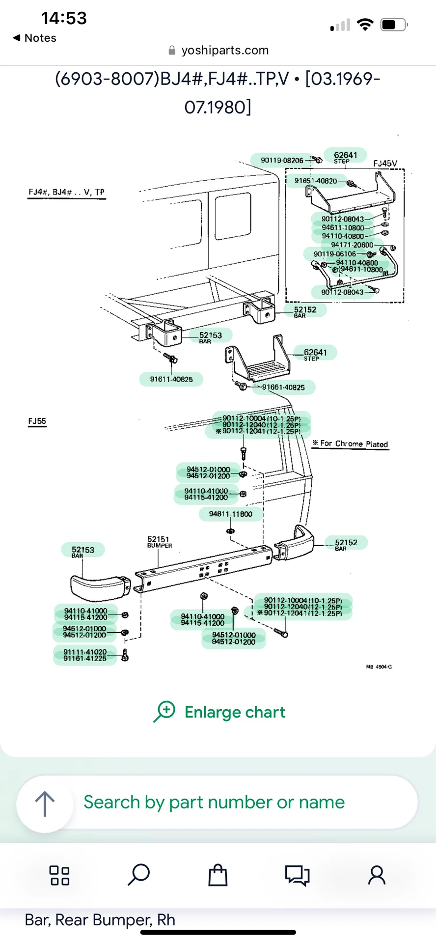

This is a parts breakdown for Land Cruiser….. looks like in 69 (earliest listing) the shorter step may have been intended for the FJ45…..however, the short step on my rig is an original.

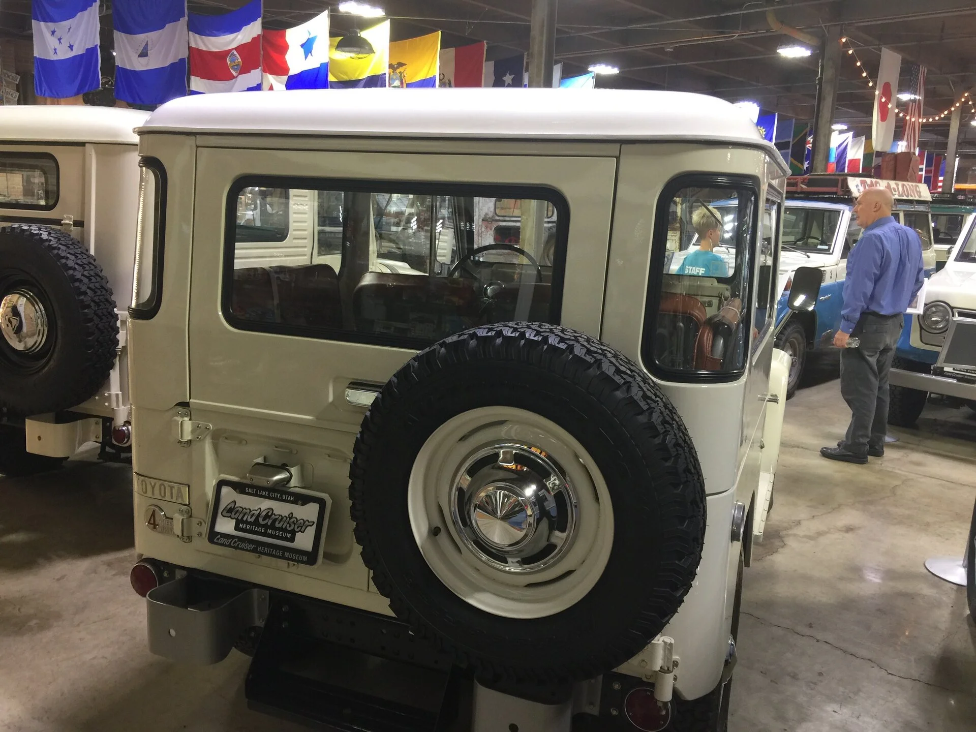

Attached is a picture of a 67 on display at the SLC Land Cruiser Heritage Museum. If you Zoom in on the rear step, you can see it’s a short version.

That is the date for back of the 40 series. The step which is much wider is for the 45V. Those were the troopys and didn't start until 4/79. Can't remember for sure this besides being wider there silver colour and diamond plate. They also had bar on the sides. Both the FJ40 and FJ45V the flange is bent out. If you look of the part number for the FJ40 it will change 9/73. 62641-60020 is 9/67-9/73. 9/73 and later is 62641-90300. 9/73 the flange changed. Because the tail light change bumperettes moved step changed.

I can't make out if it's shorter or not. I can tell the angle is the same as the seven factory steps I have. Passenger mirror and hub caps I believe this 67 been restored.

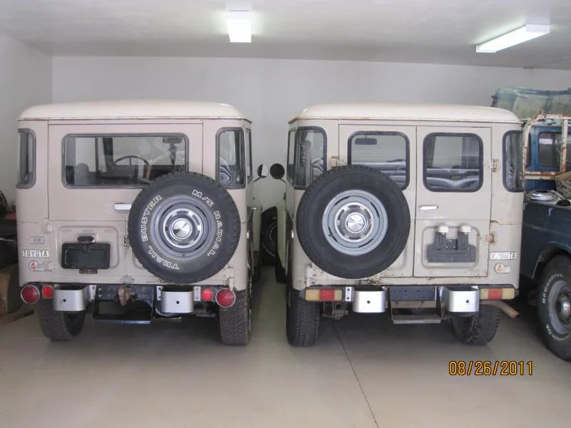

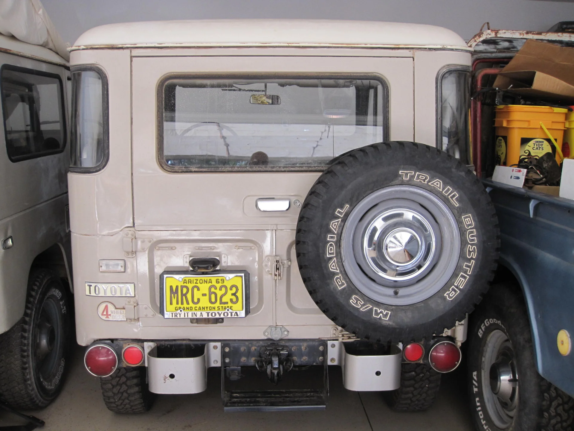

These two are original paint FJ40s.
The 70 unfortunately had a 2F installed in 1975 The F had burned a exhaust valve. Owner said someone pulled the 2F out of a brand new 75 and installed a V8. Last time I checked the serial number on the 2F was lowest here in the US in the 2F thread. The pintle hook I added the step and bumperettes removed when new and came with sale. Those are original paint..build date is 10/69. The owner also gave me the rear steps and bumperettes off two 63s he and his dad purchased new. Bumperettes are beige. Back then bumperettes were painted body color. The Ramsey winch was a dealer added option back in the sixties.

The other cruiser is a 10/75 76 model with 4,502 miles on it. It has a story as well. But the paint is original.

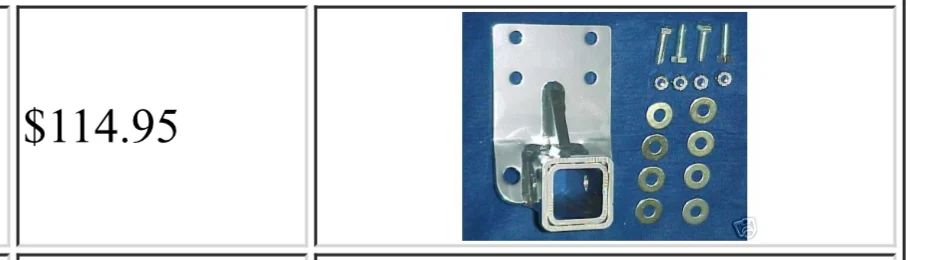

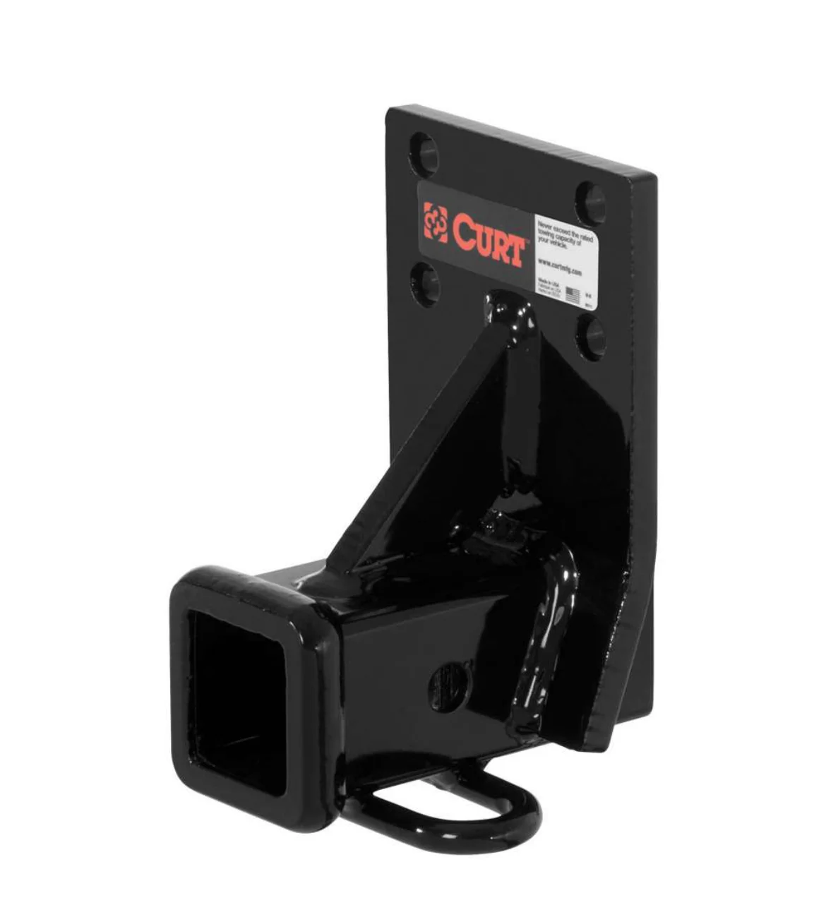

From the look of these, they could be mounted higher by drilling 2/4 new holes. Mark’s Off Road @65swb45 also sells a similar hitch if I recall correctly.
Found on his specials page:

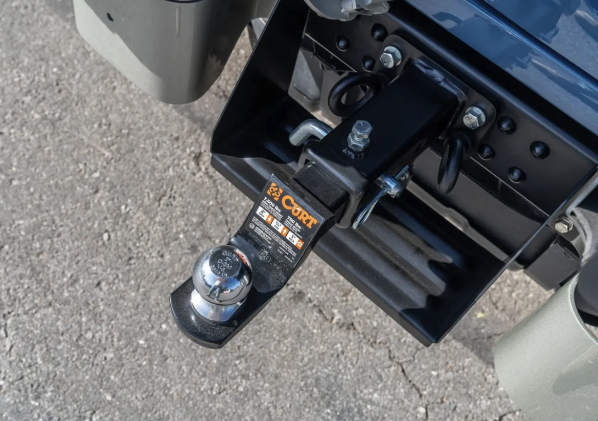

I put in a rear bench seat to make it safe for little kids in car seats, so I don't worry about the rear step. But I think this setup allows for a foothold. Don't be wearing your bellbottom jeans, though.

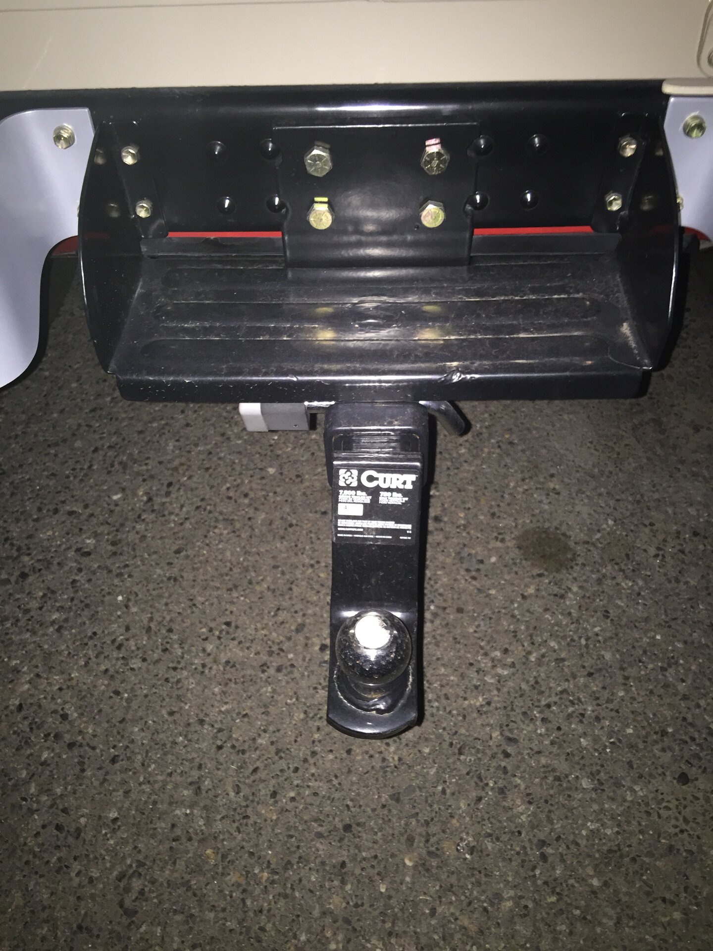

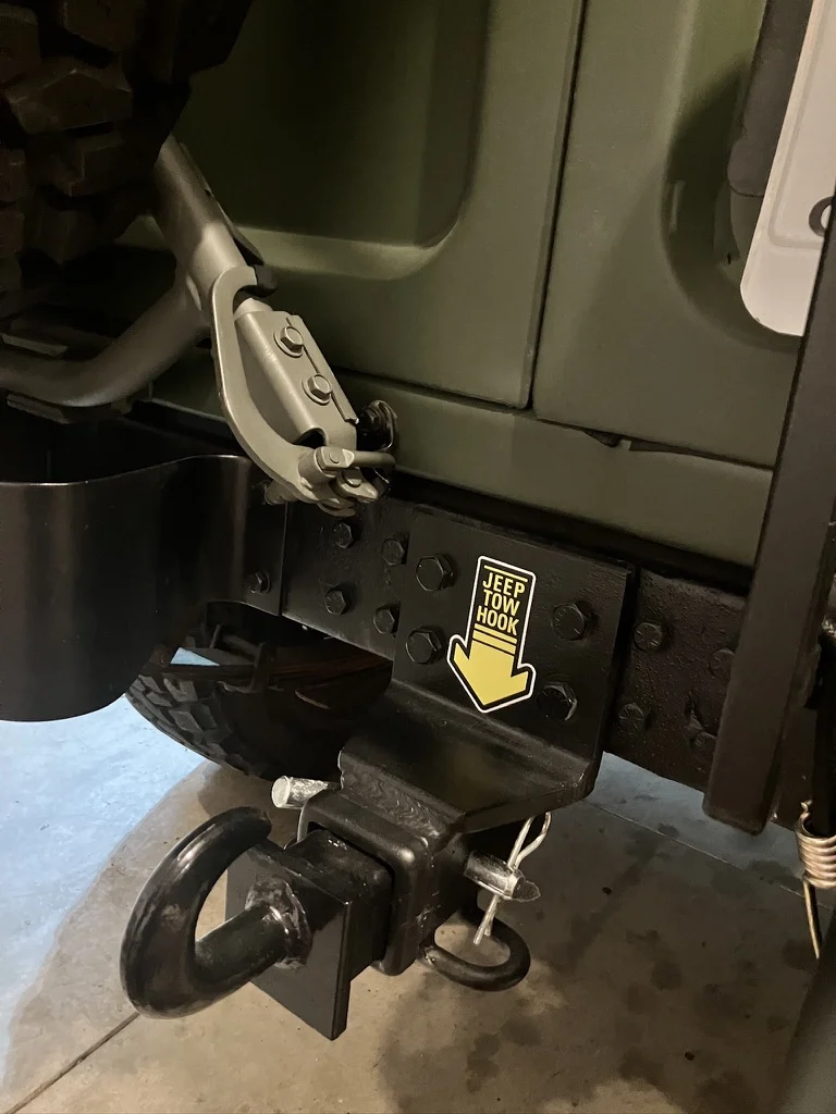

I made a custom receiver hitch and bought a long extension/insert. I rarely tow, and only tow light stuff, so it doesn't have to be a monster hitch. When removed, the step is functional.
