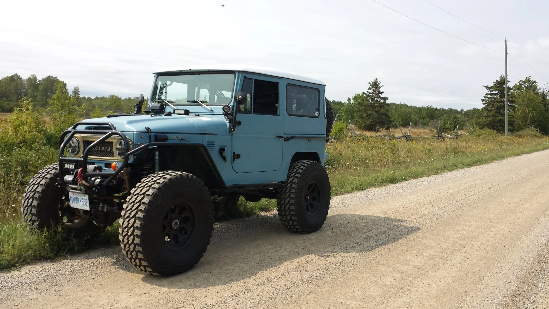

The airflow in the 40 needs to improve.
I have the older hard top without pop out vent windows and I find it stifling when wheeling on a hot day. Seems like all the hot air gets trapped in the cargo area and just sits there mocking me. When im out tooling around on the roads it isnt nearly as since im moving faster.

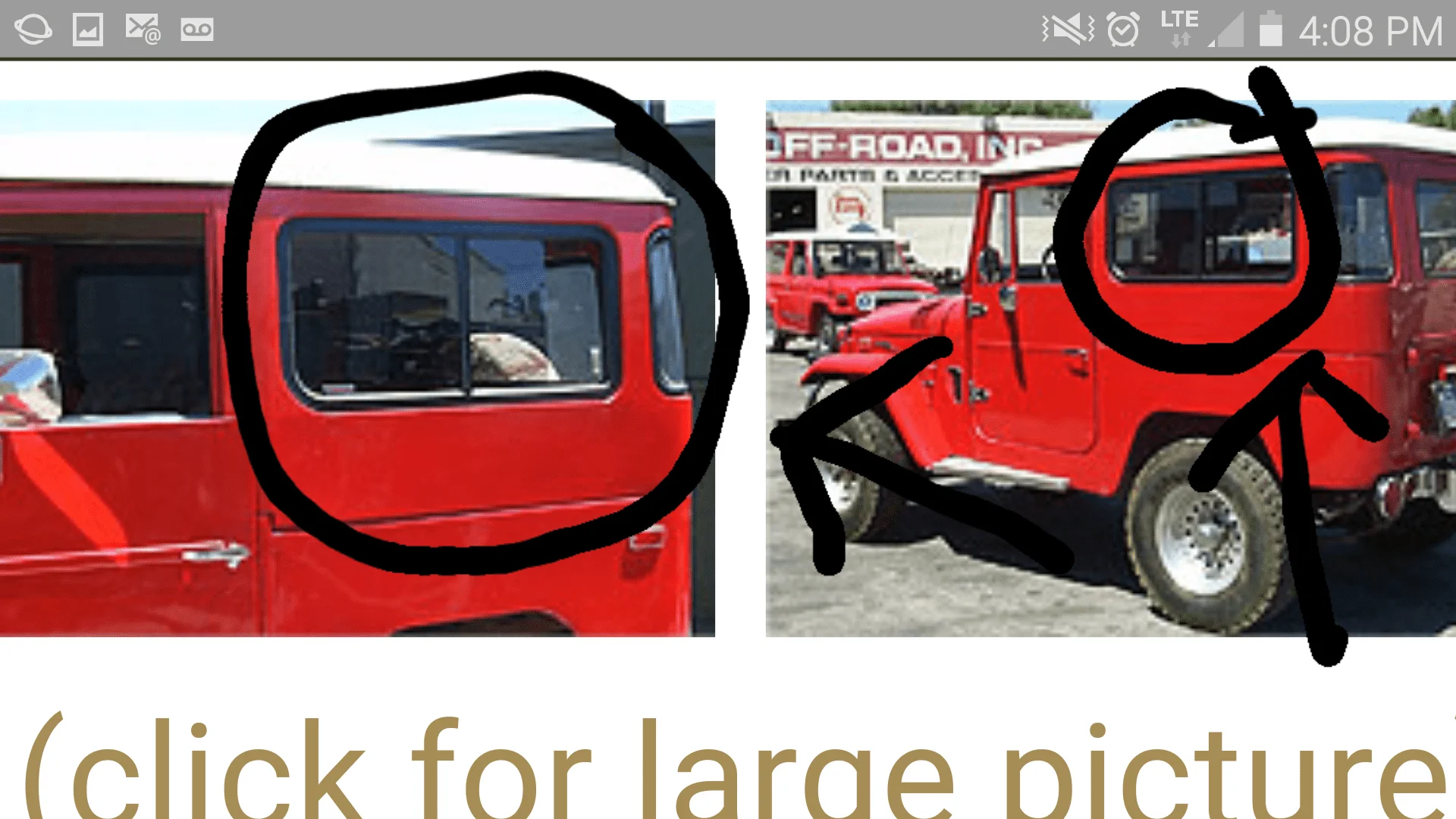

I know I can source the pop out windows and parts to retrofit my top or even just spring for different side panels that have said pop out windows already but I happened upon the specter sliders and now theyre stuck in my head. Seems like they'd offer more of an opening compared to the pop outs as well..
So... has anyone used these and have an opinion or advice to share?

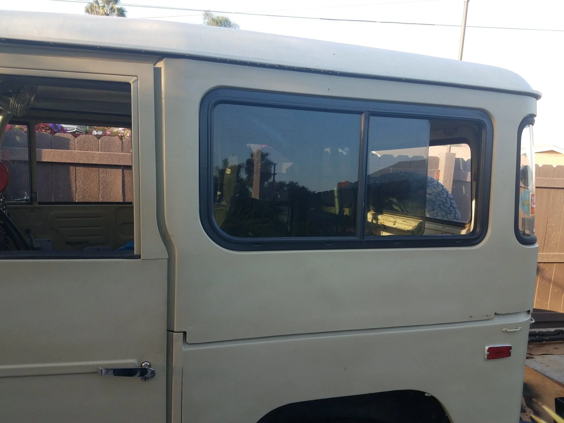

I've got the SOR windows. They're pricey, but they work as advertised. They are also a fairly quick and easy installation. I would say yes, they are worth it.

Wonder how the two styles compare. If the back of a FJ40 long enough to sleep in would think the sliding style would be nice. How both do moving air is a better comparison while driving is more important. In the early eighties when I added vent windows didn't even know about the sliding style. Bought all the pieces from a wrecking yard cheap. The large glass was broken on bought sides. Back then new glass was $17 a side from Toyota.

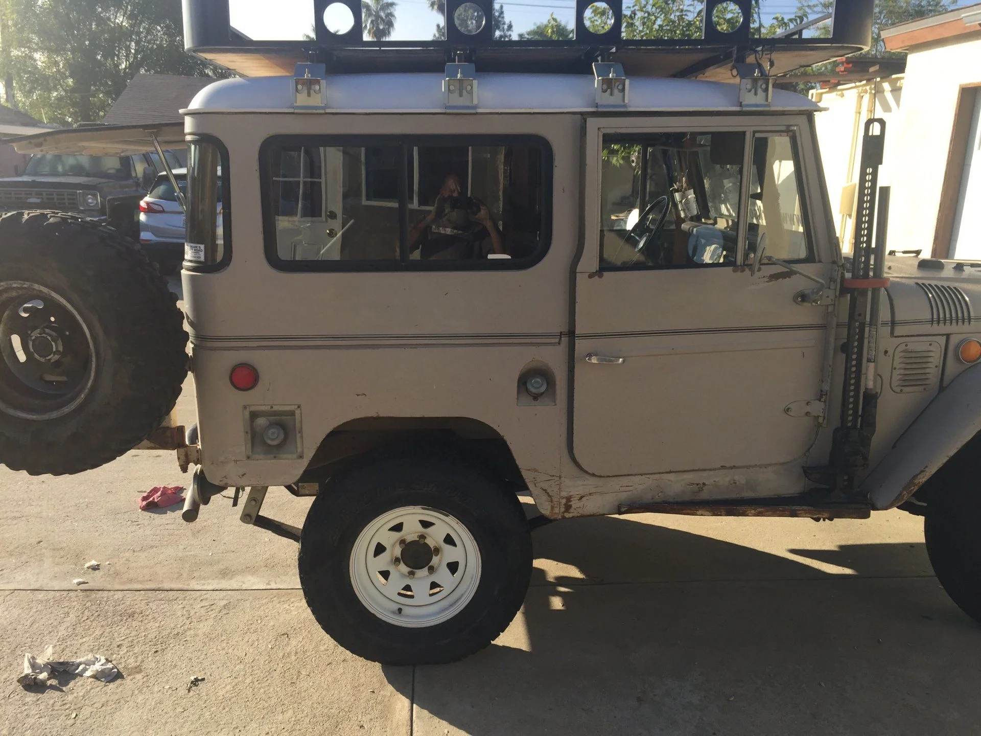

I have the SOR sliding windows on the Karma Cruiser. I like them a lot. When I take that rig off roading, my MO is to strap the ice chest to the roll cage, next to the window. When I want a drink and I’m outside the rig, I can easily reach in through the window to get into the cooler without having to open the tire carrier and the hatch to get in from the back.
A side benefit. ;)

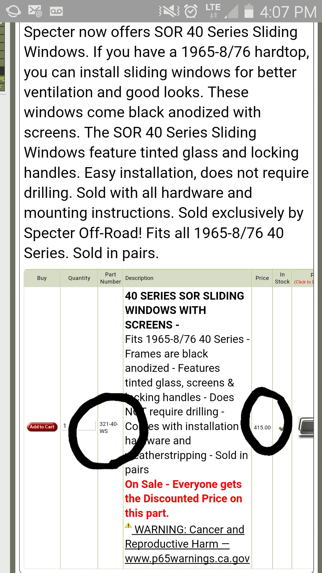

I think I've decided on the sor sliders, as a bonus a member on here has a new never installed set he's offered to me for 300. Id get a deal and avoid the huge hassle of ordering from sor from Canada.

That's a great price for those windows, jump on it!

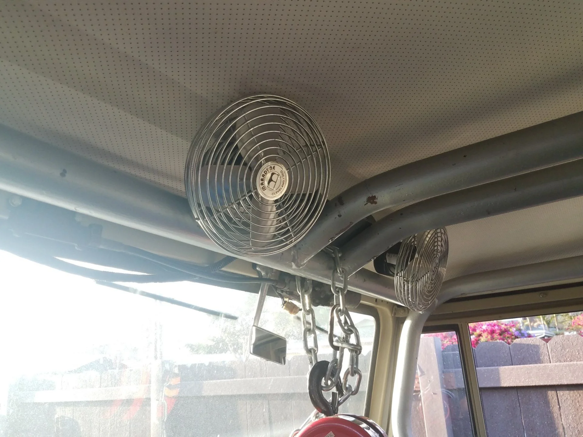

They work great for getting the airflow though when you're moving. But.. if you're slow or stopped you loose that flow, so that's where the fans come in handy. Hot weather would be unworkable for me if it wasn't for the slider/fan combo. ...nevermind the chainfall hanging from the rollcage, it's transmission swap time. :-)

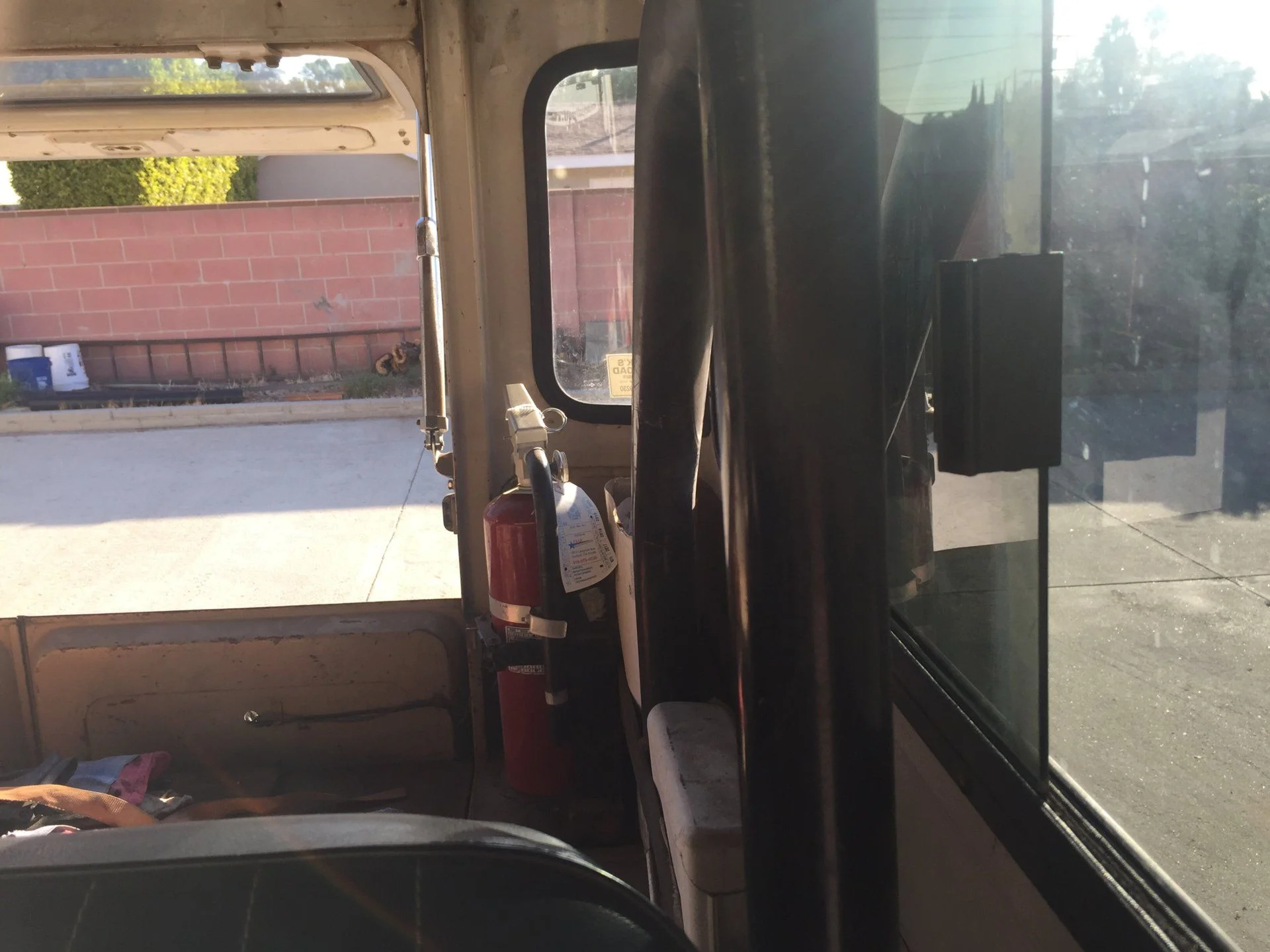

Brian #1, any interference with the slider and cage? Do you have any pics that show the clearance by chance? I have a metal tech in mine and was told that the window handle may hit the cage.

Hey guys. The glass is tinted, not a film. I was very hesitant to install tinted glass but went for it anyway, figuring I could always sell them if it bugged me that much. They actually looked a lot better than I expected, at least in my rig. I don't feel the need to tint the rest of the windows to match. Maybe the corners would look a little better tinted but I feel it's fine as it is.
No interference at all with the metal tech cage. I don't think it's even close. I'll post pics later when I get home.
The fans work well. I tried a couple cheap ones to confirm I wanted a permanent installation then ponied up a few bucks for some quality bus/truck type fans.
A front fan is nice but it seems one blowing from the back corner onto your neck and back off your head works as well or even better. It gives you a breeze where the window draft isn't helping. Probably easier to mount and less conspicuous back there too. Front can blow a little dust into your eyes when it's real dusty too.
Some days the tint looks darker than others.
Here’s a pic with the handle passing a Smittybilt rollbar:
About 5/8” of clearance.

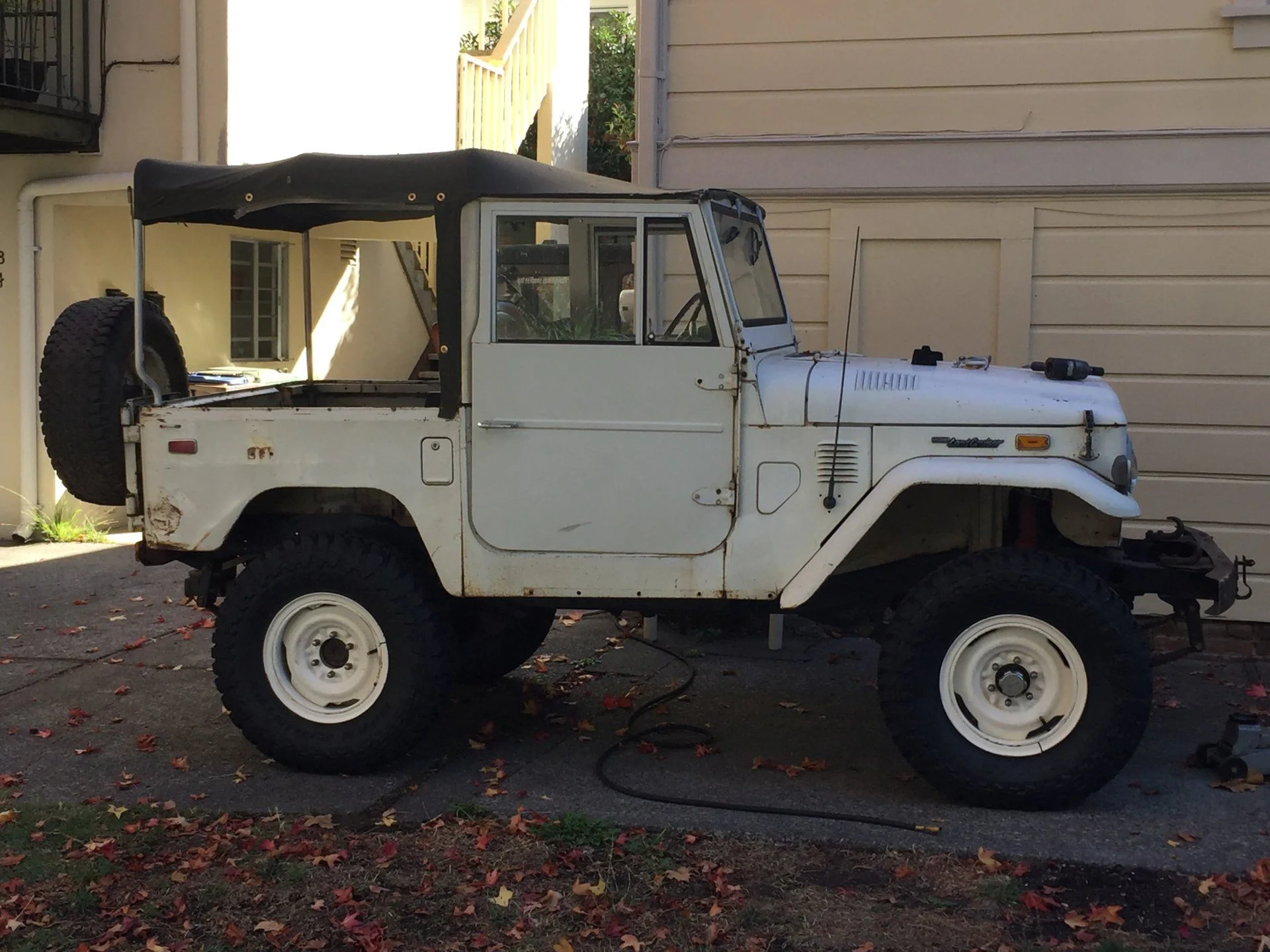

$400 is halfway towards a set of bows If you enjoy airflow........just sayin :)
Sliding windows is sorta like walking around with your fly down......whereas bows and full length bikini is like driving around with No pants on !!! :moon:
