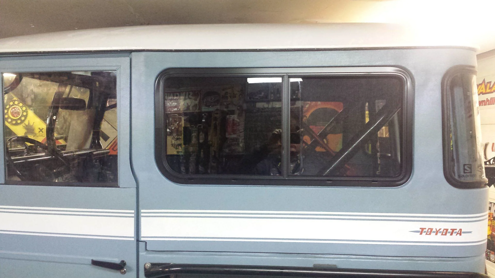

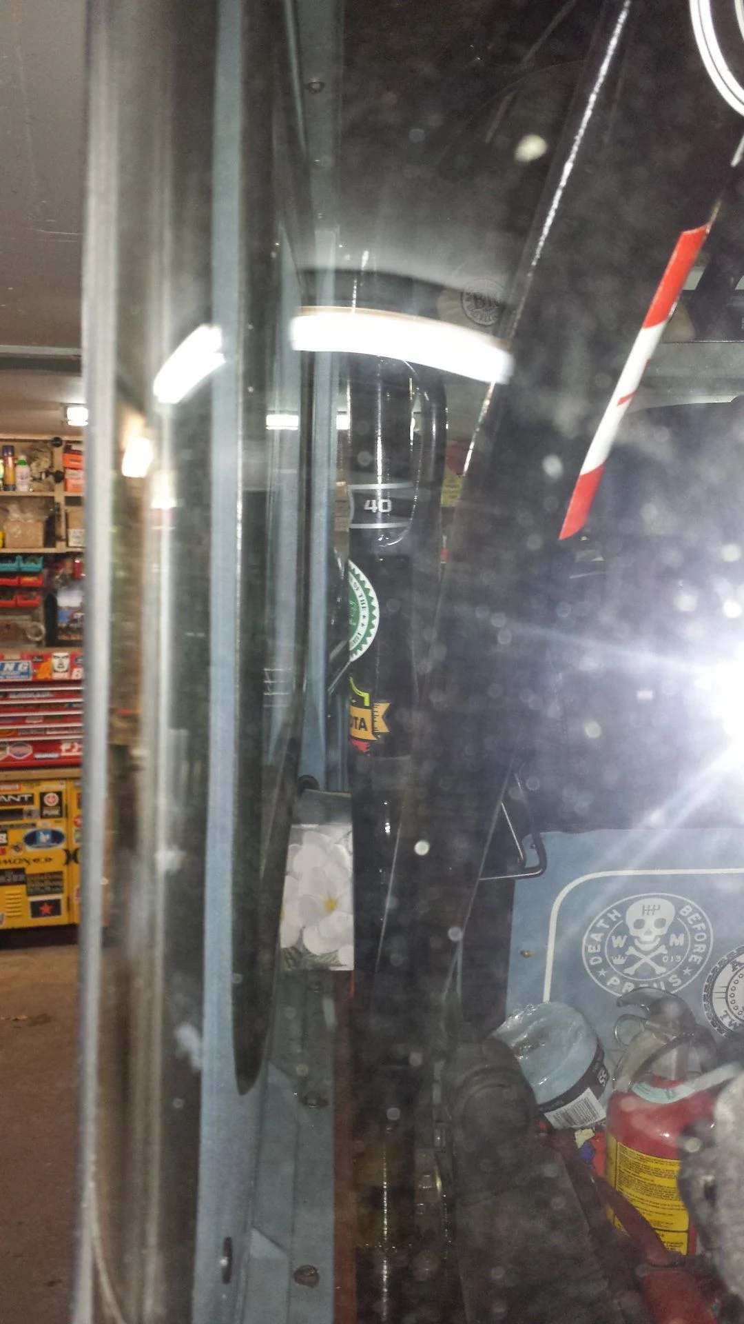

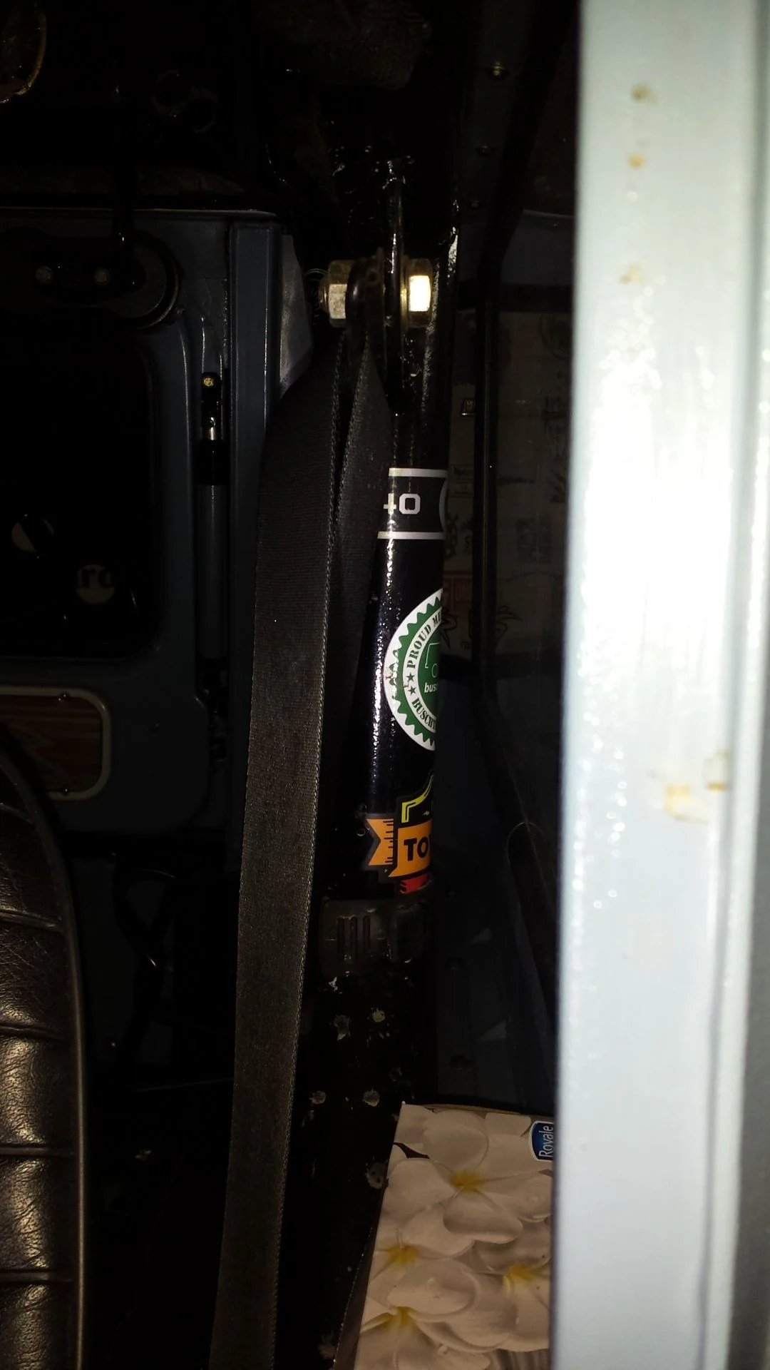

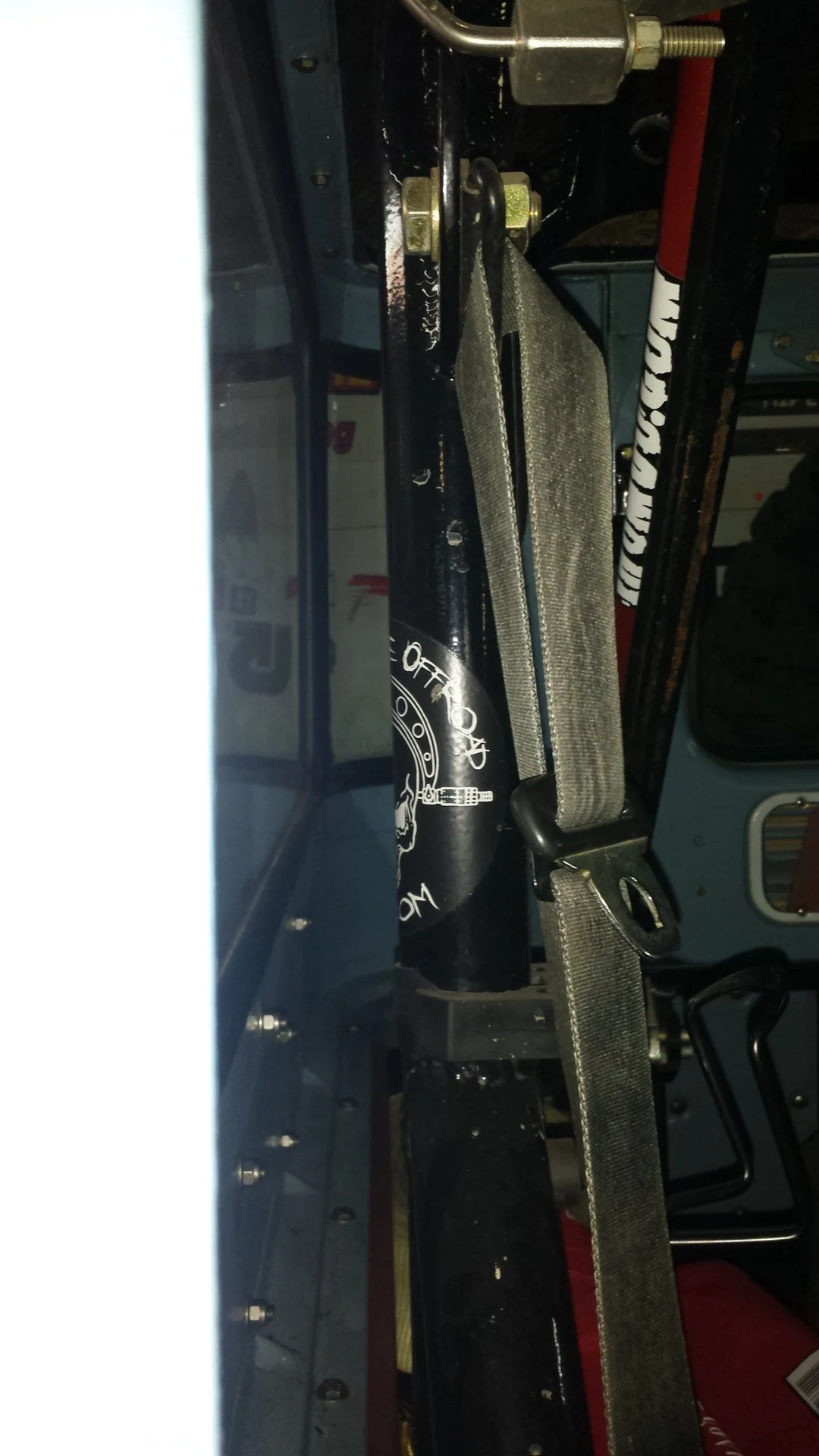

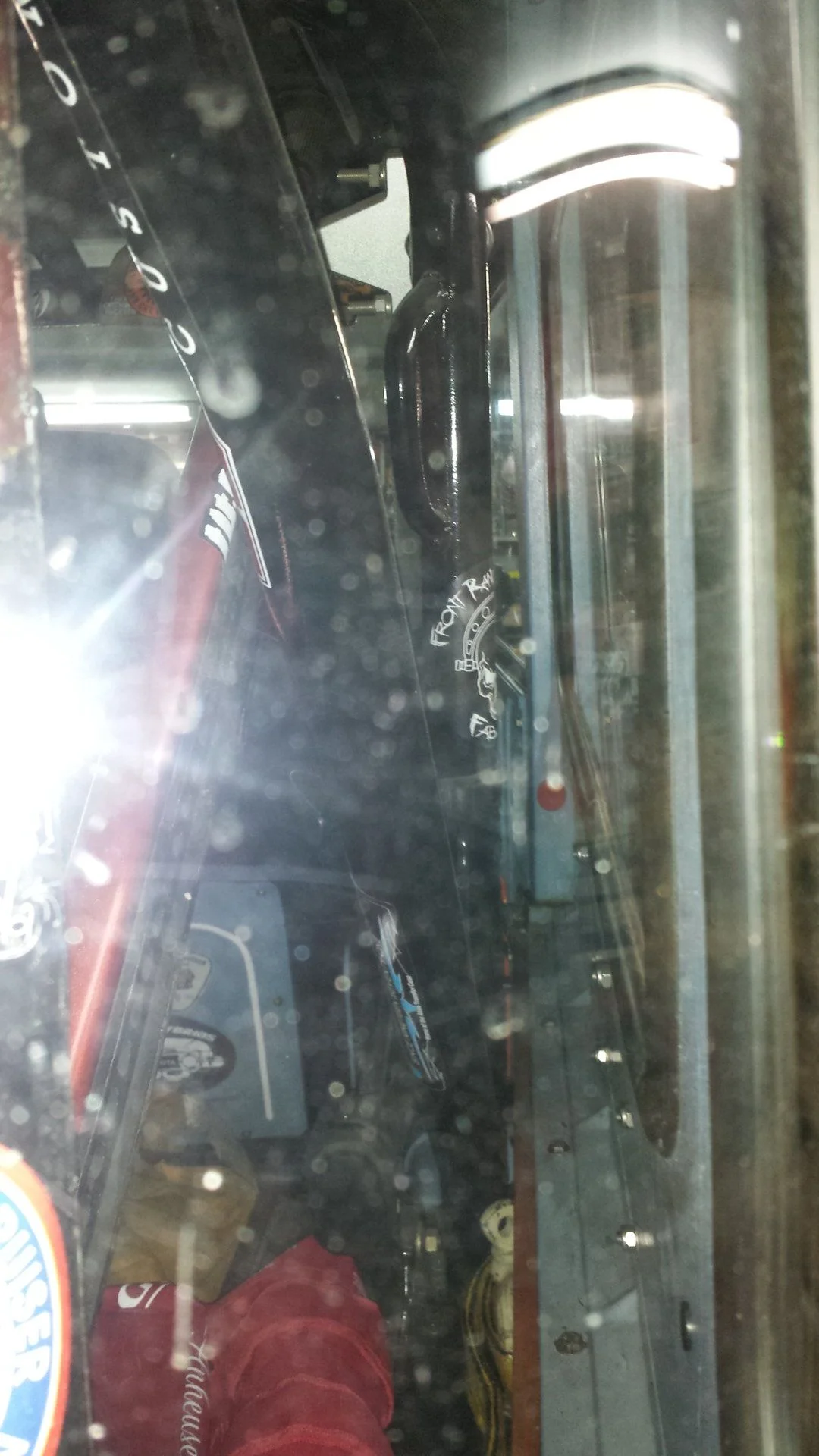

Oh man, I never really noticed how close that latch comes to the roll bar. I've got about 1/4" on one side and 3/8" on the other. We built up the cage with the roof at a different location, so I guess we lucked out getting it in there straight!

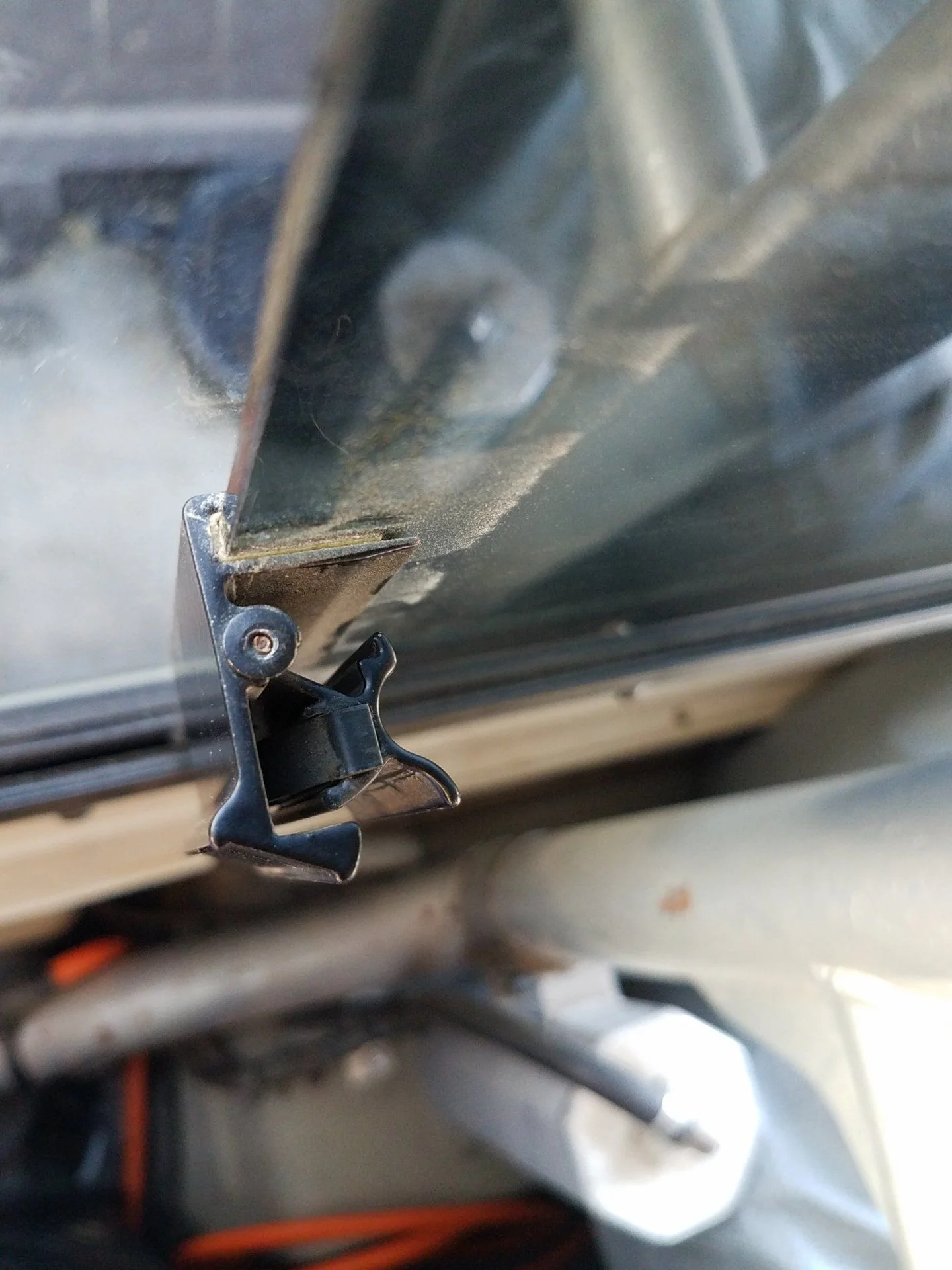

In a real pinch it looks like you might be able to trim the latch back maybe 1/4" while keeping it functional, but that would be a last resort type thing. On mine, if the latches were to hit the cage, the windows would slide open 4 1/2" before they stopped dead. This amount would depend on where the "B" hoop of the cage had been mounted though.

The first pic is what you would get if the latch hit the roll cage.

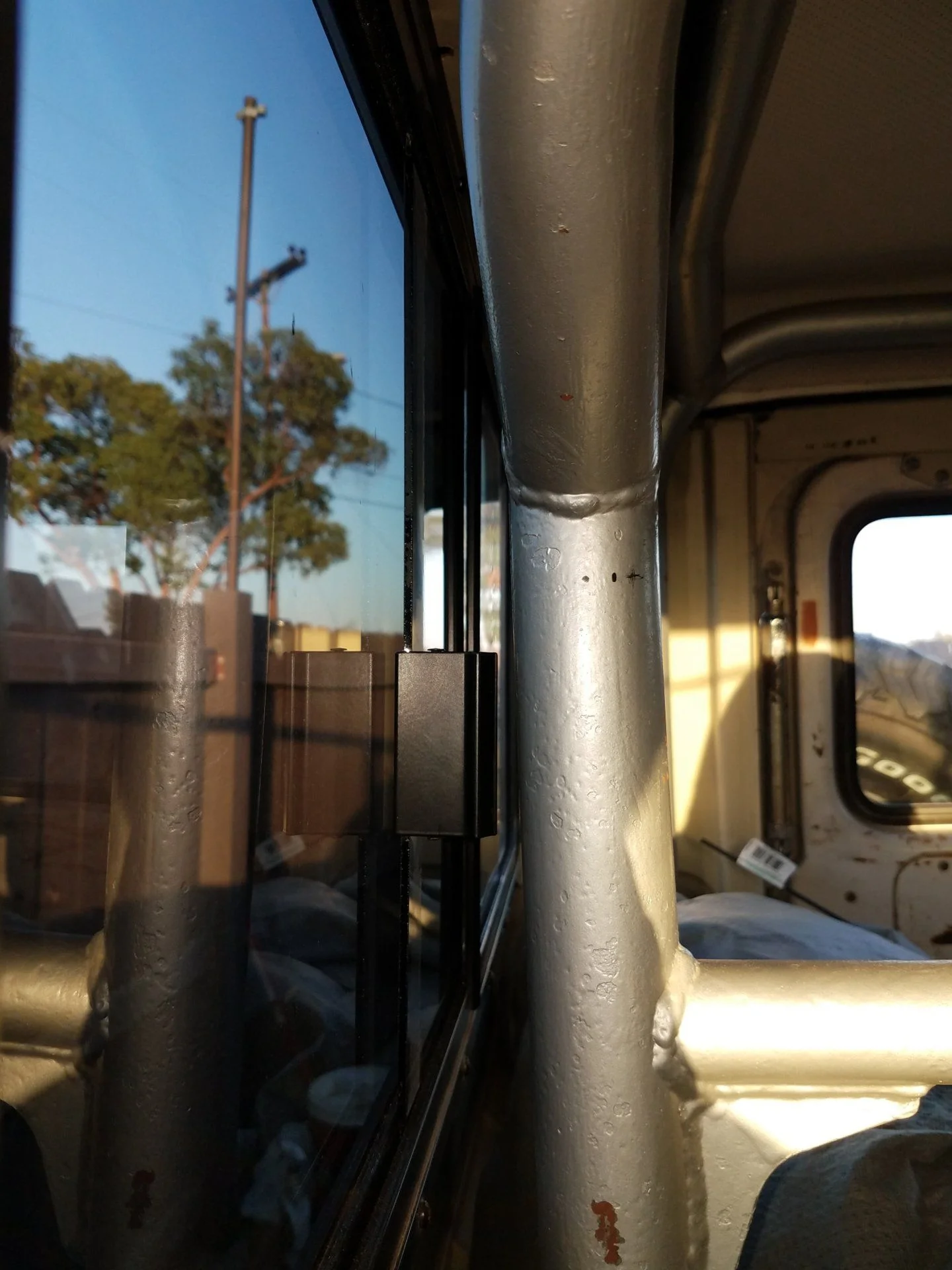

Second is the clearance between the latch and the cage.
Third is looking down at the latch to see how much could be trimmed off if required.
