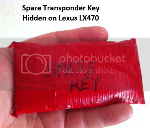

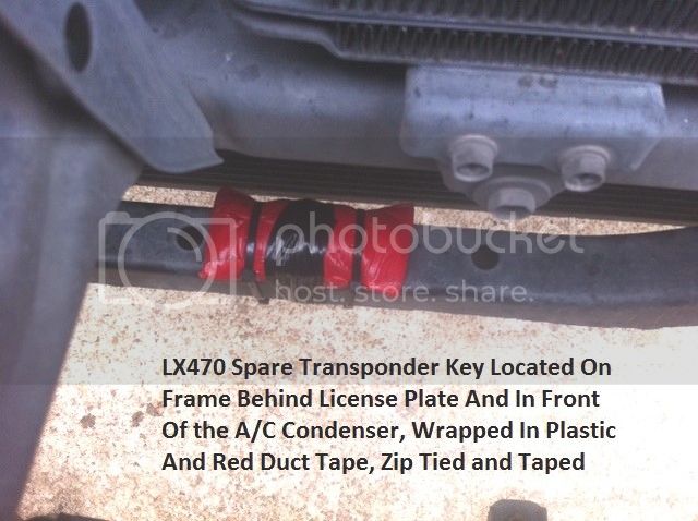

I have a spare transponder key triple wrapped in plastic bags (with dessicant) and covered in tape, mounted to a spot on the upper framework of the vehicle, (but accessible)....just in case.
There are dozens of places to safely hide a key. The spot I chose is very easy to get to and where I live....there is ZERO chance anyone is going to see it and steal the vehicle. You might choose a more inconspicuous location.
Thanks for the advice. I like triple wrap plastic bag and duct tape!
