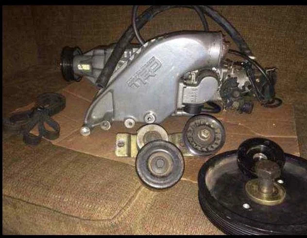

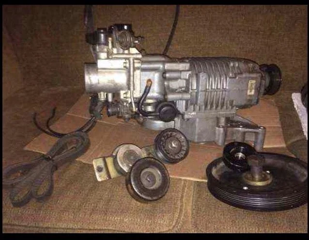

Got it, thanks for the info.. I'm still considering options. I found a brand new in its box TRD SC for about $4500 and a used one for $1500. But then I see the TC options
Sent from my iPhone
Grab it. Get the used one, and you can rebuild it if you need to.
Sent from my iPhone
Well, I'm in the process of dropping my pulley size and going for some meth... all in the name of optimizing the truck's performance out here in NV...
please let me know what it takes to take off the stock pulley? is it pressed on the housing? I for the life of me cannot find a socket to fit over the nut to remove the pulley? if you can take a pic of the socket you used it would be appreciated. I think I might need to go buy a multipoint???
I think that used one has been floating around for a while because there are so many little parts, hoses and spacers that it's almost impossible to know what you are missing until you dive into it.
