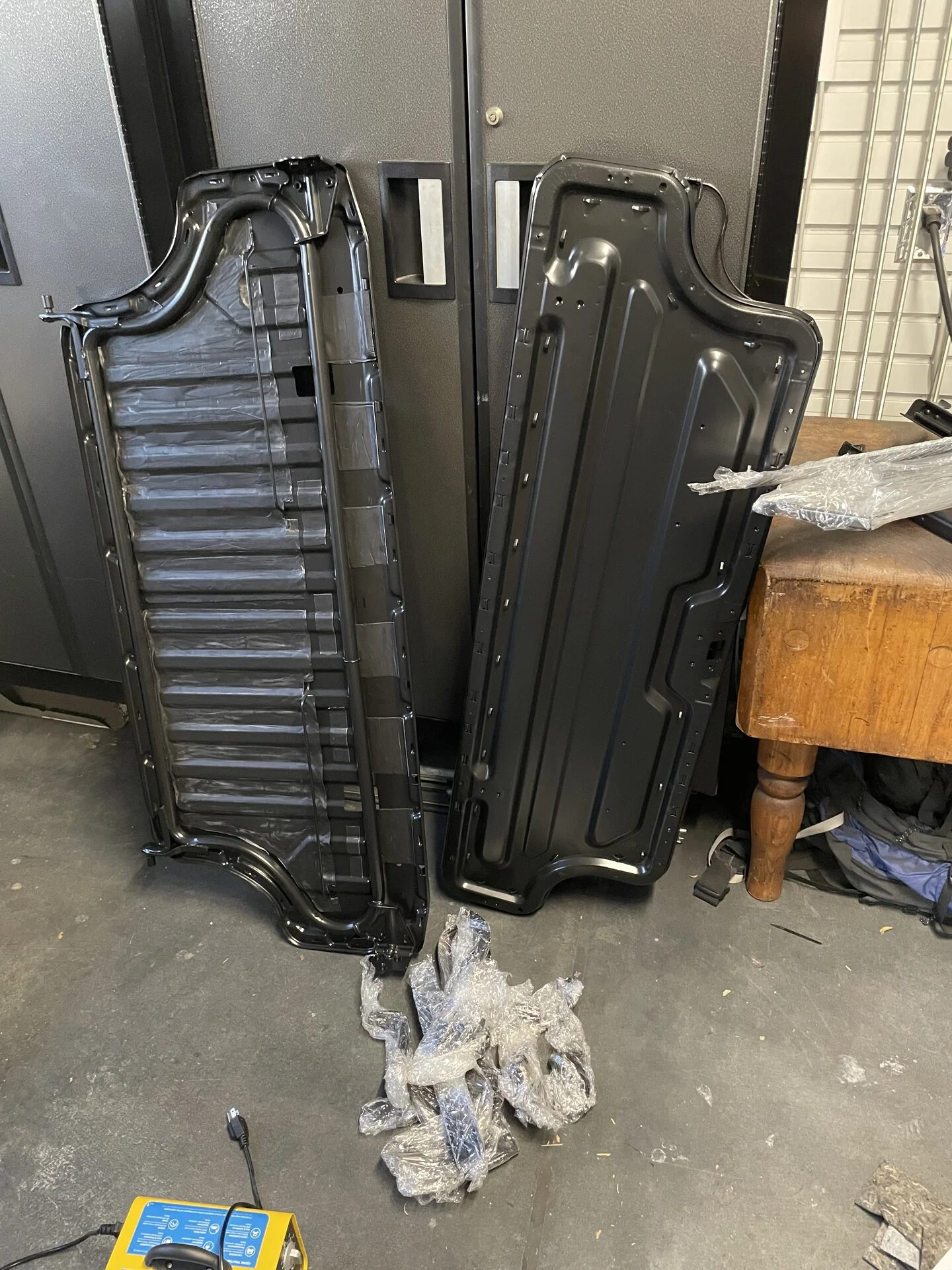

The rear seat powder coated with some sound deadening material.

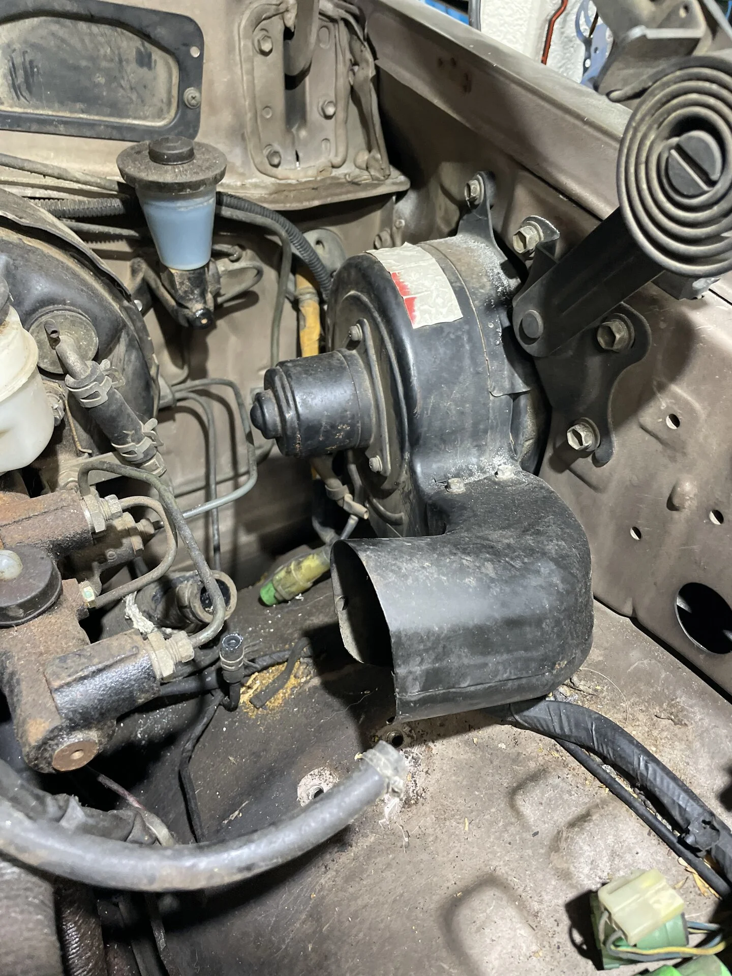

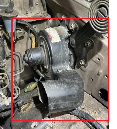

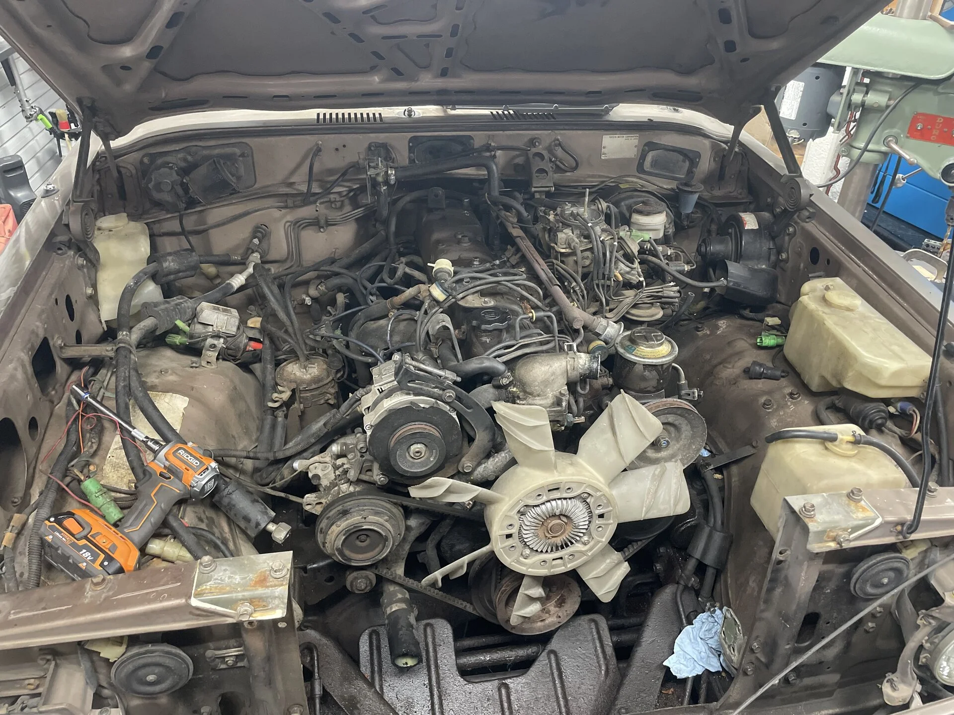

Is this a blower fan? I've never seen one mounted here..
Left hand drive 2F motor thing. Carb cooling fan. Maybe US-spec only, but I'm not sure. You know the side vents we have on our trucks on the front fenders (in front of the front doors)? Where your "G" badges usually are on Australia. It sucks air in from there and blows it on the carb after you turn the motor off. Prevents vapor lock so you don't have issues restarting the truck when the engine is hot.
Fascinating.. thank you.

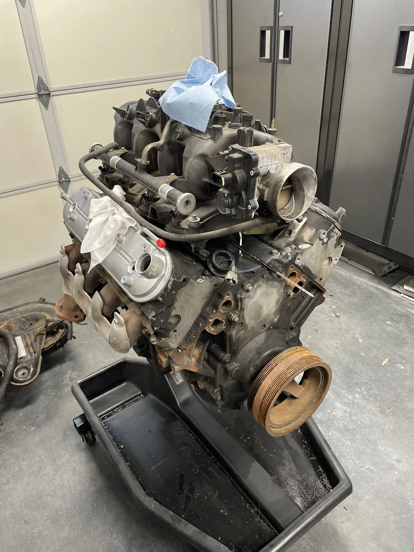

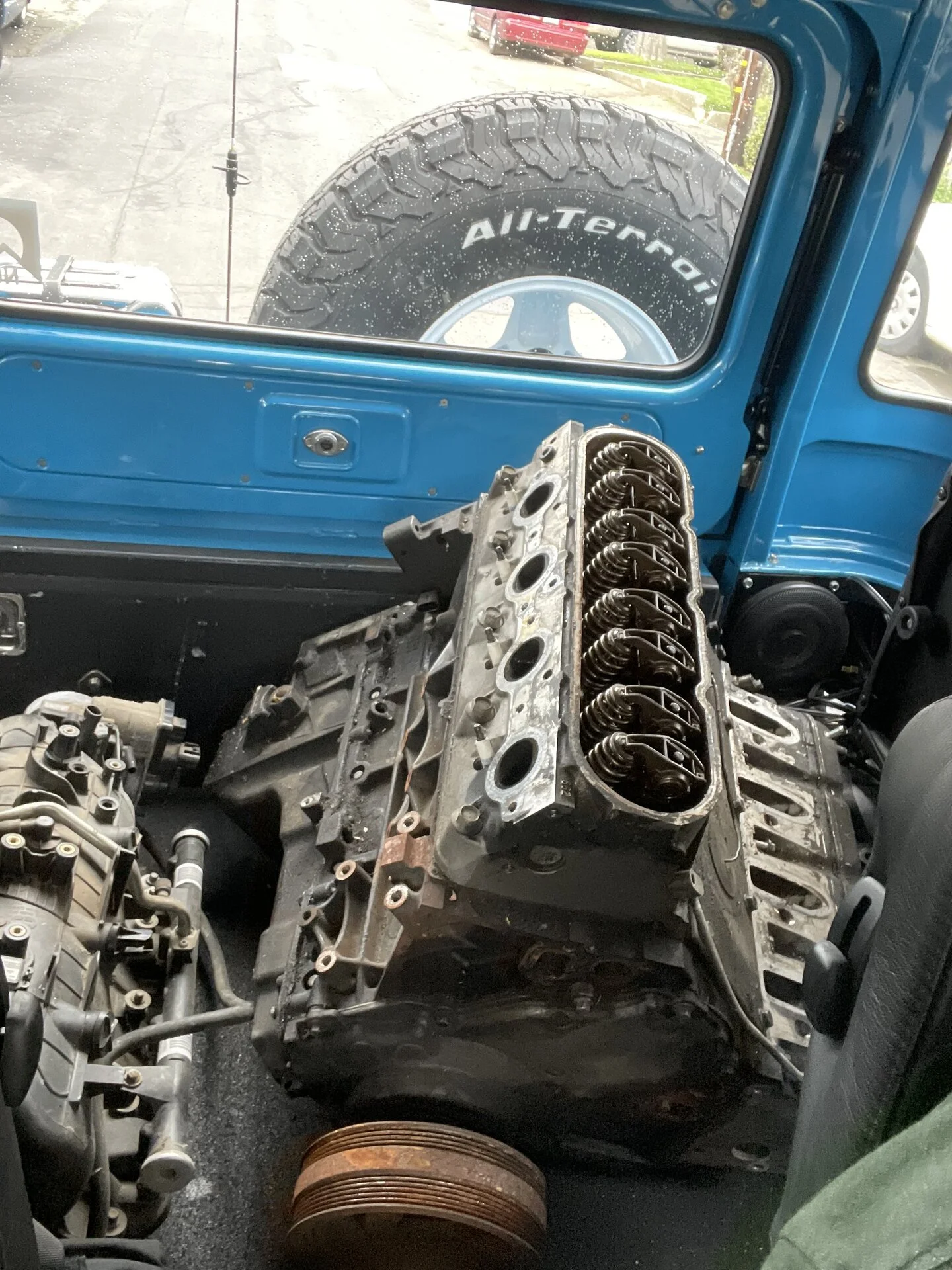

Picked up a 5.3 - I gave up saving for a erod. I am just going to register it in a non Cali state. The block fit nicely in the 40.

Almost have the assesories figured out. I have a few more tensioners and waiting on Camaro PS pump. Once that’s complete i am going to tear the block down and get it to machine shop. More to come.
What is there to figure out? Why not just run the truck drive that has been shown to work perfectly countless times?
