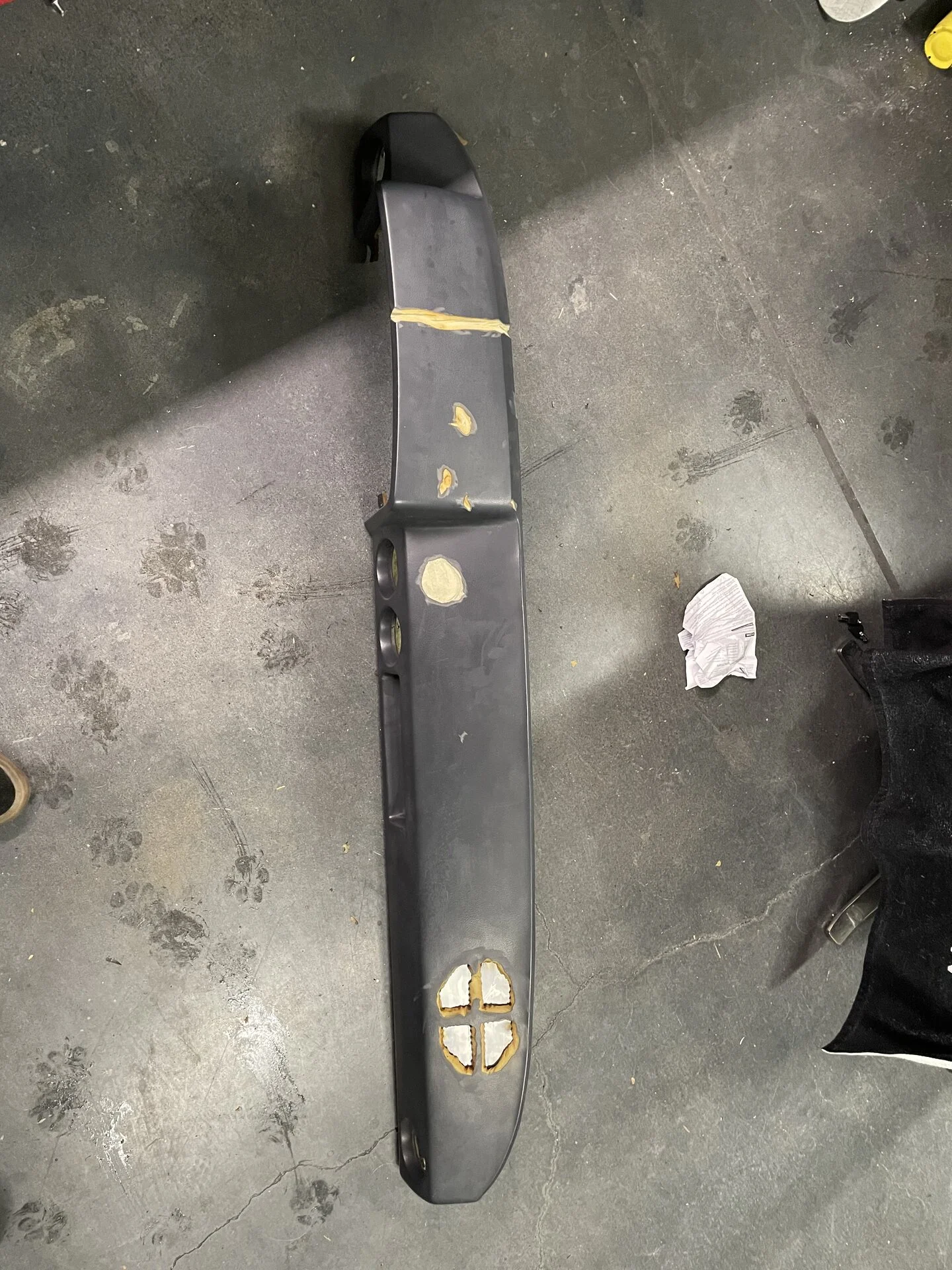

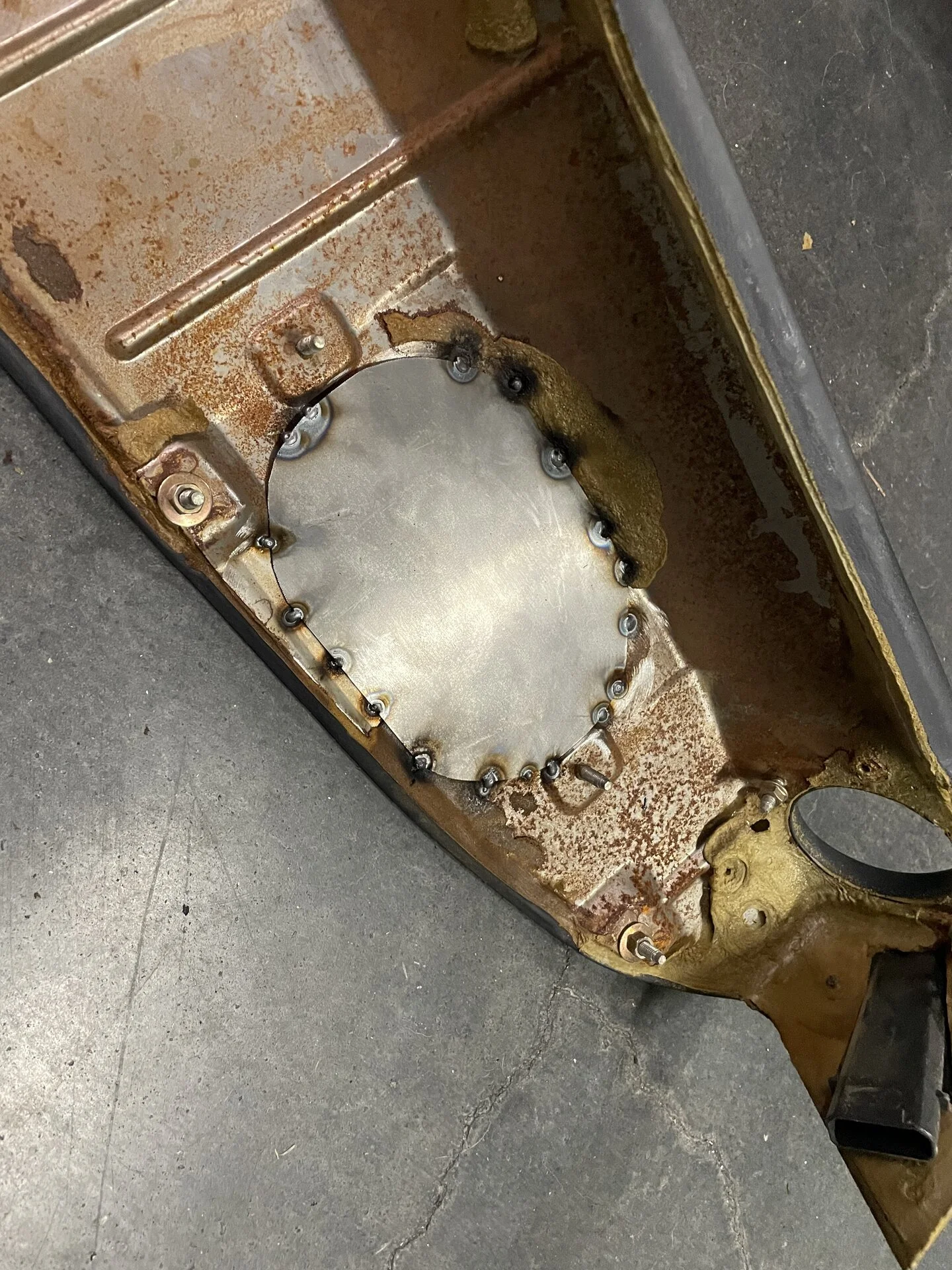

This weekend I Took out the dash And Cleaned out all the dust and crap. I deleted the vent in the dash(let me know if that’s a bad idea)
Tomorrow I am going to body fill all the areas where i removed the foam with fiberglass body filler. I think if i get the dash right. The project will feel like it’s moving.
I will be wrapping the dash in a matching leather to my seats.
I keep tackling small projects. For some reason I keep coming back to the interior. (I am avoiding metal work)

:rofl:"avoiding metal work" as he burns a patch into the dash:hillbilly:
