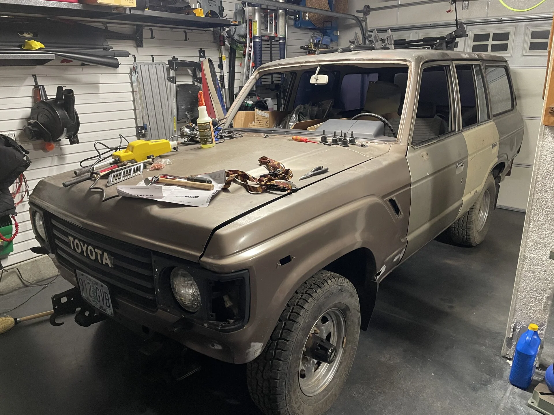

Well i just bought a fj60 from Medford oregon. It will be on its way down to my garage to sit for a while. I am excited to get it assembled and driving asap so i have a daily driver around town. My plan is the get the rust taken care of install the windshield and make it driveable. I want to drive it and enjoy it for a while before i change anything.
I am a long time fj40 owner and i may sell the 40 to run this project.
Hopefully i can get it operational by the summer.
