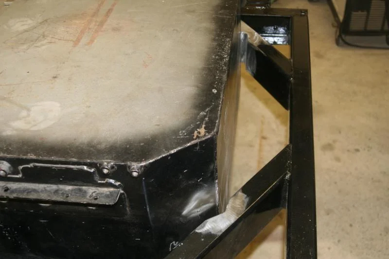

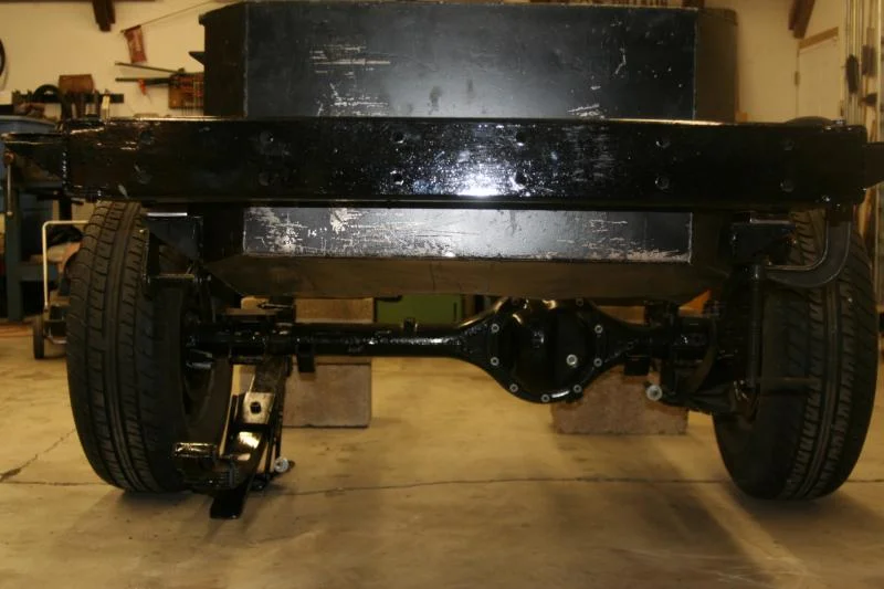

I got the tank semi bolted in, need to boil it out and paint. Told you it was big. I'll have to make a skid plate for it as well, but I'm still not following Pighead. :)

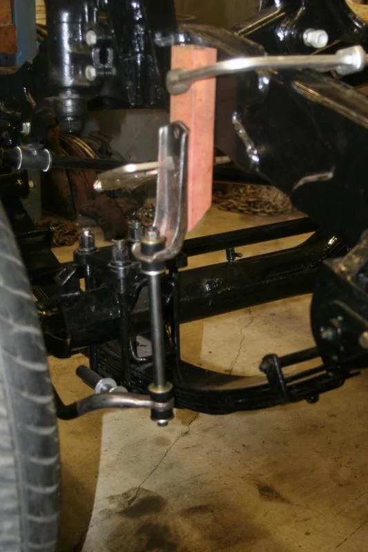

Question on my new sway bar links. Set it up with Georg's extended links, but it's still way too short. Should I wait until the motor and body are back on, so there's more weight on the springs, before I make new mounts. I'm thinking it will squat down some.
What sway bar did you use for the front
Gonzo,
That's a 62 sway bar, it's alittle thicker in Dia. than a 60 bar. Something I just learned. I have a 60 set and a 62, both the same shape, 62's just beefier.

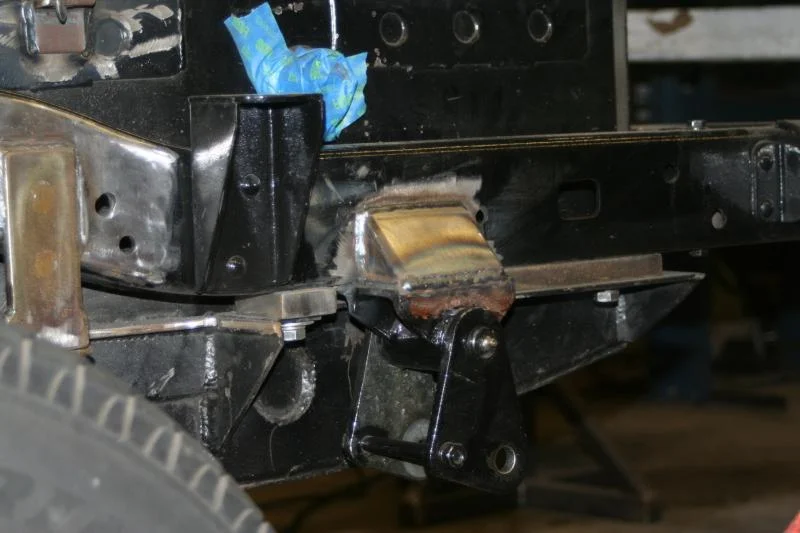

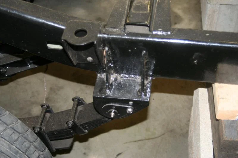

Ever since I brought the 55 home, I didn't like the welds on the spring mount supports. I good friend of mine, threw me over the edge when he pointed them out to me. So, today I cut one side off and made my own. I don't know if they are any better, but at least I can say I'm the guy who messed them up.
First picture are the old ones, then what I came up with.

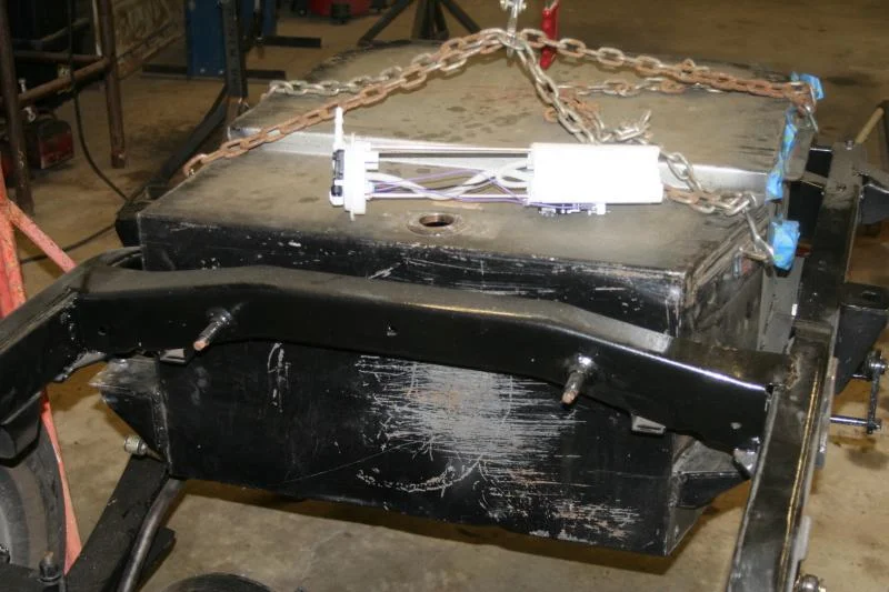

My fuel pump arrived late today, so thought I'd show you what I'm going to do. I got the idea from a friend of mine, Rover67, up in the 60 forum. Here's a link to what he did, with his long range tank. https://forum.ih8mud.com/60-series-wagons/394565-tank-fuel-pump-conversion.html. I thought it was a great idea and easy enough. The pump is from a 2002 silverado and will work good with my setup. It's 15 1/4 inches long and my tank is 16 inches deep, so I'm still debating on what to do or not do.
I could lengthen the rods another inch or french in the top, so it drops down an inch or just leave it alone and not use the 3/4 inch of fuel. I'm still waiting on the mounting plate from Vetteworks, then I'll cut the hole in the tank.
Anyway, I'd like to thank, Rover67 for posting a neat and easy solution to a fuel pump problem. Here's the pump
