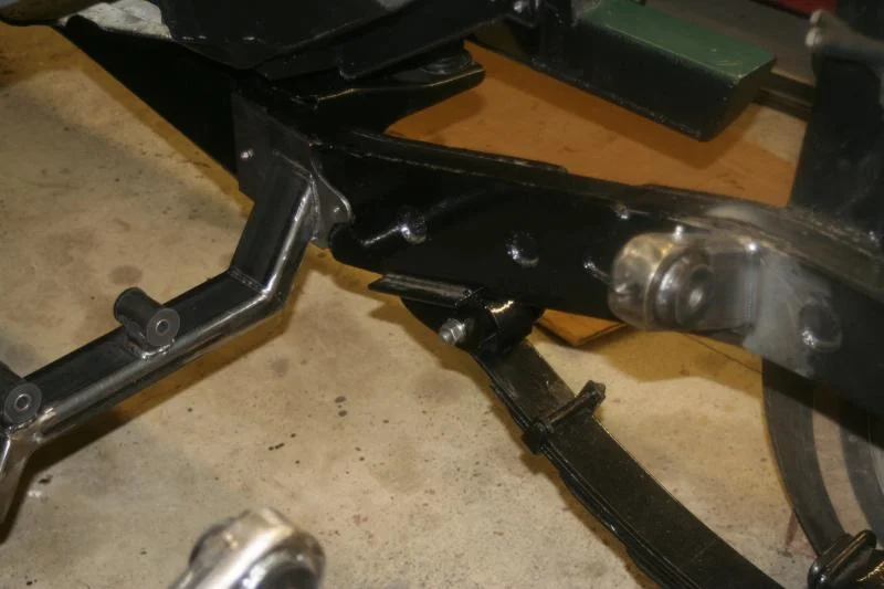

It's been one of those weeks. I am totally over thinking the transmission mount. I spent the week laying under the wagon, trying to come up with a mount, that will work. I admire the guys, who whip one up in an evening, but that ain't me. Everything I came up with, either interfered with the front u-joint or make running the exhaust, a problem. So this is where I'm at, almost done. After this, I'm buying a tubing bender.

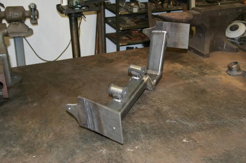

Here's my first two fabrication efforts at a trans crossmember.
ry%3D400
Sure, it'll be easy, I'll just attach this to the original mounting points, put a plate on there for the transmission mount...voila! :whoops: I guess there's a little offset. That's OK, just bend this piece that way and reweld these bushing pieces on, and...:doh: that doesn't line up either...:bang:
I think I posted up somewhere that I'll be reverting to the original and clearance-ing where I need to for bolts, etc. HA.

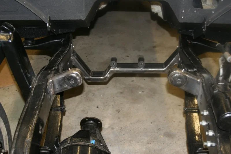

Where to start? I just spent over two weeks, trying to come up with my rear crossmember. In my own defence, everything was against me :). I had a fish plate end, right where I needed a plate and the frame curved right at the same spot. not to mention the body mount in the way, with one of those square holes in the frame thrown in the mix. What else, the front driveshaft, the PTO shaft and where to go with the exhaust pipes? :eek:
Anyway, I'm not done with the mount holes and the frame needs to be sleeved with DOM tubing, but you get the picture.

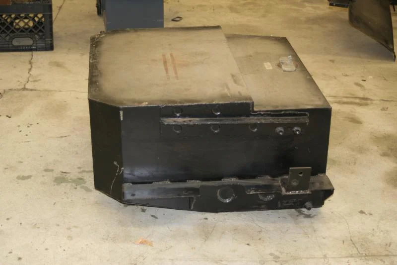

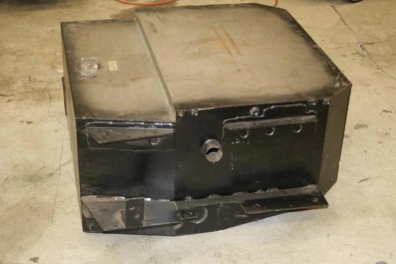

Next up, try to mount this big ass tank, in the frame. It's got two other sets of mounting brackets, welded to it. I'll cut them off and see what I can come up with.

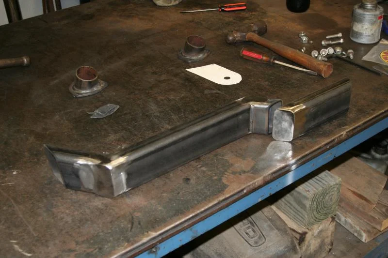

That is the plan, for now. I want to make another similar crossmember for the backside and then skin with plate. it's not going to be a light weight model.
I got the motor pulled today and I want to be the first to say, it wasn't easy. These type mounts are great, but you have to really work at getting it to clear everything.
I had to remove the headers and starter, just to get the bellhousing over the front mounts.
Welded up the front mounts and started drilling and welding the DOM tubing for the rear mounts. I think it might work.
I've got some body off work on the frame, so I'll drop the motor back in when the body is off. Make it alot easier to line up.
When I get the driveshafts made and installed, I can see if the rear mount can be cut down alittle, so it doesn't hang down so low. Try to get some more ground clearance.
