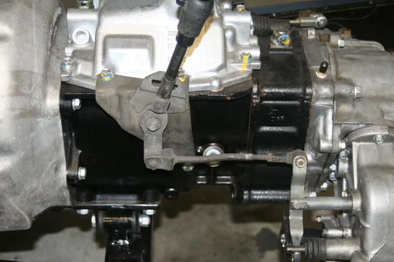

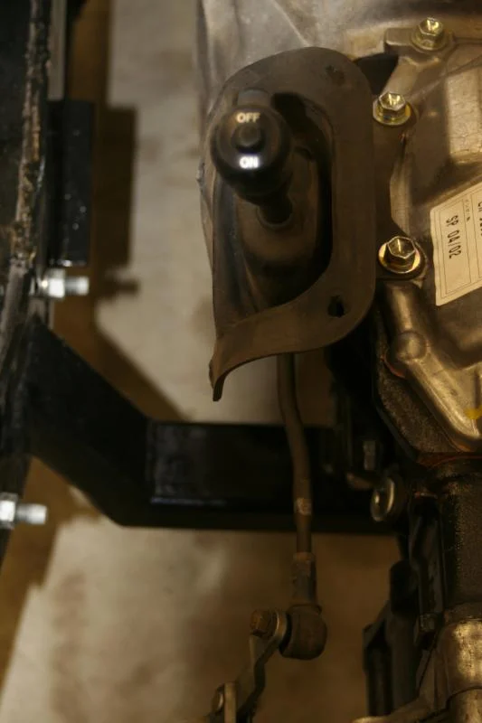

I found a PTO shifter in my pile of parts, that I didn't even know I had. Not sure what it came out of, but it bolted up to the H55 and works great. It has a button lock on top, pretty neat.
Everything will have to be rebuilt, but shouldn't be too bad of a job.

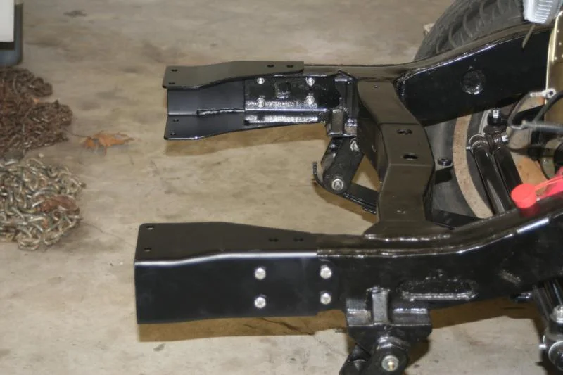

Bolted on the frame extentions, just for fun.
Picture of the elusive pillow block support bracket.
More work to do! Needs to be done, before I put the body back on.

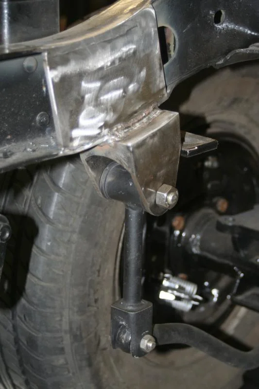

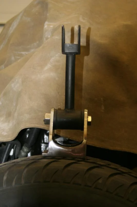

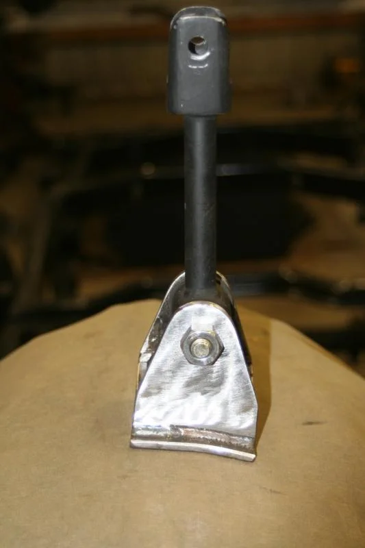

The winch will have to wait for now. My bushings for the rear sway bar came in, so I welded them up and have to drop the fuel tank another time.

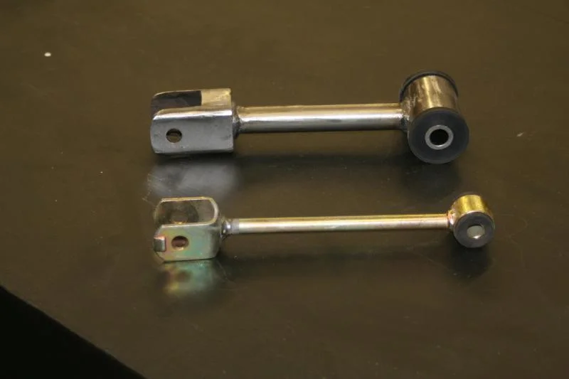

I bought a set of extended links from SOR and before I could make some mounts, the link fell apart. No weld penetration. I made my own, alittle stronger anyway. I think they will work .

Nothing real exciting, just the sway bar mount welded in.
There's so many things, you don't think of, that come back and bite you. Between the tank, swaybar, shocks, etc. :bang: I thought I was done with the frame three times now. I need to get this done and move on to the winch.

Great looking fab work.
