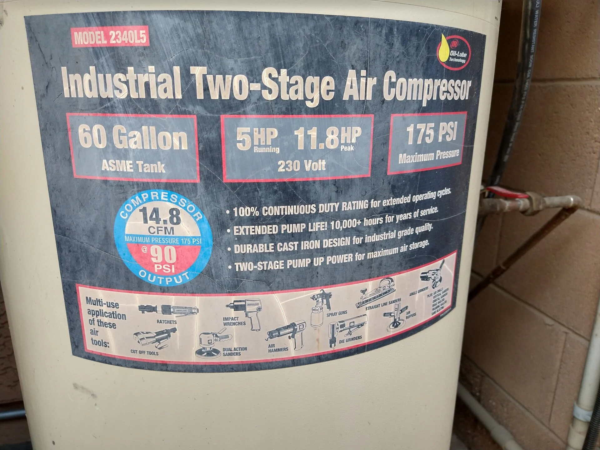

My Ingersoll Rand Model 2340L5 14.8 CFM @ 90 PSI that I bought back in the late 90's has served me well. I just barely put new caps in the motor and I think one belt over the years. Advertised as 100% duty cycle. Made in U.S.A. back then but I don't know if they still are.
Tractor Supply near me sells IR compressors but I haven't really checked them out closely.
The modern made IR compressors don’t get good reviews from what I can see. I think they’re on par with the DeWalt I have. I do see an old school T30 come up for sale from time to time and those seem like good buys!
