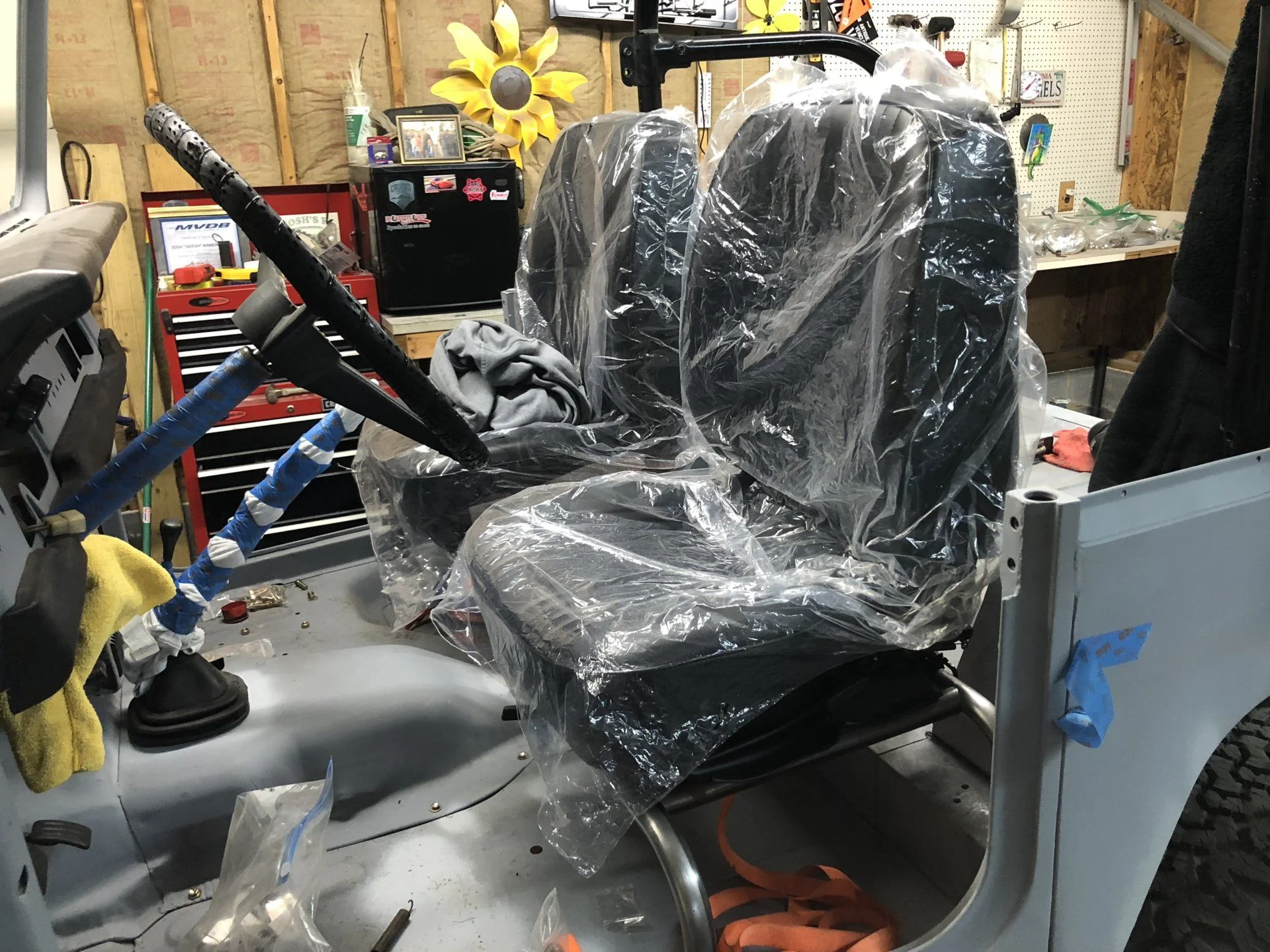

Here is a picture of the seat to brake pedal 19 inches, the seat is all the way back but it's hitting the bracket for my seat belt it will go back a few more inches with the bracket moved.
If that is the shoulder harness in the photo, the driver of that rig is going to crush their spine in a rollover. The shoulder harness should be on a crossbar at shoulder level or slightly above to avoid spine compression in a roll.
Just an FYI.

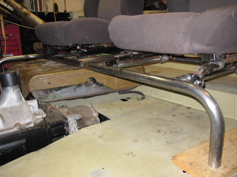

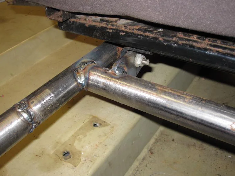

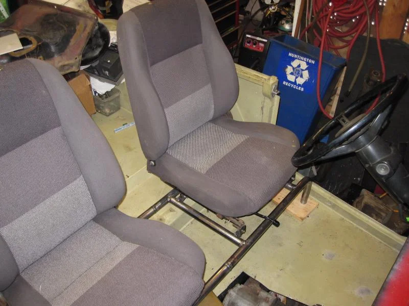

Finally got the frame tack welded and the seat tabs and seats tacked in place... SWEET!
This is with an Aqualu aluminum tub by the way... frame feet will be added later to fine tune seat height. I might want to remove & shorten the extension that goes forward over the gas tank so it stays closer to the front of the tank cover... right now it is about 2" forward of the cover when it hits the floor..
