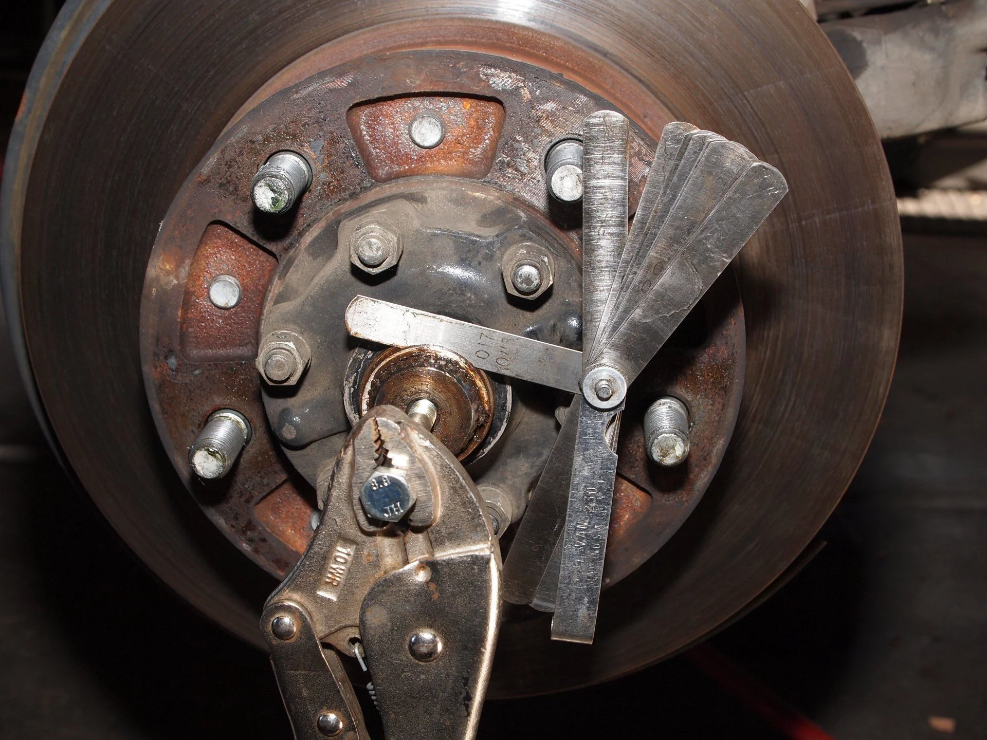

I finished up yesterday once I was able to get the last 2.6mm snap ring in the state of Colorado.
Once I installed it and measured snap ring to hub flange gaps with my "puller set-up" on to insure very tight & true reading, I torqued on the calipers bolts to 90ft-lbf, brake line braket 24ft-lbf, speed sensor wire to 9ft-lbf & speed sensor to 71in-lbf on. Then mounted wheels & tires, replacing those PITA wheel locks with standard lugs torqued to 97ft-lbf.

Thanks for the picture & tip. I happened to pre-order two snap rings guessing (wrongly) at size, before doing my tear down gap check pictured. So I end up waiting until final assemble before picking up the 2.6mm. I buy most stuff at a Local near by Dealer. I've had a relation with them for 14 years, and returns are easy. If I boughtfull packs I'd have about 2 dozen snap rings lying around from just last year, that would most likely never get used. I've found 2.4mm & 2.6mm is what I most often use above 150K miles, once did I used a 2.8mm.
Tear down pre gap check pic (again). The factory standard 2.2 was on which they actually measure 2.16mm:

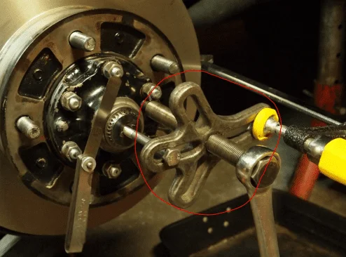

What is that tool that I circle in read? Look like something really useful to have in my tool box. I have looked around at local parts store, have not seen anything that would do this.
It's just a standard puller been lying around my tool box. But could be 30 or 50 years old. I've no idea where you can get one.

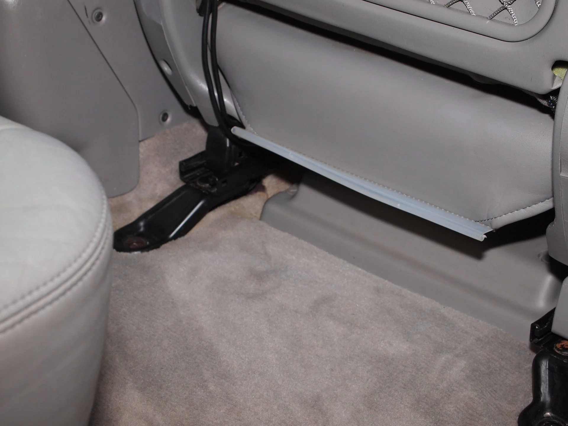

Pulled seats to remove headrest, clean under and reattach bottom seat rear flaps. These flaps, as I call them, were apparently pulled loose during headrest install.
Pictures really help me out. Looks like I need to work PS a bit more to full secure.
Where DS look perfectly secured.

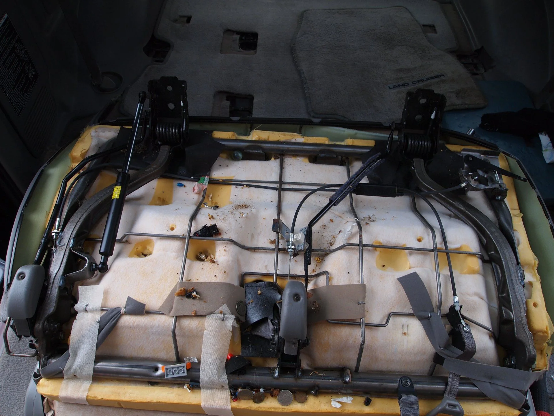

Some lite second row bench seat work, cleaning out the marbles & smelly's.
