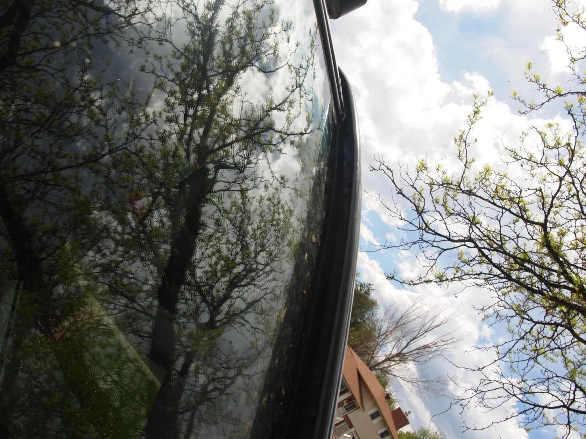

  3. Windshield side molding leaks. (a replacement windshield)

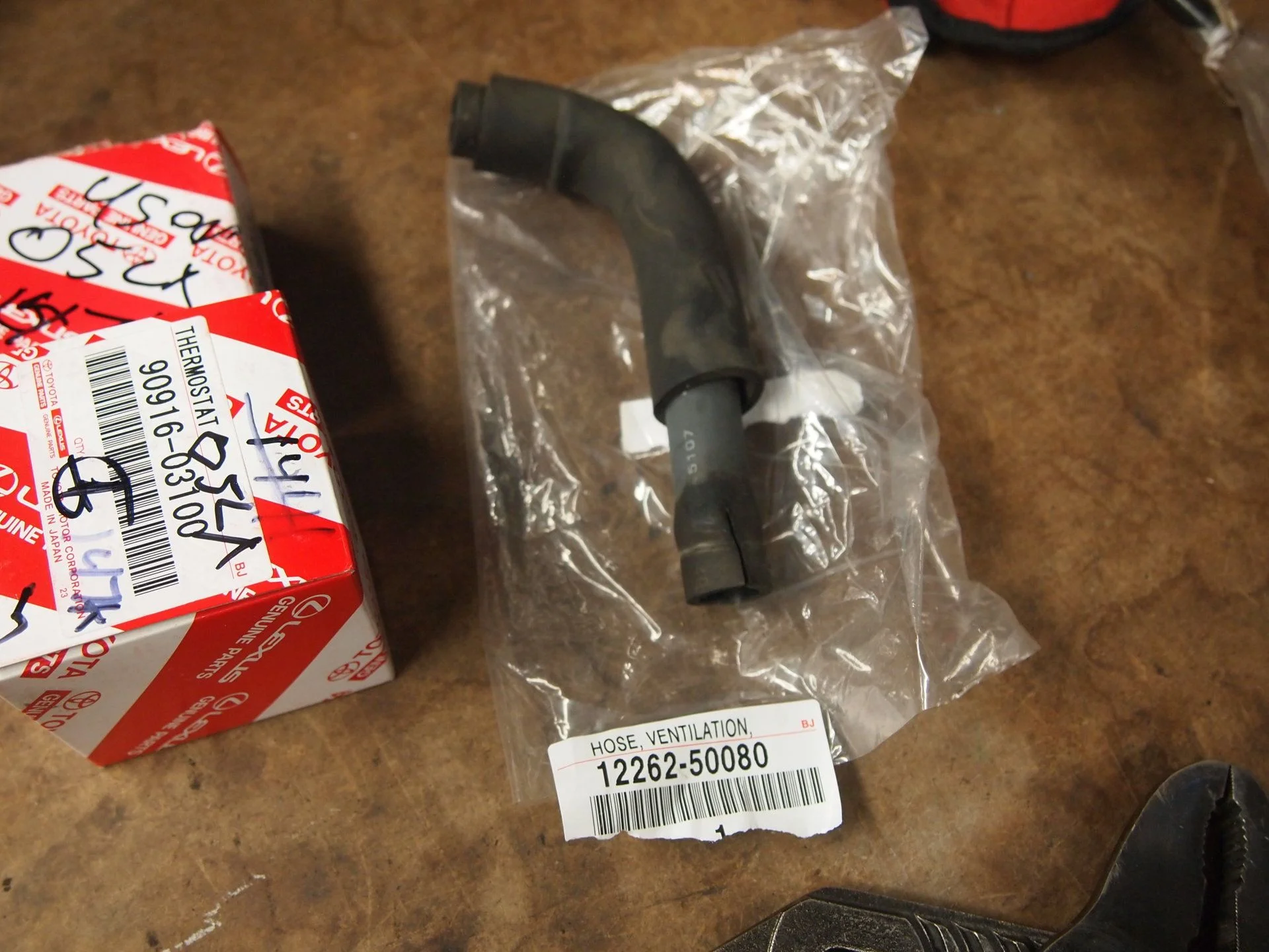

I took a peak under front end I noticed both steering rack boots wet (leak) and FDS boot weep (leak). So I popped the hood to look around. OH NO more leaks!
Here's what I found:

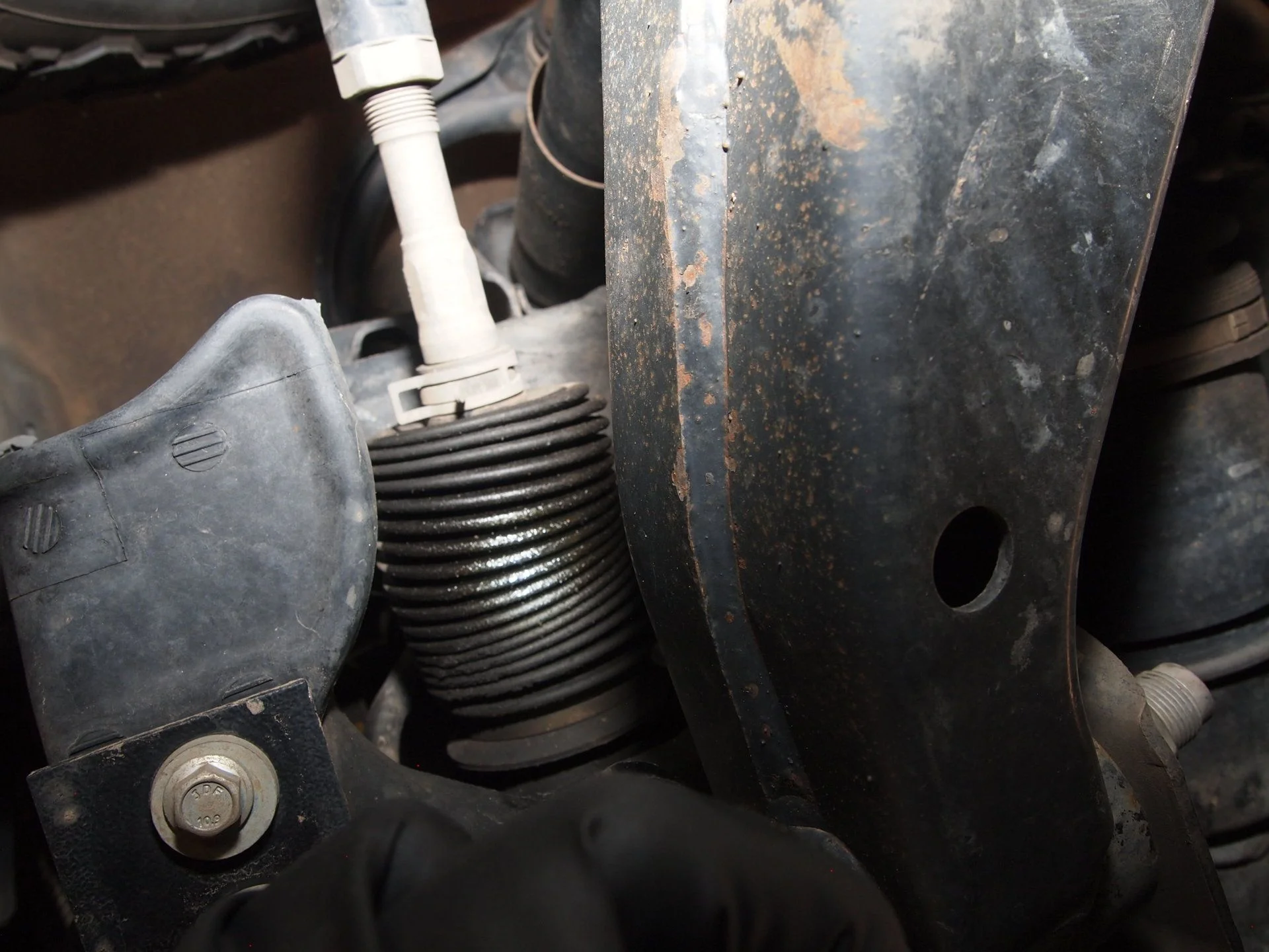

  1. Rack & pinion leak at output shaft seals into boots (Reservoir low, but to dirty to really see how low)
  2. Radaitor leak. Rad low by ~2 qts and reservoir empty ~1 qt more. Thats 3 qts plus low, NOT GOOD. Cracks front side of radiator plastic top at two points.

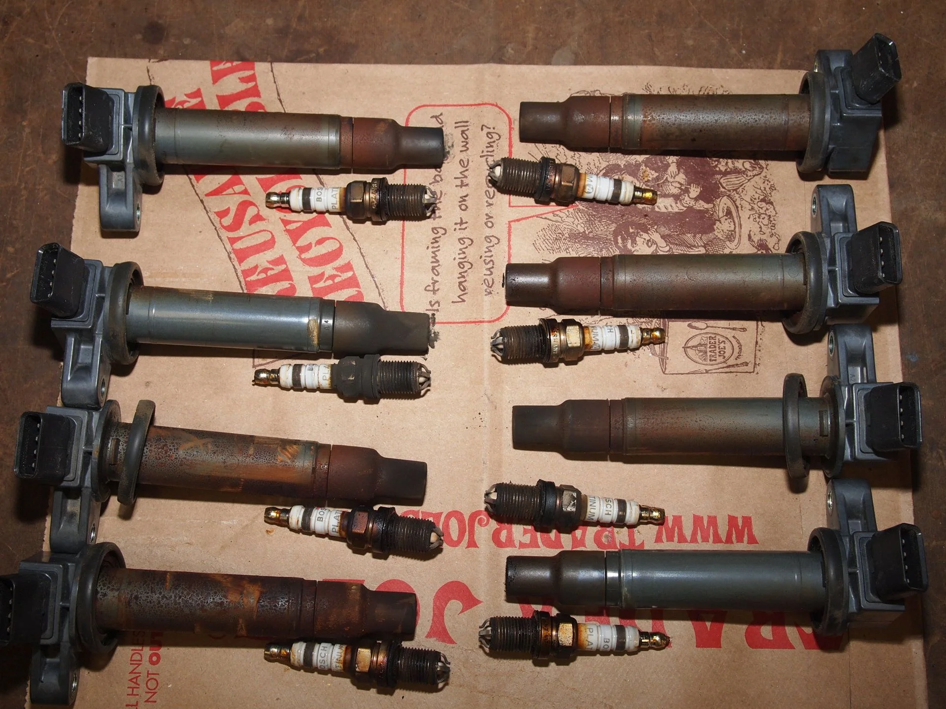

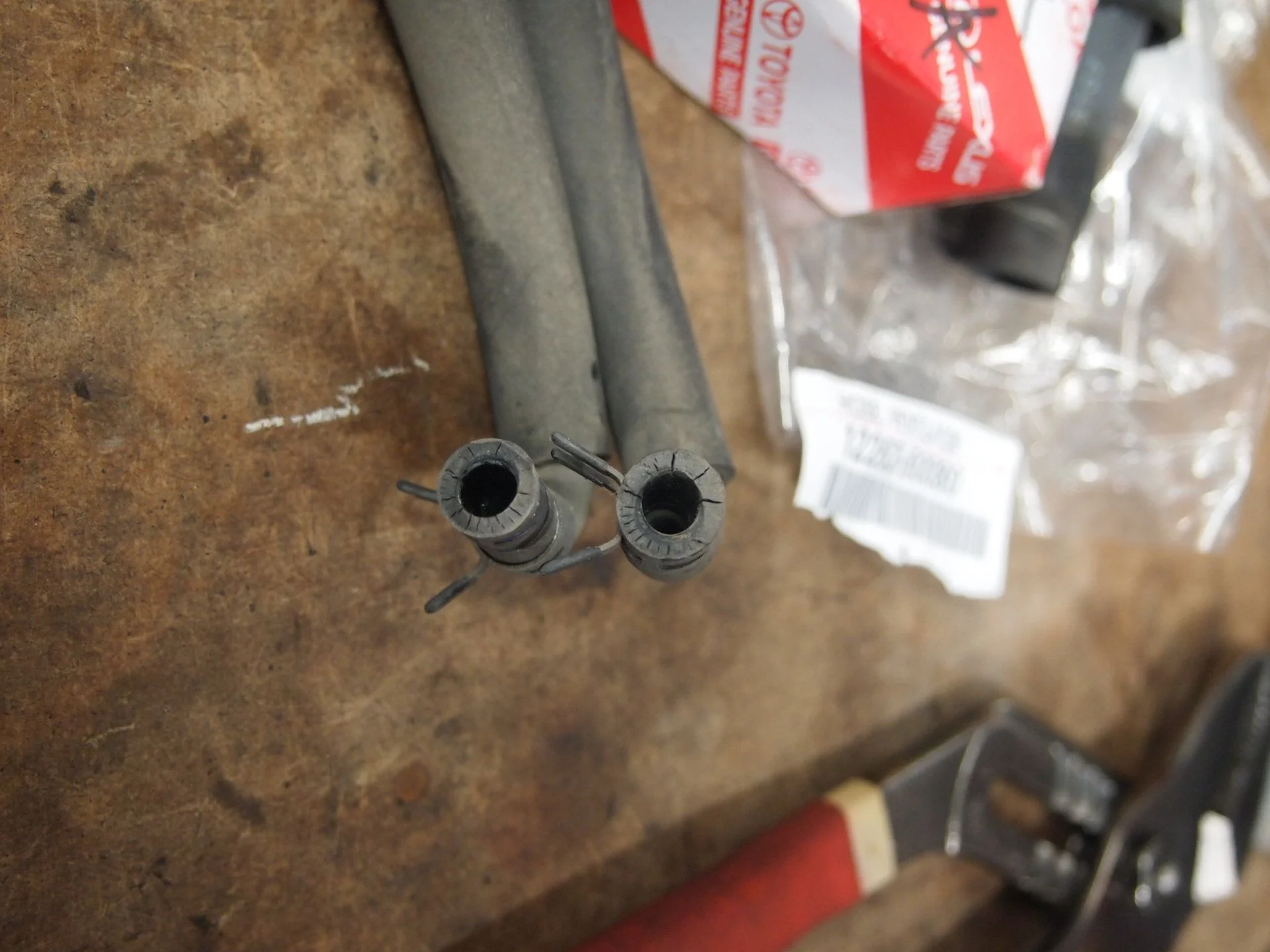

  3. Combustion gas leak (spark plugs walking out)
  4. Vacuum leaks, MANY. Oddly long term fuel trims (LT FT) -20%, expected positive with vacuum leaks:hmm:

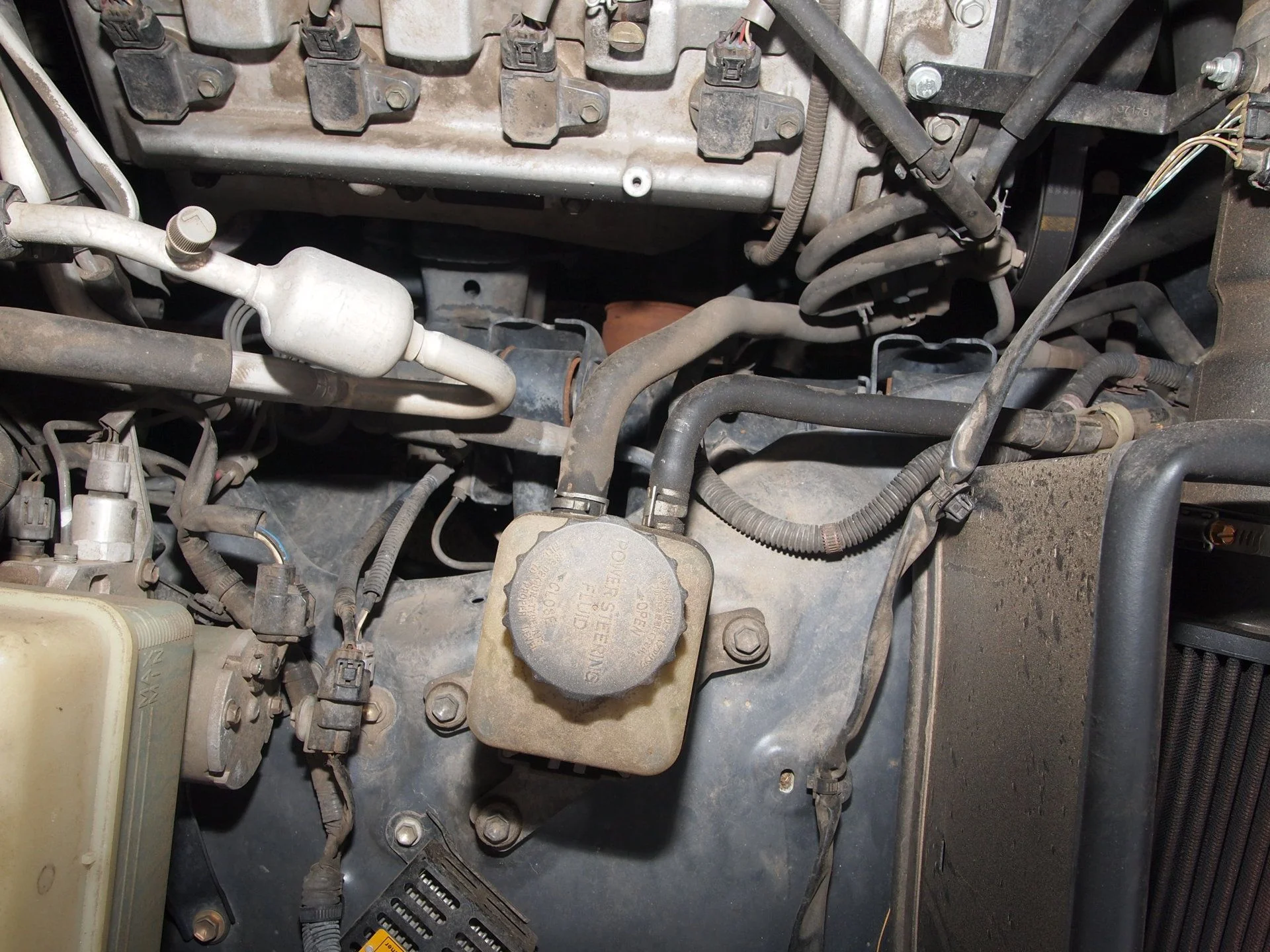

  1. K&N air box, tube and filter. Bad idea. This changes air flow and air filter is way to exposed the environment. It will get wet while driving in the rain. This will reduce air flow. MAF sensor was on of the dirties I've cleaned.
  2. Vacuum lines modified to adapt to K&N air tube, loose and poorly secured.

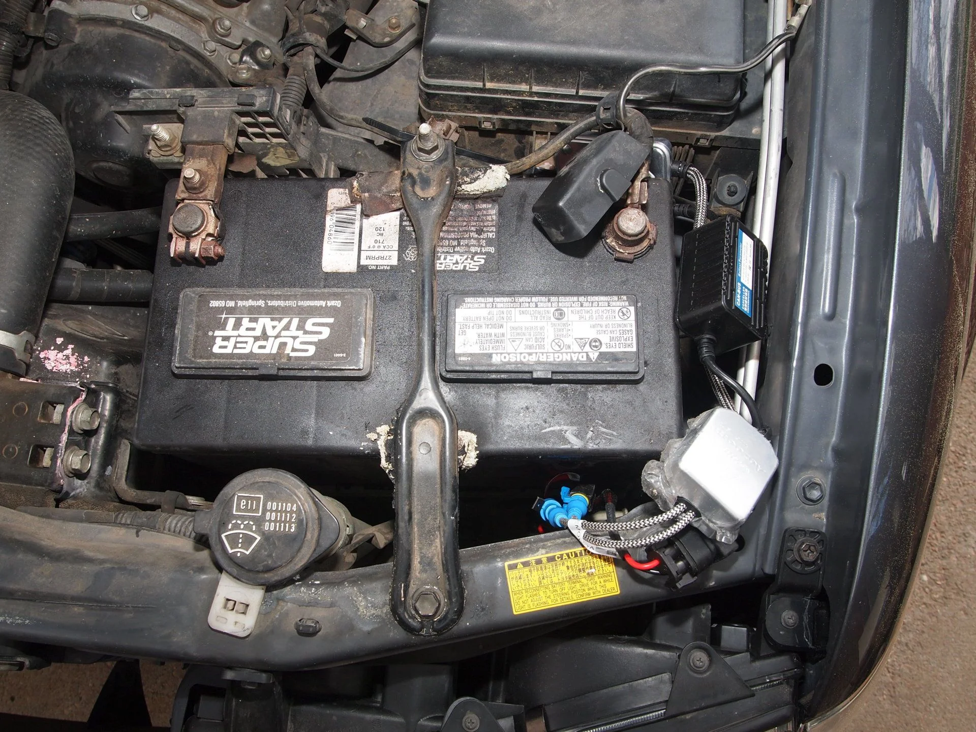

  6. Battery acid leaking down side of battery. Normal, not a leak, but never neutralized and cleaned. Damaging
  7. Battery tie down way to tight.

# 3 plug ready to blow out of head. Likely take head plug threads with it! All plugs loose and leaking combustion gases staining and cooking coils
1983590
So close to a very expensive repair. Talk about just in time luck. The silver-lining the interior leak.

Tel-tell signs Toyota "pink crusty"
1983591

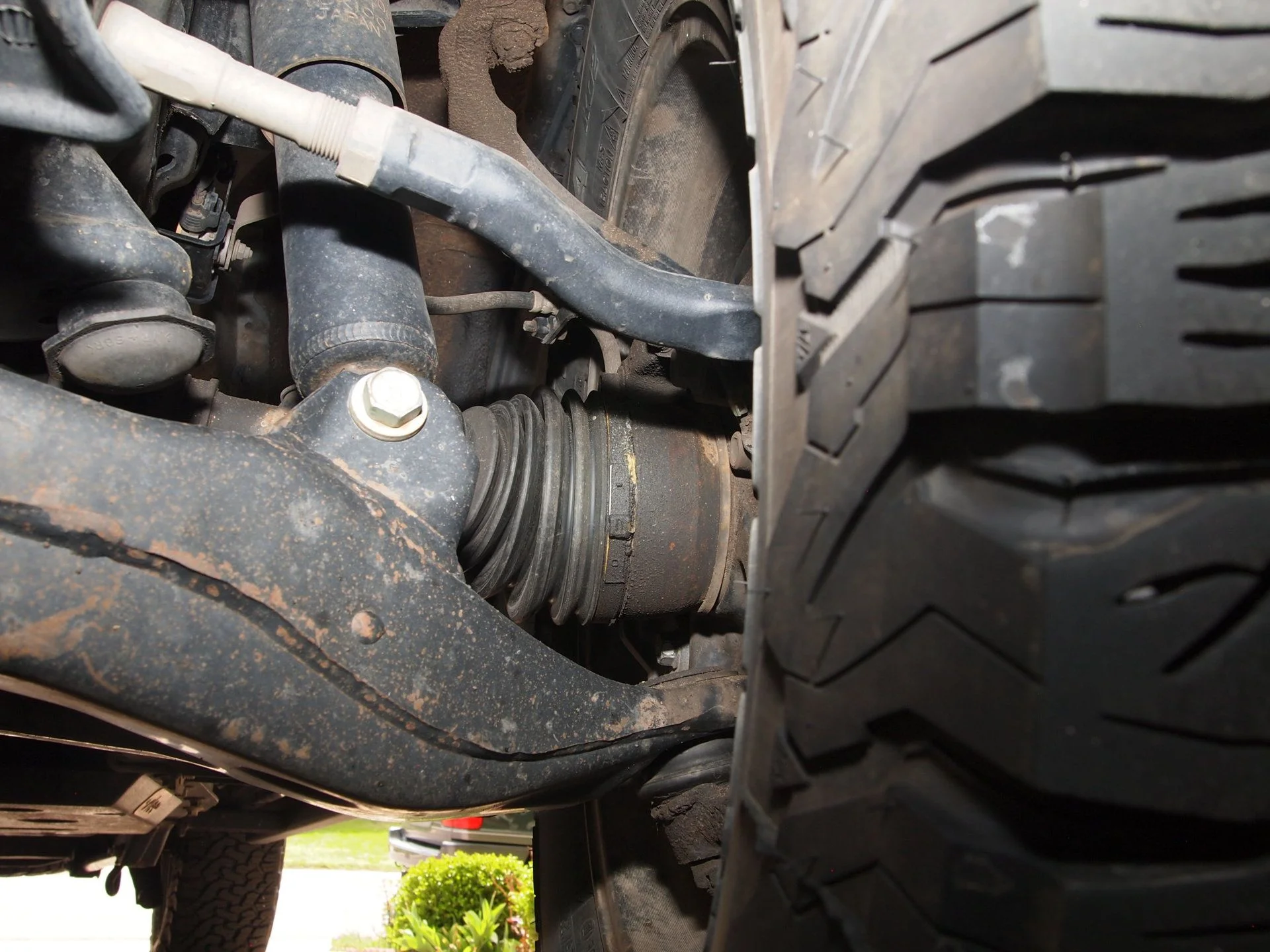

Minor FDS boot weep at multiple points. Clamps likely just needs snugging, which I did.

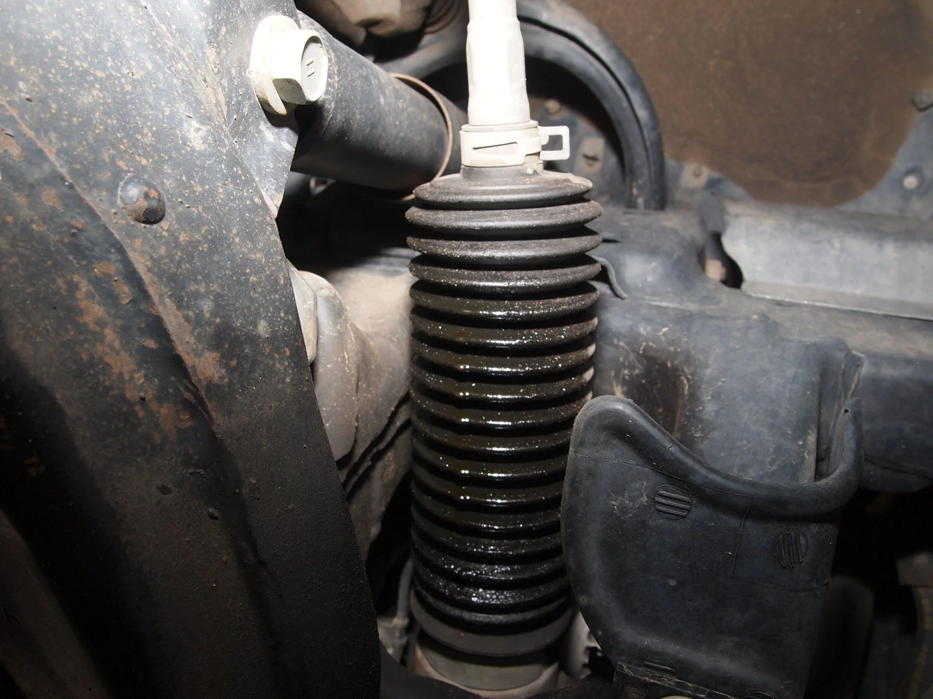

Both rack boots wet from within. Only wet lower half, sign of output shaft seal leak.
1983610
1983613
Reservoir (can't see here) to dirty to see level. But we can see hoses are not leaking. So boots wetness is not from here.
Found hole in screen of reservoir so it's leaking grim into Vane pump and rack & pinion.

K&N filter exposed to elements

Battery wet with acid. Funny history shows recently serviced.
1983629
Vacuum line leaking
1983630

Windshield leaks due to missing rivets that secure side molding to A pillar.
Sorry hard to see
1983657

By side moulding not attached you mean that this resulted in wind noise, not a water leak correct? And the roof rack, were all points in need of a reseal?
"Windshield molding" Both water and wind noise, I suspect. Any hole leading into cabin will allow water.

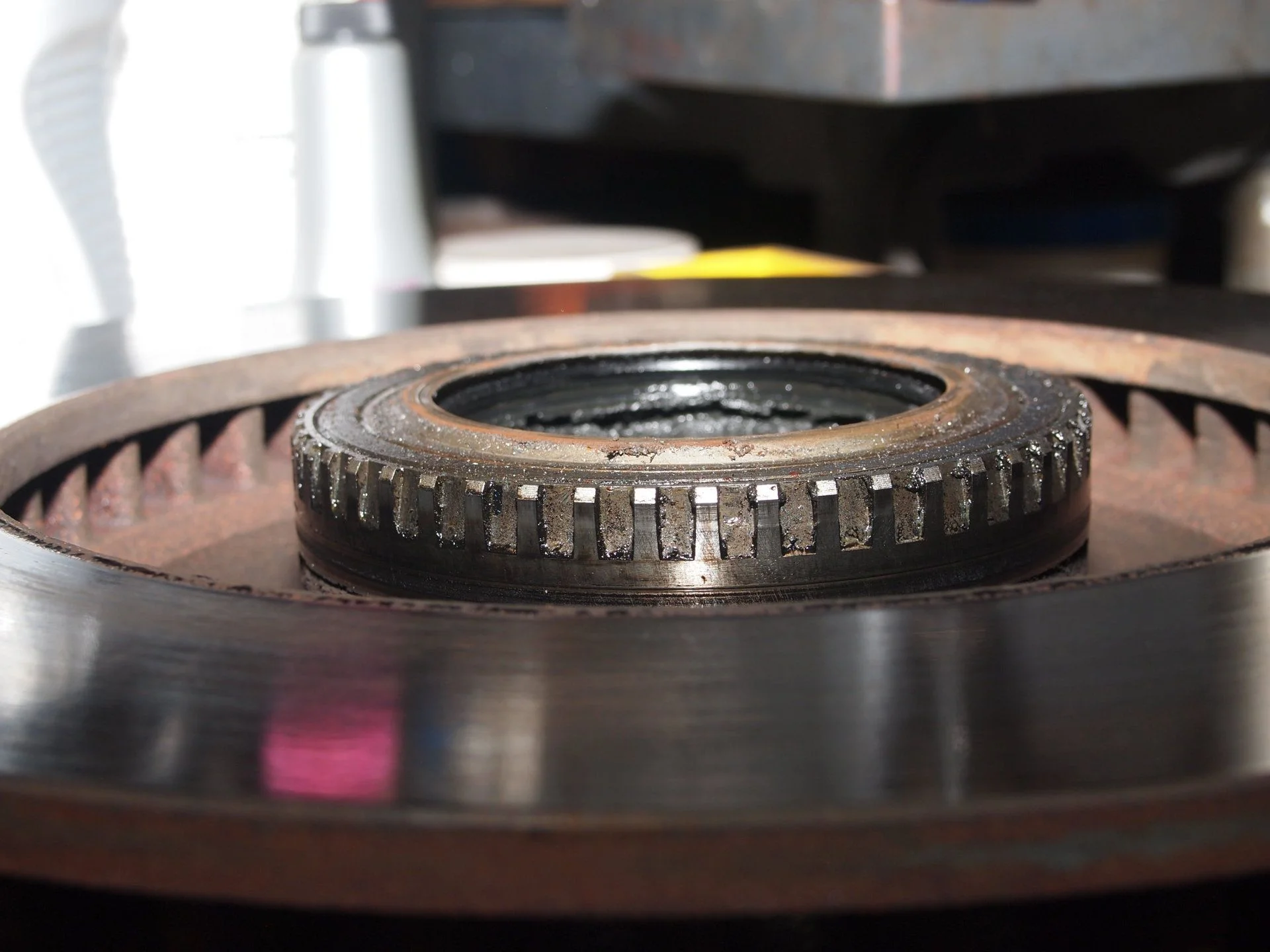

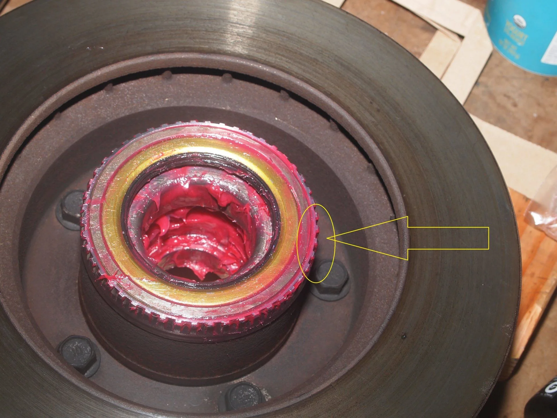

Seems while doing wheel bearing service 12k miles ago. The shop put hub oil seal in backwards. This means the seal metal protion is not flat with back of hub. The seal inner portion has a raised lip, that was now riding and wearing on the back side of spindle (steering knuckle). The back of hub within seal area of wheel speed sensor, has deposits of fine metal within the cavity now. I've know idea if this would affect wheel speed sensor. But likely oil seal will fail prematurely, with fine metal girding it and with it backwards. The seals certainly would not make to next service.
It would also hold hub out at least 2 to 10 mm, while setting preload. I'd would get a false reading on spring scale. This would leave wheel bearing way to loose, as they were.
So, now I've got to re-due the wheel bearing service. I must clean, pack and replace seal(s). As it is now is too likely metal is or will get in bearings at this point. Oh well, one more area we can stop damage before it happens reducing future expenses and increase reliability.
The tiny little spec that look like dust, are metal of seal ground down.
1984485
Notice the seal is raised above hub surface, WRONG! Should be flipped over and flat with it hub.
1984488
Proper fitment of oil seal flat side out, example:
1984509

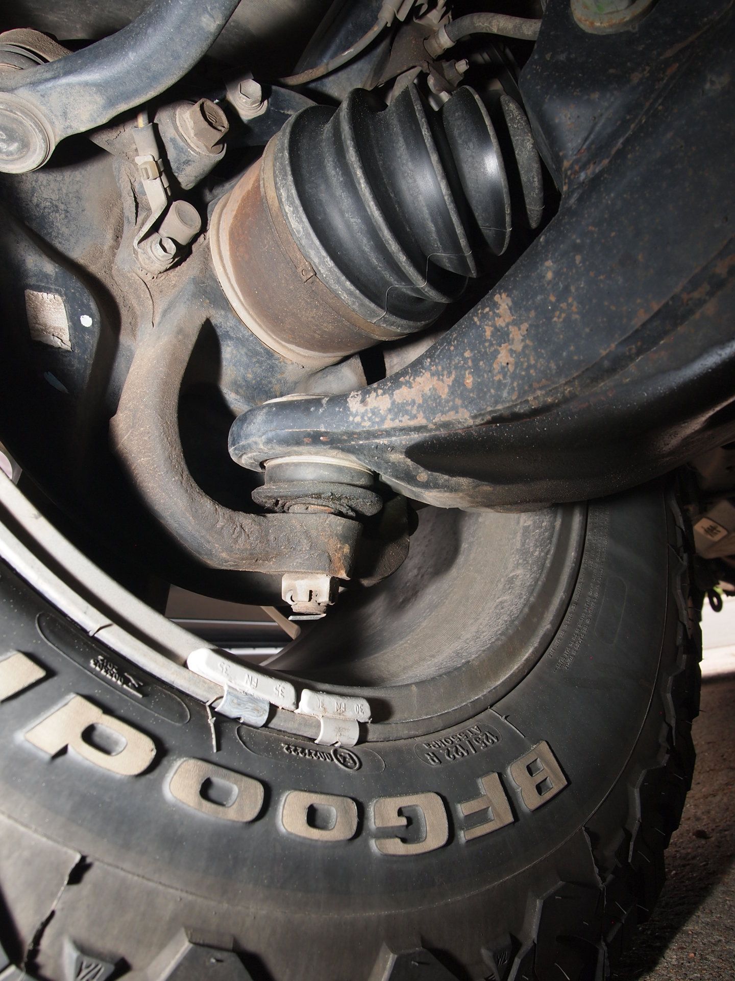

Dang it! Just found another bad ball joint. The Upper RH side. I missed in my inspection.
I been told we must pull the UCA to R&R the UBJ (upper ball joint) anyone know if that's true? If so any work around?
:confused:
As I broke the nut loose, which wasn't tight at all. I was thinking how it must have not been torqued down, when someone rebooted. Wire tie on boot indicates reboot of ball joint. The the knuckle just slipped off the upper ball joint shaft. Not had one come off that easy before. In fact all three ball joint came off to easy.
So I did my usually ball joint inspect. That is by the FSM. Which has wobble the ball joint shaft 5 times. Then put on a tiny torque wrench and it must take a minimum of 26in-lbf to rotate the ball joint shaft. Actually I never find a used ball joint that passes that test. I don't actual have a torque wrench smaller than 1/4". I just spin by hand. This one keeps spinning after my fingers leaves it.
Darn it!

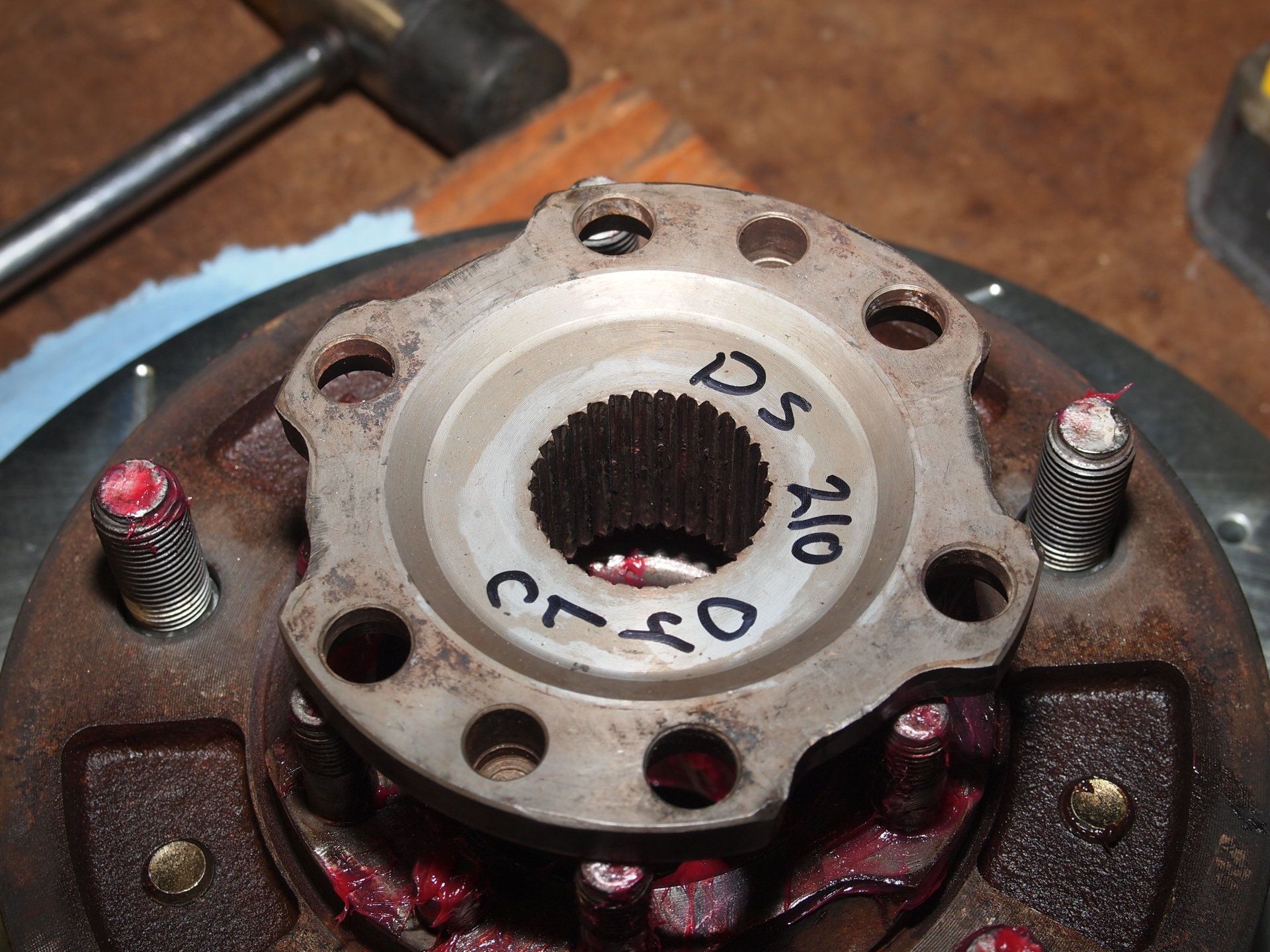

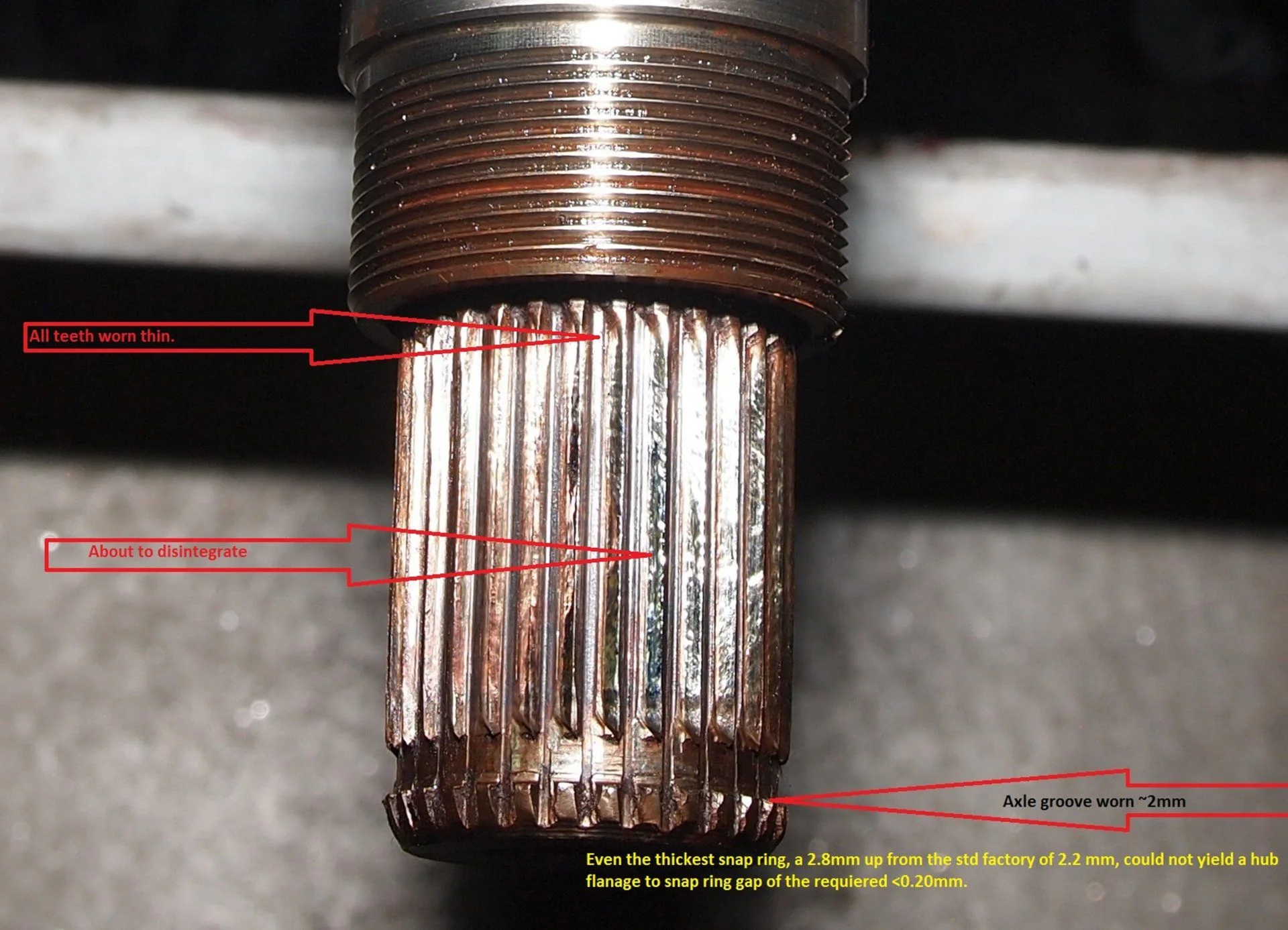

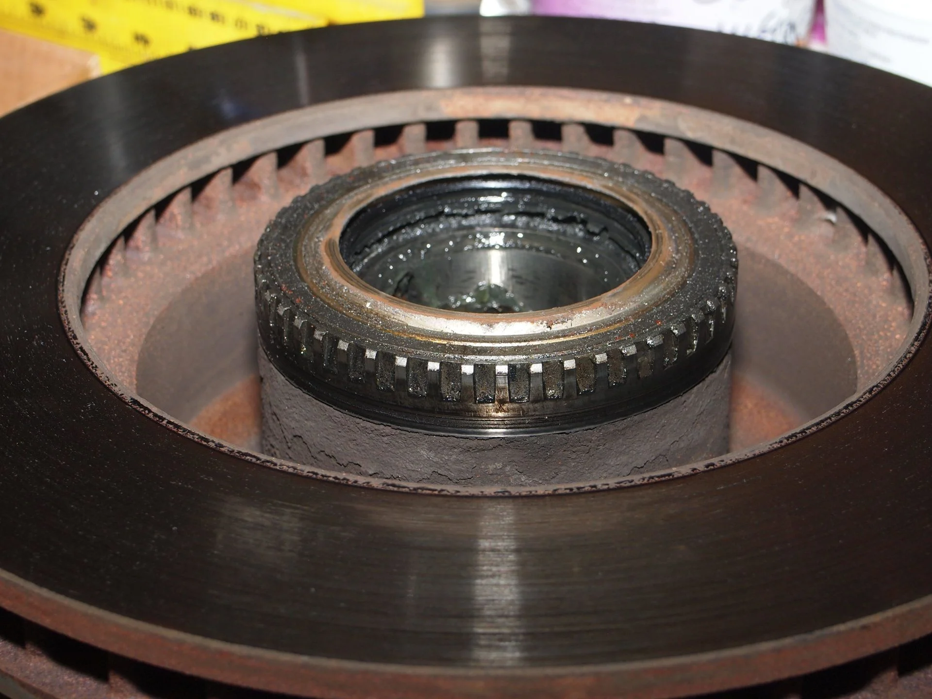

I don't have a picture of at the moment (Hub parts; hub flange, bearings etc.) soaking in solvent. I'll post picture of hub flange here later. Some how hub flange it took a hit on the end right were snap ring rides. This hit smashed the hub flange onto the axle, so I had to use a brass dowel to knock the axle through, to get hub flange off. The snap ring is factory size (E) 2.2mm. The grease cap it been reused many times and shot. The FDS appears to be and after market.
So I'll never know what happen here. Was it a road hazard hit the wheel, grease cap, axle hub flange. Or did someone beat the end of the hub flange with a hammer. I suspect a hammer. As also see pound marks on knuckle to release ball joints.
The wheel bearing locking nut, was on so tight I had to get my 3/4" breaker bar on it. Not seen that before. I could have broke loose with my 3/8" breaker bar, but the 3/4" leverage made short work-of-it. Seem like impact wrench used to put it on adjusting nut, who does that!
The oil seal in back of this hub flange was also in backwards. So the shop that did has miss-understand of procedure, not just one error. This seal was rubbing even more than DS.
Did I mention both hub flanges gasket are glued down with FIPG.

The outer boot seems to soft, not stiff like OEM. So I'm thinking aftermarket FDS.
