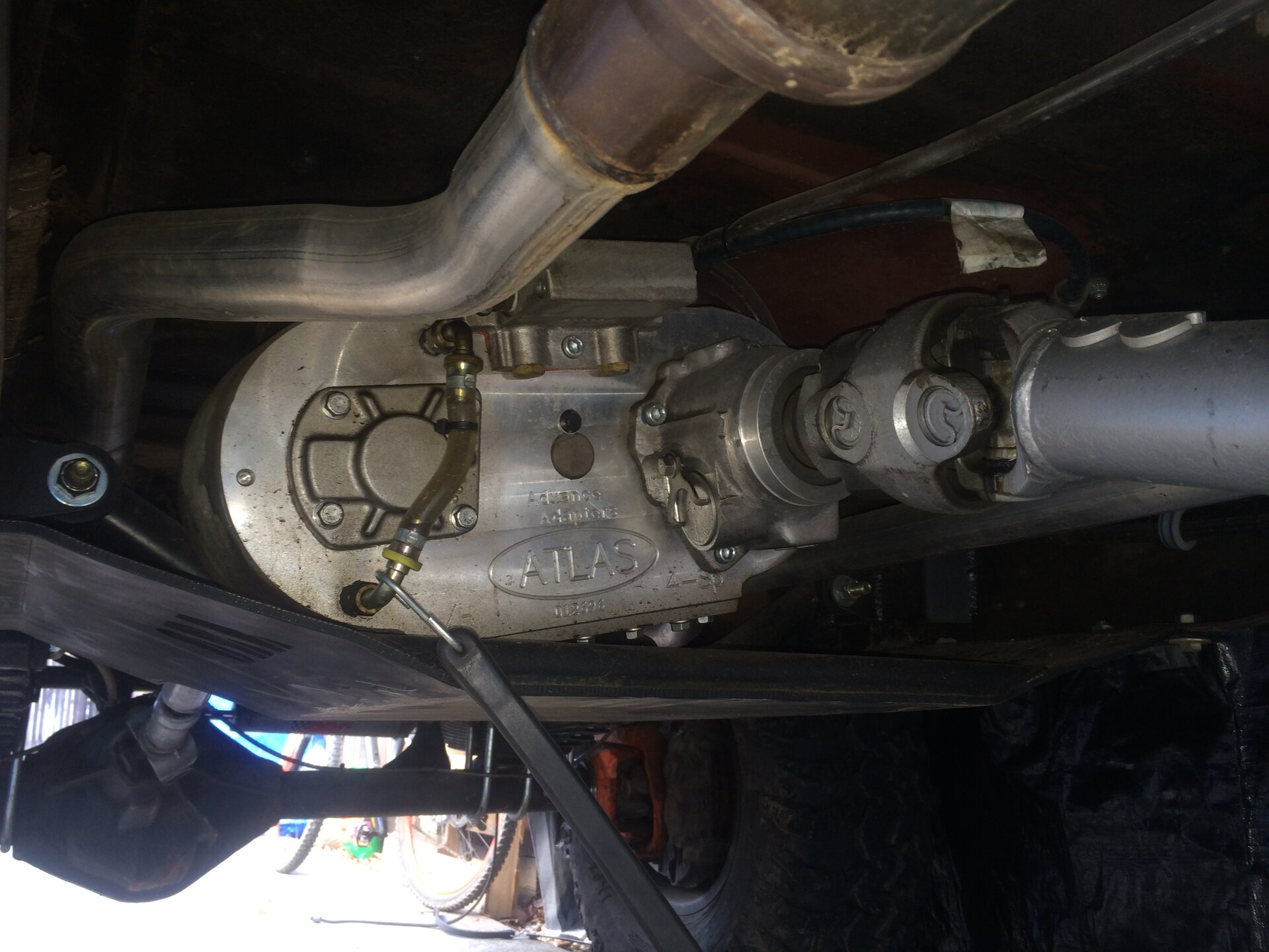

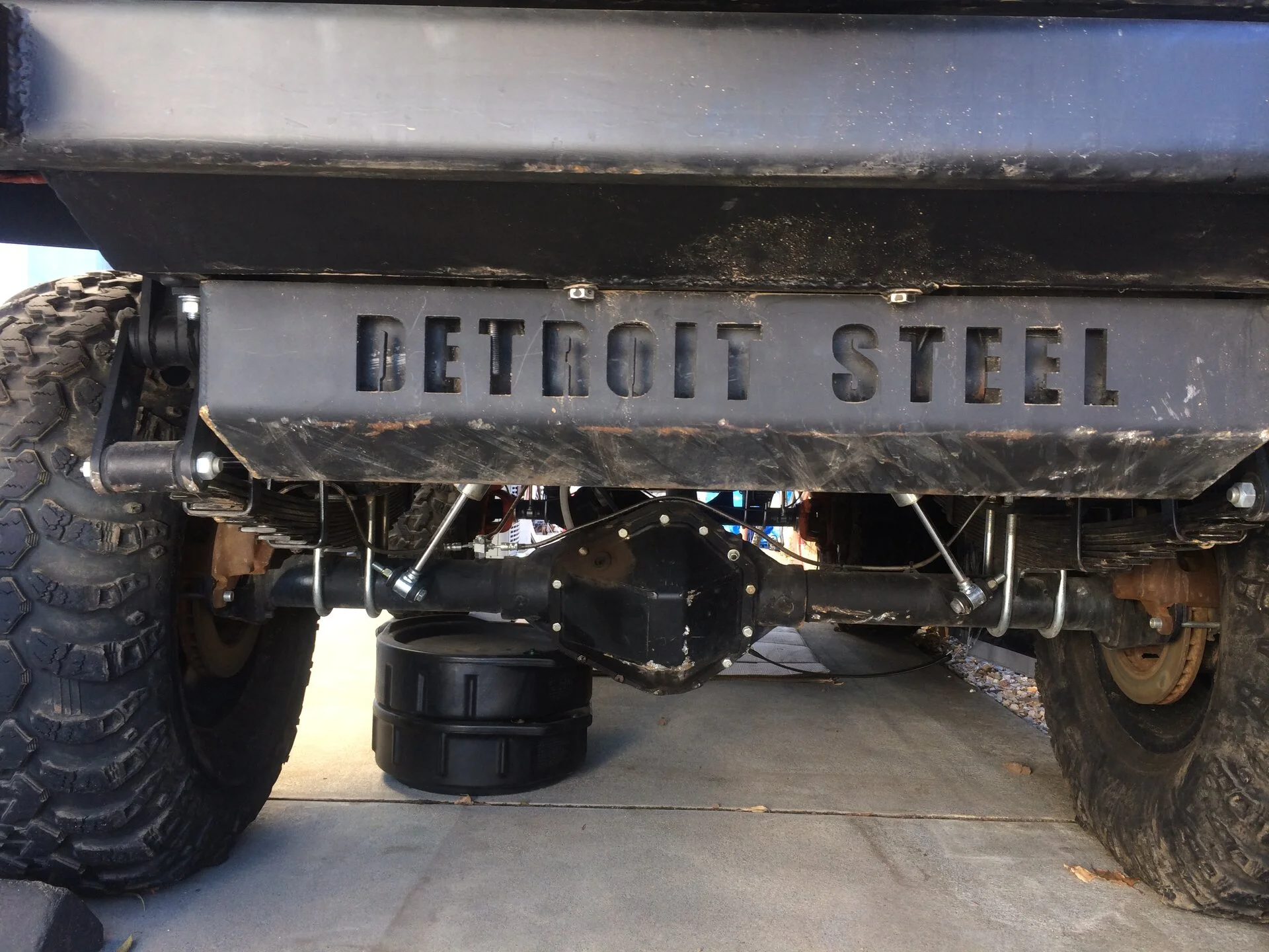

Stupidly, I sold my 1978 Ramcharger in 2014 after 15 years of owner ship. It went from daily driver to trailer queen. Among other things, I put a 4 speed Atlas in it behind the NP435. First gear was 6.69 plus double low of 10.34 plus 5.13 axles came out to 358:1. That was basically useless but second gear in the trans made it 177:1. I normally ran it in single low at 3.8:1 in the transfer case. I wish I hadn’t sold that beast that I named Detroit Steel.

Stupidly, I sold my 1978 Ramcharger in 2014 after 15 years of owner ship. It went from daily driver to trailer queen. Among other things, I put a 4 speed Atlas in it behind the NP435. First gear was 6.69 plus double low of 10.34 plus 5.13 axles came out to 358:1. That was basically useless but second gear in the trans made it 177:1. I normally ran it in single low at 3.8:1 in the transfer case. I wish I hadn’t sold that beast that I named Detroit Steel. View attachment 3210408View attachment 3210409
14bolt in a Ramcharger?
I got the Atlas 4 Speed for my other project just last week. I went with the 3.8:1 low end though cause on the math I figured lower than that would not be of much use to me. With the 4l60 and the axle gears I plan to use I am around 156:1 crawl ratio. That should give me really good low speed with two other low ranges for less technical driving and sand dune ripping.

You make me miss mine even more. LOL I should have never sold Detroit Steel.
Yes sir. 14 bolt and a ford high pinion Dana 60. Plus FAST fuel injection and a lot of other mods. She was a beast! I’ve got more pics if interested.

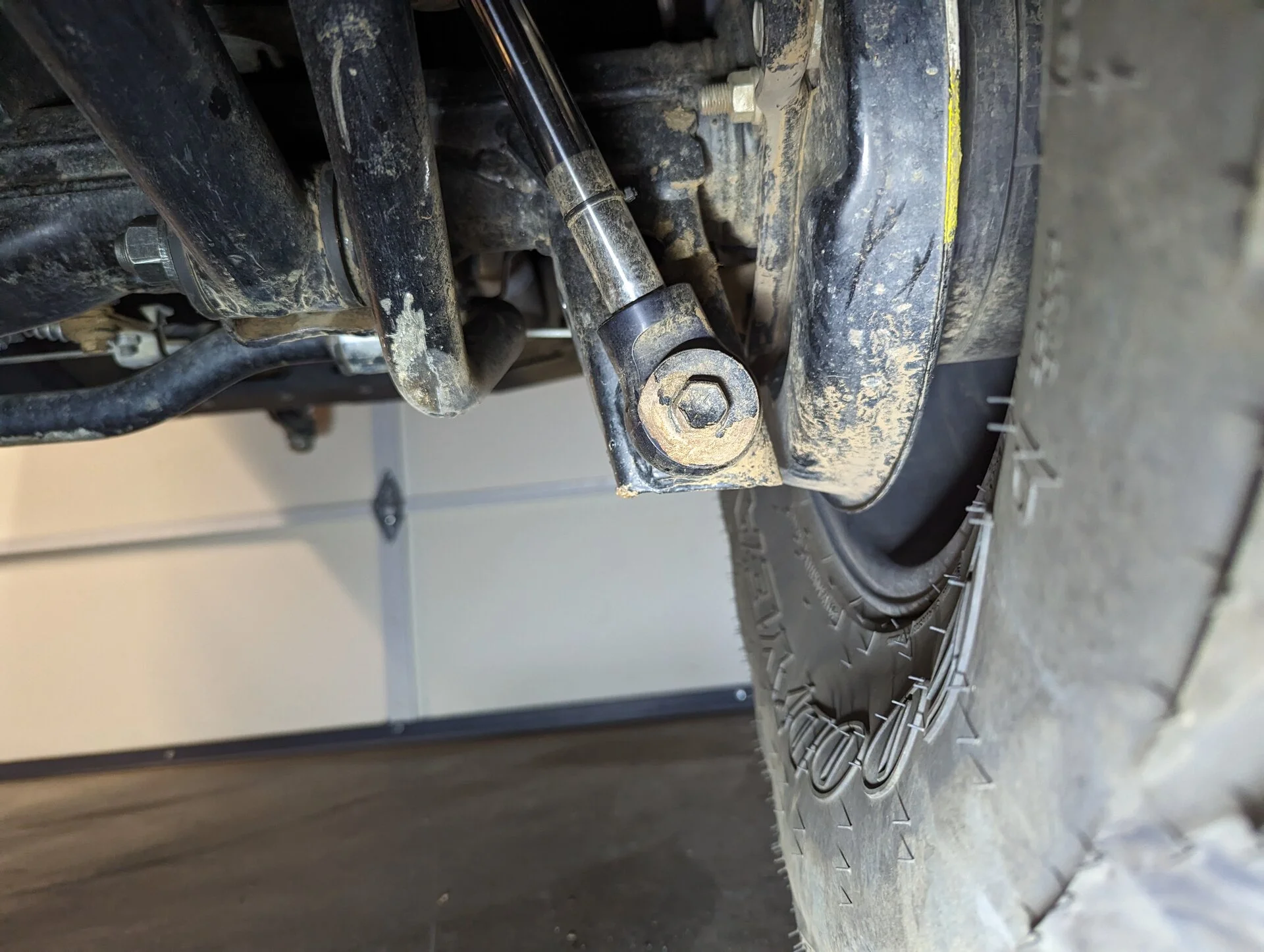

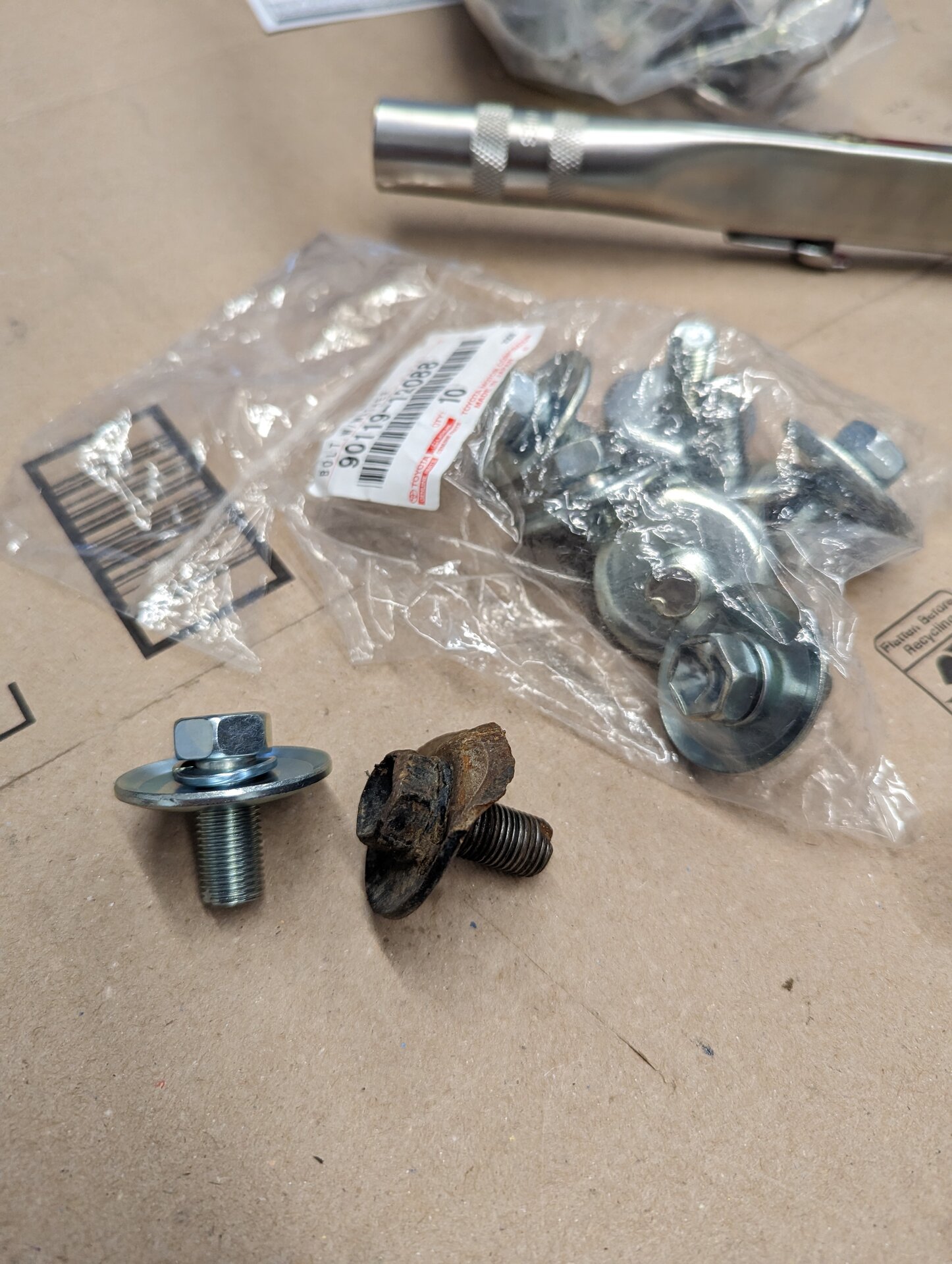

I should probably stop replacing these all the time. I'm betting the weld nut on the housing will wear out from being torqued too often. :rolleyes:
I could always try not hitting stuff, too.

Got a picture of them installed? Look easy enough to make.
This is what I was thinking, as I have replaced that washer and bolt a few time already.
The right size pipe some cut and weld boom done ;)
