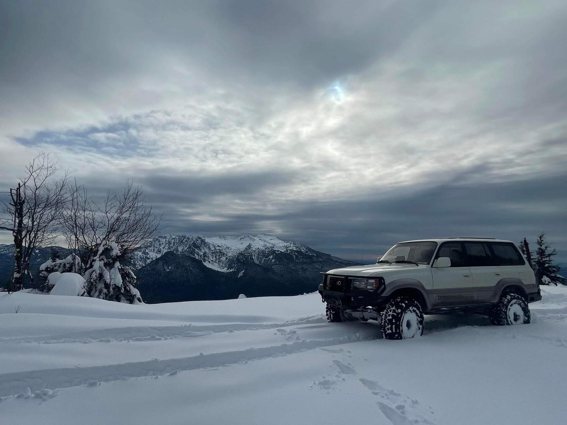

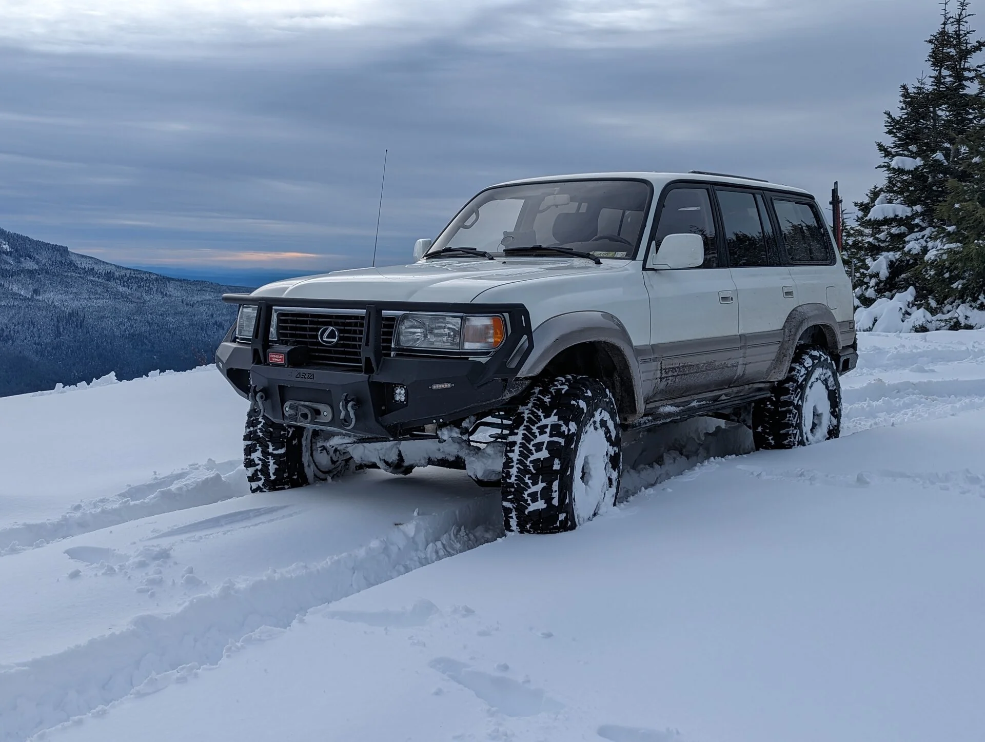

Another good day in the snow. About 18' of fresh fluff above 3000'. Managed to make it to the top with no lockers engaged to prove a point, though it would have been a hell of a lot easier if I'd pressed the button =)

I hadn't planned on hitting the snow yesterday, but I'd driven up to the north end of town for a Dr. appointment and saw all the snow in the hills - Drove home and grabbed the Cruiser to get out and enjoy it. The snow was in a lot better shape than I expected for this time of year and there was plenty of it.
