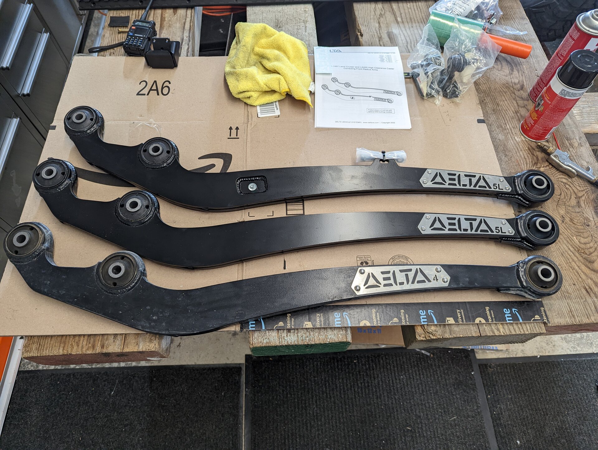

Apparently I got lazy and sat of this for a couple of weeks. Apparently the couch and bourbon were more important over the holiday.
Checked fit today, had the corner of the bracket welded and dropped off for powder coat. Hoping to install when I back home next.
DVS 4" arms swapped out for 5Ls.
Always amazed how my much use the chain comealong gets used when i work on suspension.
How much actual lift are you guys running? @Feldrian @Carey322 Are you both at just the right spot where the 4" arms are a degree off or some weird crap like that?
If I go to a higher lift, it's all of this component swapping I would love to avoid.
I just put Dobinson 4” flexi coils on. I haven’t had an alignment done yet, but based on how high it is sitting I’m guessing the castor numbers are going to be low. These same arms were on my other 80 with 3” springs and castor was 2.1 degrees.
I’m also considering swapping to get the 1” longer arms for the 40’s I just mounted.
@Carey322 Thanks. I can say pretty definitively that I will not put my rig on 40's. Here's one odd thing I found. I was trying to do some more spring research, so I was looking through the Tough Dog website. I placed all of the vehicle info into the required bars, and since I am thinking 4" lift, I also selected that. The springs for my selected application came back as 2" springs. I thought that was a bit strange.
