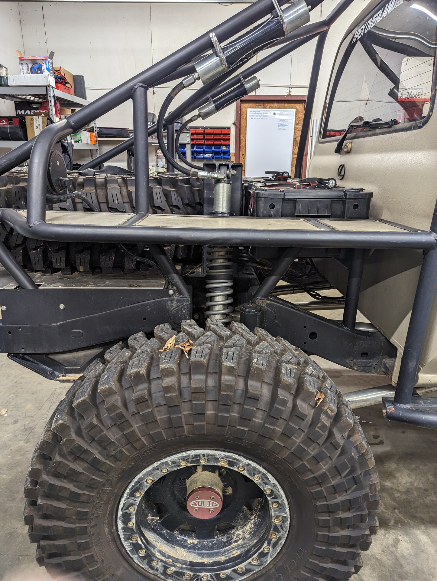

Since I completely forgot to post this here for posterity - I couldn't help myself and I have now become a member of the "OMG, I have more than one 80" club. On the upside, I don't think this one will be boiling fuel any time soon. Huge props to @NCTrey133 for this amazing build. Original build thread: Builds - Sweet Brown 80 & Sweet Brown Buggy - Dual Build Thread - https://forum.ih8mud.com/threads/sweet-brown-80-sweet-brown-buggy-dual-build-thread.1056041/
And most importantly, it's a Lexus ... Because PINKIES OUT, BITCHES!
Lexus isn’t really a Land Cruiser 👀🥊
But that’s a seriously nice build. Congrats. Now you just need another $100k for a tow rig and trailer…
And another 200k for a shop. 😜

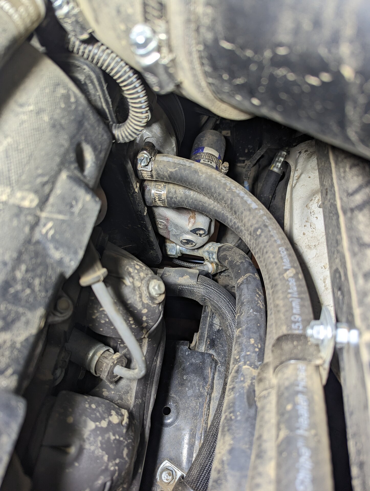

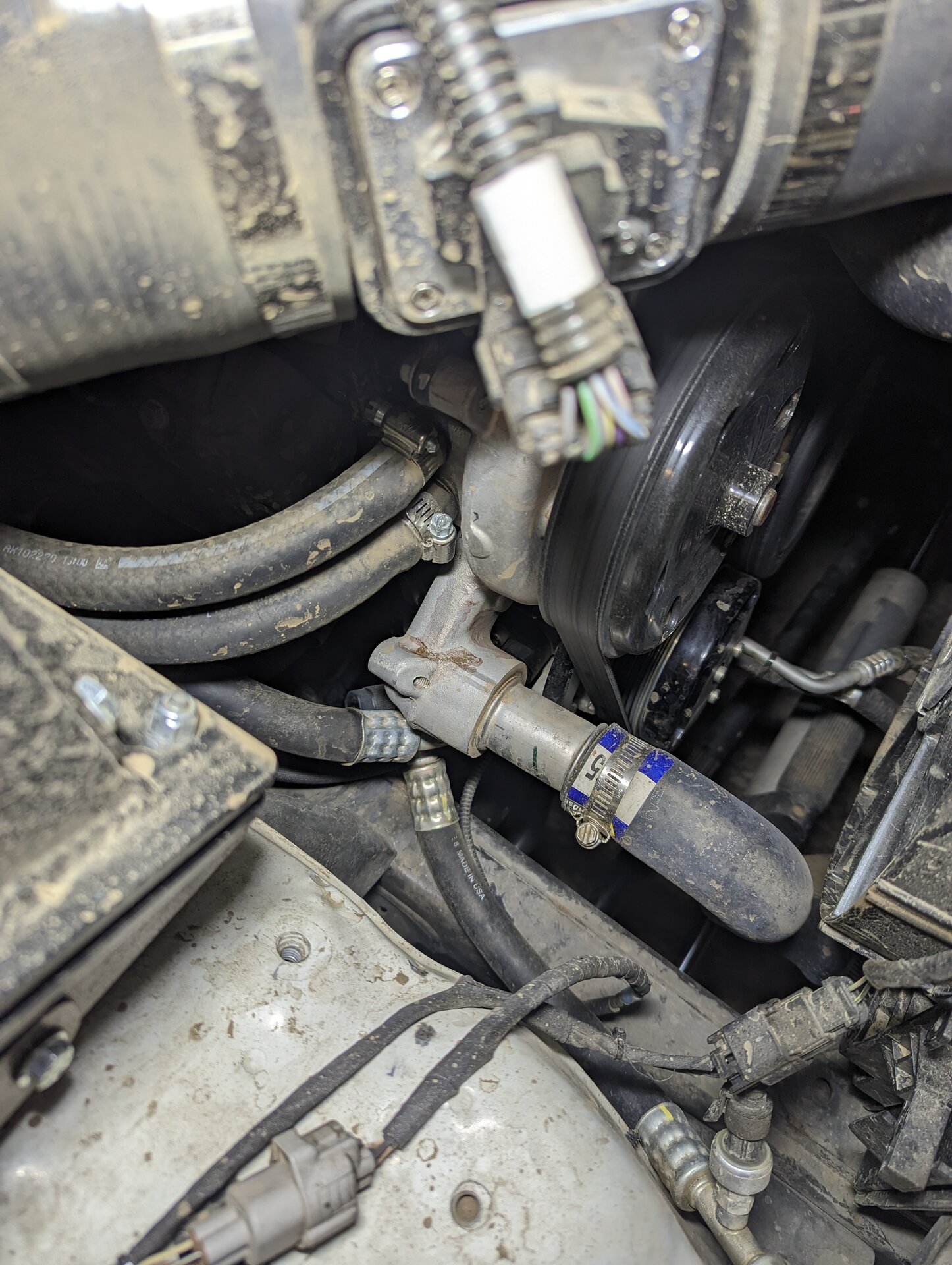

Unfortunately found two unpleasant surprises under the truck while I was crawling around yesterday - Another oil leak on the oil pressure sender and a coolant leak. I typically wash the engine bay after wheeling trips, but didn't the last time out - Don't think I'd have noticed the coolant leak if I'd washed the engine bay. Looks like telltale pink streaks coming out of the back of the water pump under the heater hoses.
