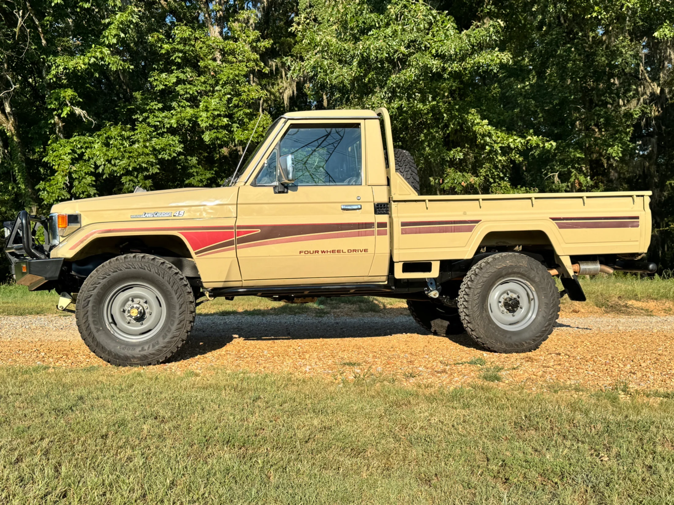

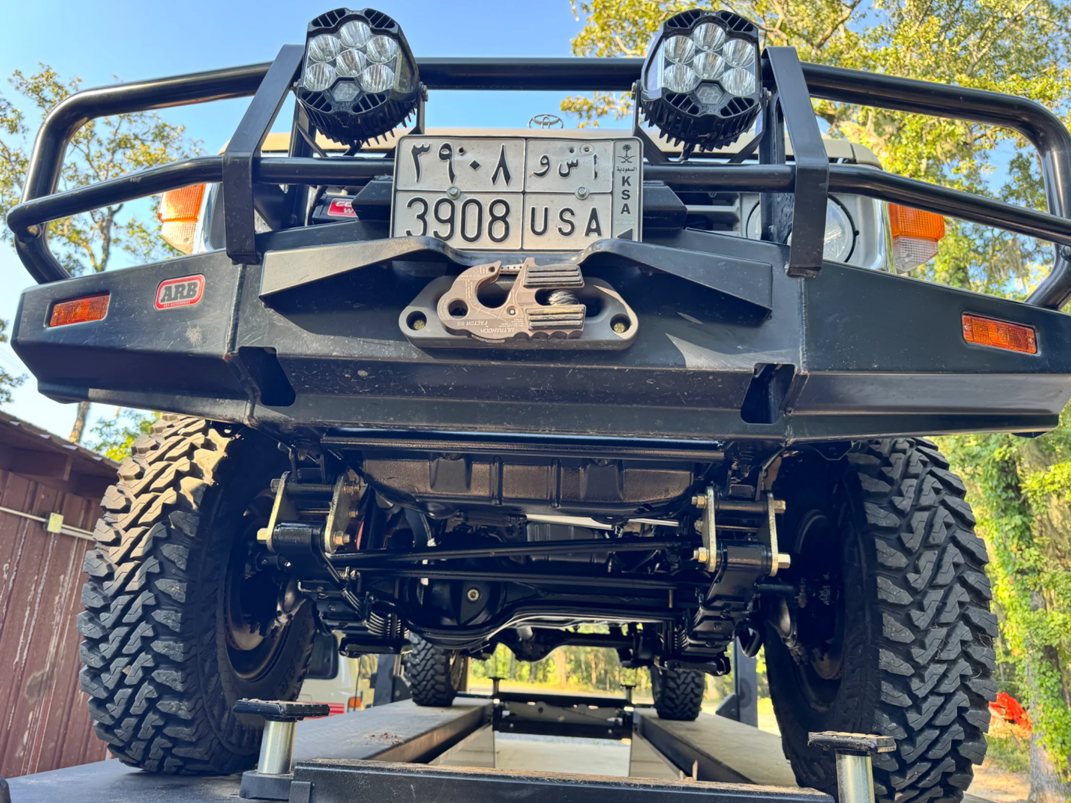

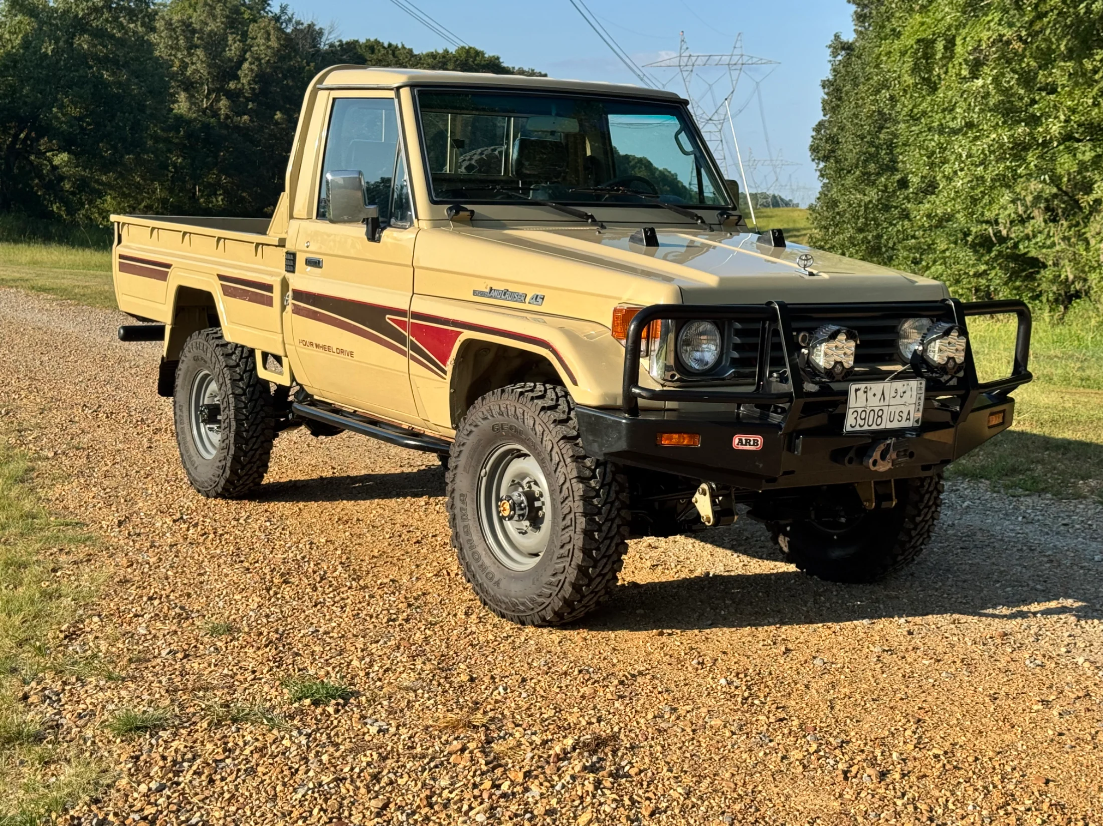

1992 FZJ75 Pickup
221,000 km/132,000 miles
Purchase Price $23,000
In Country Work w/OEM parts $4000
  • Bedliner
  • All weatherstripping
  • Misc parts/belts
  • New OEM carb/pump/filter
  • New radiator/heater hoses
Import Fees/Shipping $5500
ARB front bumper $1300
ComeUp Winch/fairlead/hook $1750
Baja Design Lights $1100
Custom rear bumper/sliders $1500
City Racer 16" wheels $1900
Yoko 255/8516 (500 miles) $1650
Dobinsons MRR suspension $4500
Dobinsons 12 way stabilizer $500
ARB Lockers $4000
ARB Dual Compressor $550
OEM fr brakes and knuckles $550
OEM rr brakes $500
Aisin Hubs $425
Holly Retrobrite Headlights $450
One Stone Armrests $150
OEM bed spare mount $150
Seatbelt Planet shoulder belts $250
OEM tailgate chains $150
OEM washer bottle $150
Hood strut kit $200
New OEM ignition $250
OEM PS pump and new gear $500
$54,975
$13,000 labor
$67,975 invested

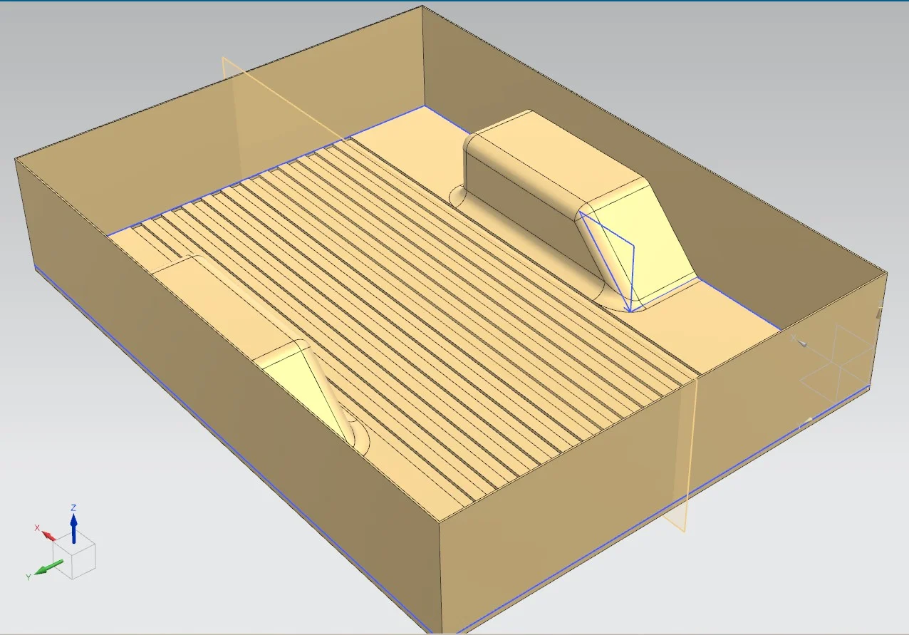

Just wanted to chime in to let the collective know I’m the new owner of this FZJ75. Thanks to @wngrog for the fantastic build. I’ll be updating this thread with my continuation of this vehicles journey. First off will be dialing in the dampers (shocks) and doing some testing on Vermont’s finest class IV highways over the coming weeks. I’ll also do an install of a Midland GMRS radio. I’ve started modeling some storage concepts for the bed which I’ll post once I have these in a state to share. Stay tuned….
Started the CAD modeling of the bed during my lunch today. Got the overall internal space modeled so I can start to come up with some storage concepts. If anyone else needs the CAD data, let me know and I can forward it over in whatever format you need (I did this in NX but can export .step, .prt, .jt and parasolid etc).
I spoke to a tech person at Decked as well and they showed some interest in doing a custom configuration for the FZJ75. Their mid size truck drawer will fit perfectly between the wheel wells, now I'll send them over a concept for the top plate and see what their appetite is for making something work for our trucks. If anyone else is interested, please let me know so I can inform them. They seemed very supportive of custom builds which was encouraging.

Decked can supply "full-width wingers", which can then be cut down to fit. Given that its essentially a rectangle, it is pretty easy to do. I have one currently in my 75. It is a very tight fit between the wheel wells and may require some additional clearancing, but all simple to do.

When you spoke to Decked, did they provide you with the raw size prior to any cutting?
