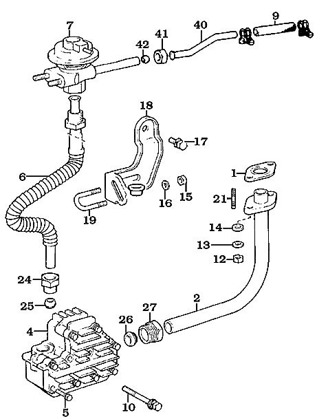

Tried (and failed) to disconnect the EGR J-shaped tube so I could replace the gasket at the exhaust manifold.
I could not loosen the nut where J tube connects to the EGR cooler - #27 in illustration. Trying to replace gasket #1 in illustration:
What have you all done to get this loose? Remove fender?
Consider loosening/removing the EGR cooler bolts (#5 and #10) and that should put enough slop in the system to let the J pipe drop down. You might warm the area of the stuck nut with a propane torch and reapply WD-40, too. In this case, you're not trying to heat up the EGR cooler to expand it away from the screw threads, you're just trying to promote the penetrant getting inside where it can do some good.
