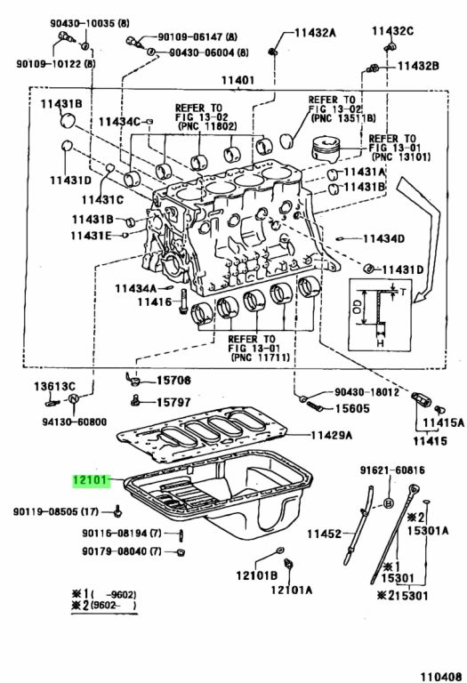

What a great adventure! That sump looks a little beat up, I assume from the accident the vehicle was in? You might be able to source a mega cruiser sump (without wings) from toyota EX Japan.. I'm sure someone here in Australia was able to source one and it cost about $500AUD.. about the same I spent on a factory cast 15BFTE exhaust manifold..
Edit: Part number: 12101-58150
Yep sump got smacked by the driveshaft. I tried to order the pan already but that one is discontinued so they cancelled my order. I just found another part number though and will keep my fingers crossed.
