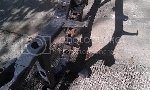

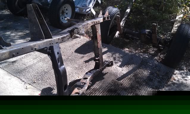

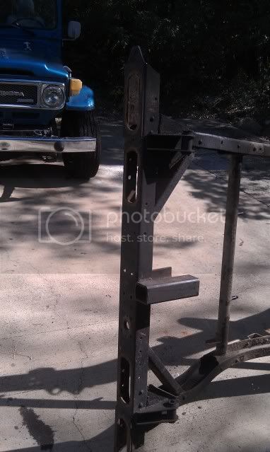

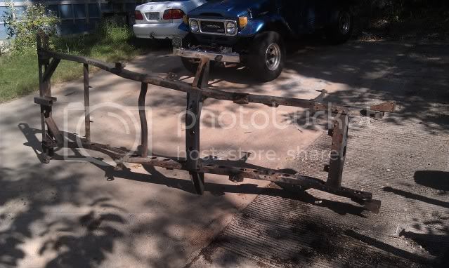

Current state of the frame.
Have to finish removing the pass shock tower and installing matching ford tower.

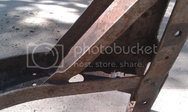

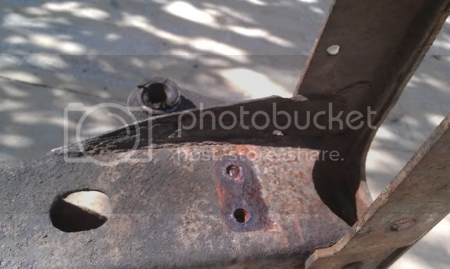

Rear spring hangers are rotten and PO did a number on the rear cross member. I have a replacement rear frame section I picked up from classic cruisers. As soon as those two things are done off to the blaster. Still trying to decide weather to galvanize powder coat or both. If I galvanize and don't powder coat I would still want a black finish so maybe paint? I can get galvanizing done for $50 for 100lbs so I'm thinking 150 bucks. Thoughts on this? I personally don't believe warping is an issue.
Why the ford
