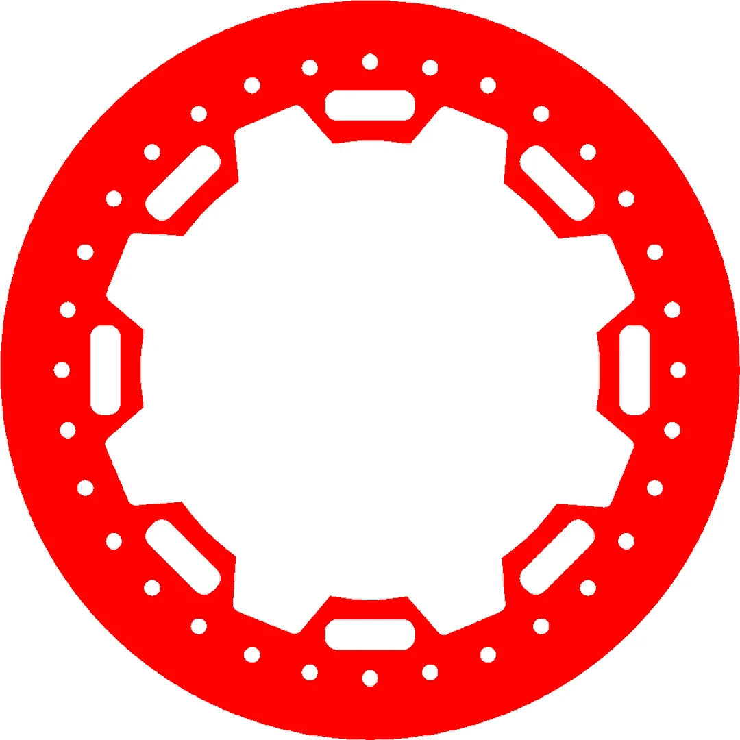

DIYBeadlocks.com used to have one called the "Ocho" that is the closest to the design I'm looking for. Surprised how many of the ones available are seriously ugly designs.

The one from DIYbeadlocks that I like best is this one, "the Ocho". But since these guys aren't making them any longer (that I can tell) I'm trying to find another one of similar style. I can just have someone cut me some but it could be cost prohibitive because of the small quantity which is why I'm looking for anyone else that makes it.

Box, something like these look somewhat like the red beadlock you posted above: 1910002 | DirtBound Offroad Jeep Rock Grinder 15 Inch Rock Rings Set Of 4 Steel
Only difference is being weld-on they usually have those gaps on the outside to relieve the weld and shed water. I guess you could weld in an entire beadlock ring and just use them as rim stiffeners vs. a beadlock.

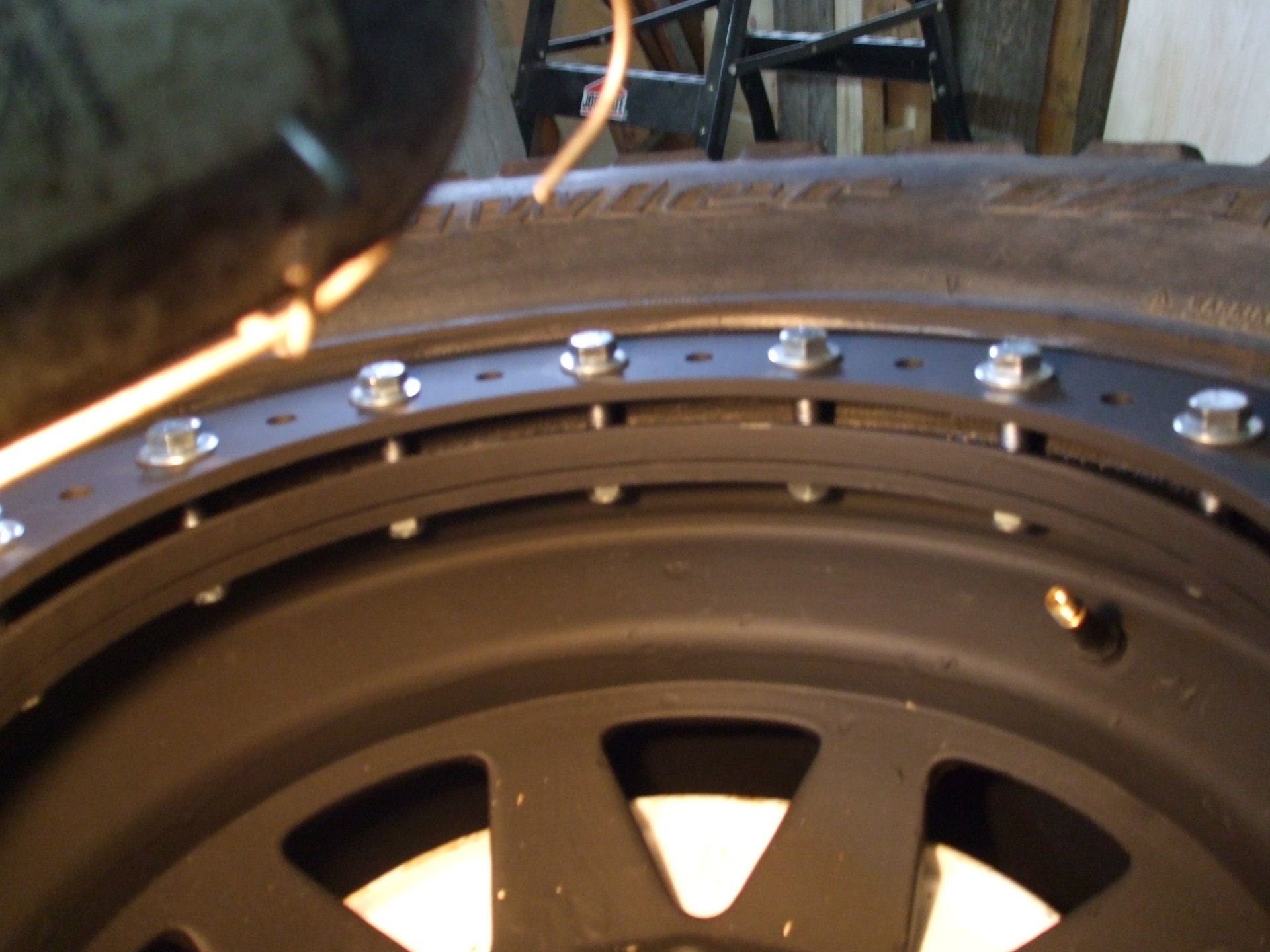

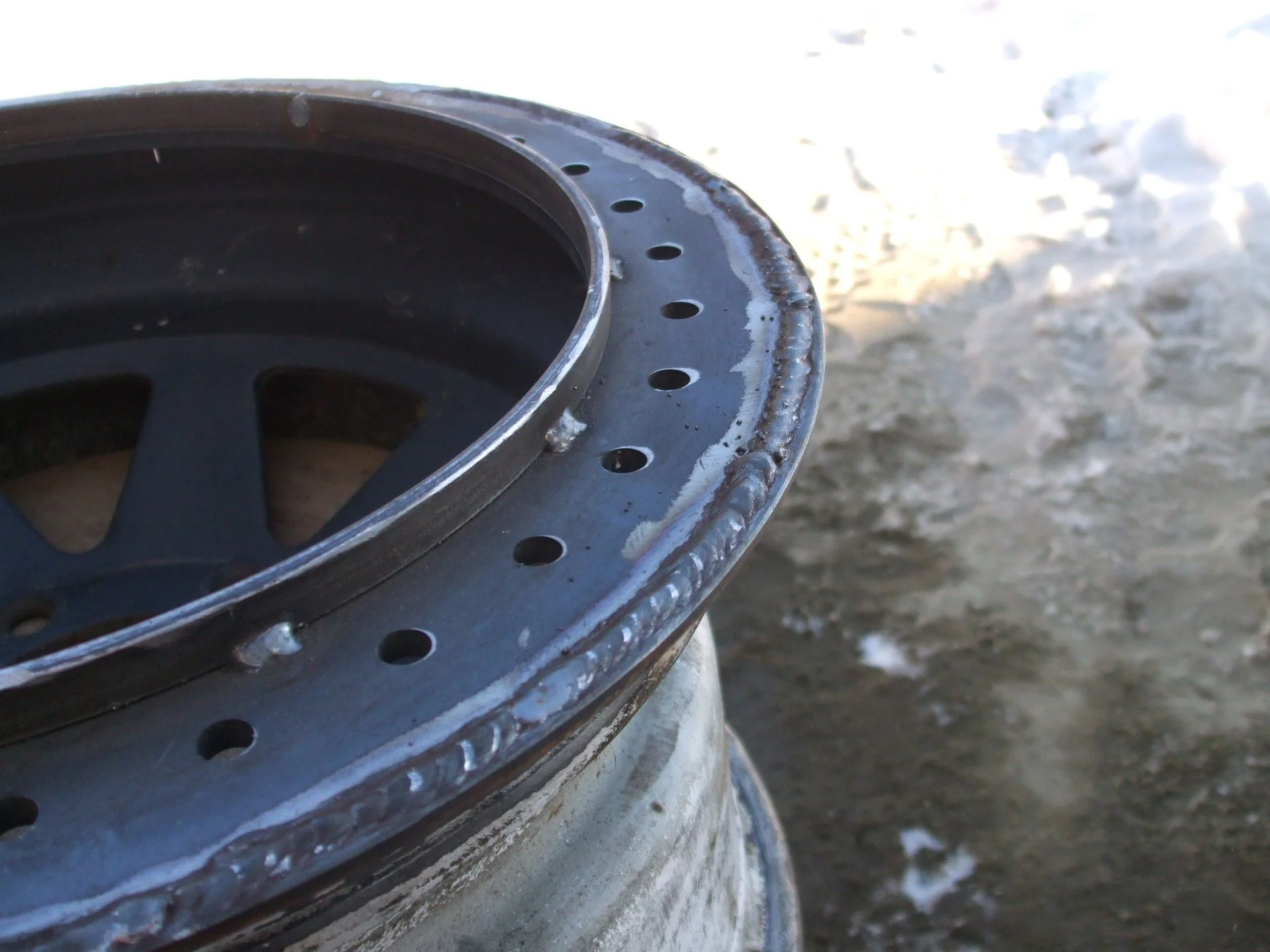

i like my DIY weld-on beadlock, made to install inside the rime , some other are made to fit on the top of the rime and the weld on the edge of the lip , it make the circumference bumpy
i can mount the tire with the beadlock ring or or without it if i just want the rim protection (rock ring)
