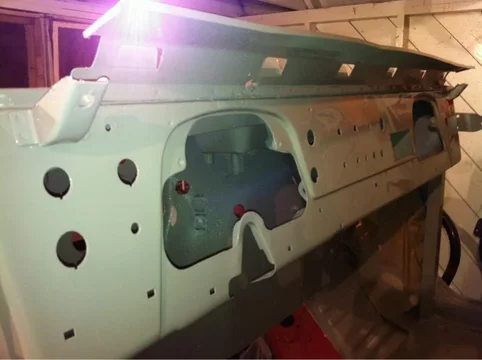

Raptor is on, and im moving to the tinted Raptor on the inside of the tub this weekend. Also will be shooting some paint for the first time on the dash to get the inside of the tub ready for re-assembly. woot....

More shots, plus I painted the dash and door pillars as well. Gonna need to sand a couple drips out. Going to be installing the wire harness soon as well as the firewall goodies.

Christ that looks good! Ever considered respraying the dash after the block-down? As opposed to just blocking down the runs.
I thought about that, and might go that route. I'll see how much of a pain in the ass the runs become.
