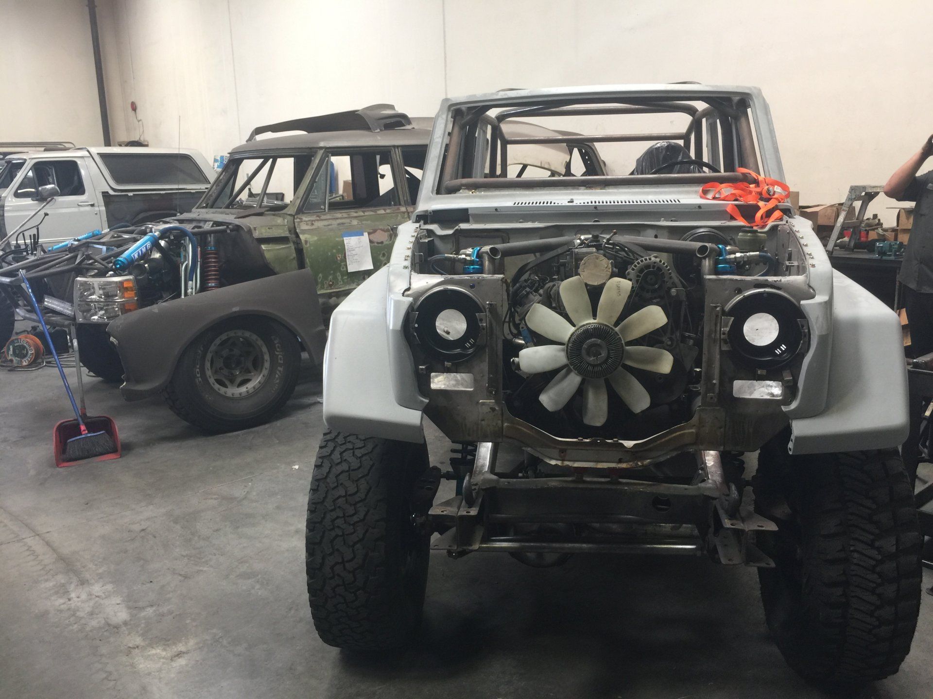

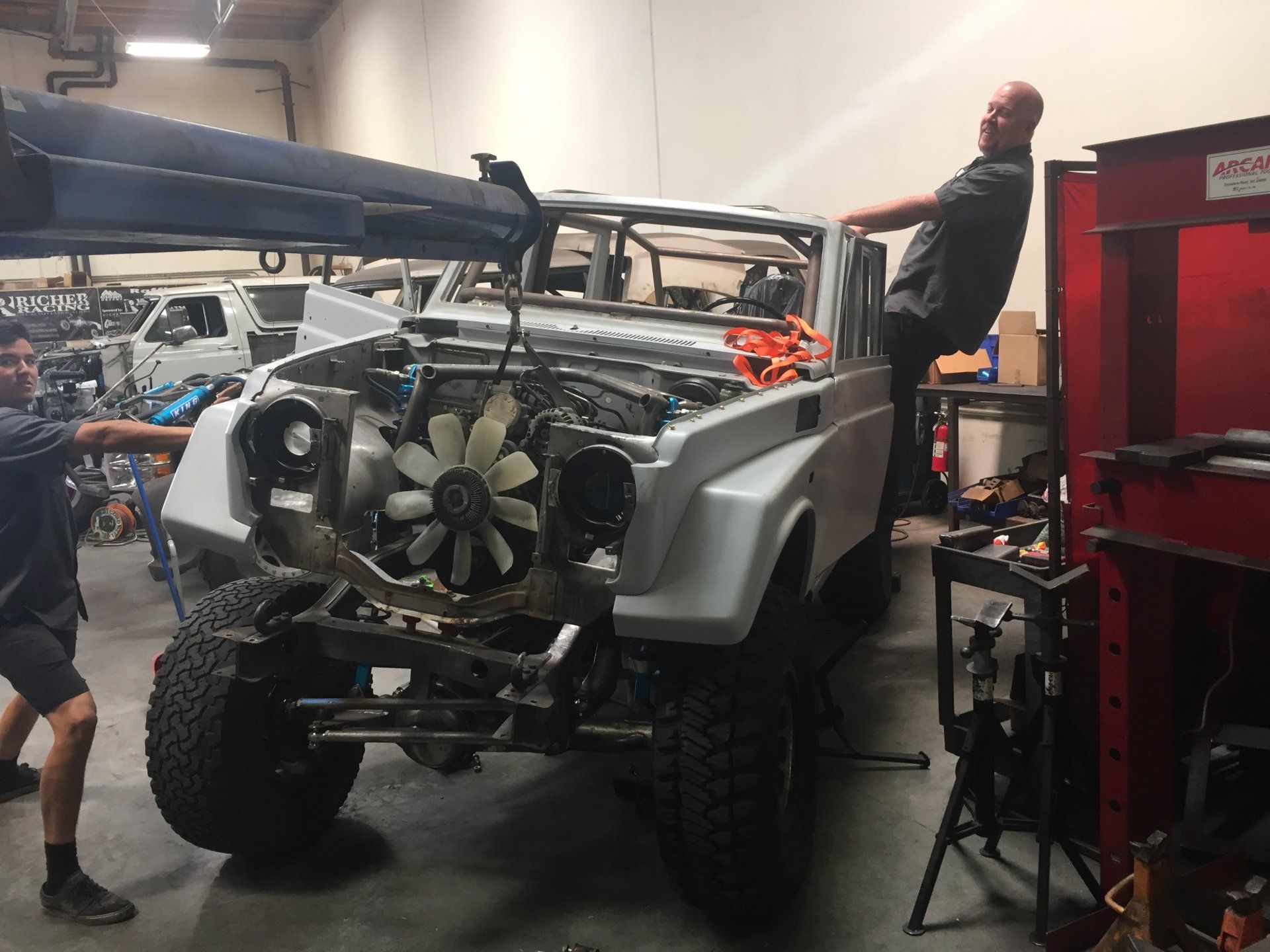

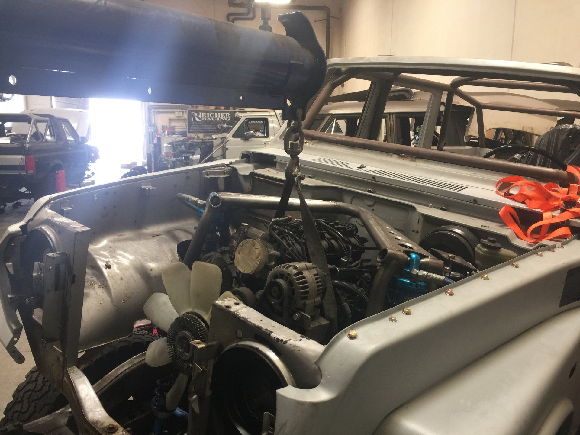

Got motor/trans in on its own weight. Once I get radiator, batteries, bumper and winch, it should settle down nicely.... it barely went in as a complete unit with heavy massaging...
