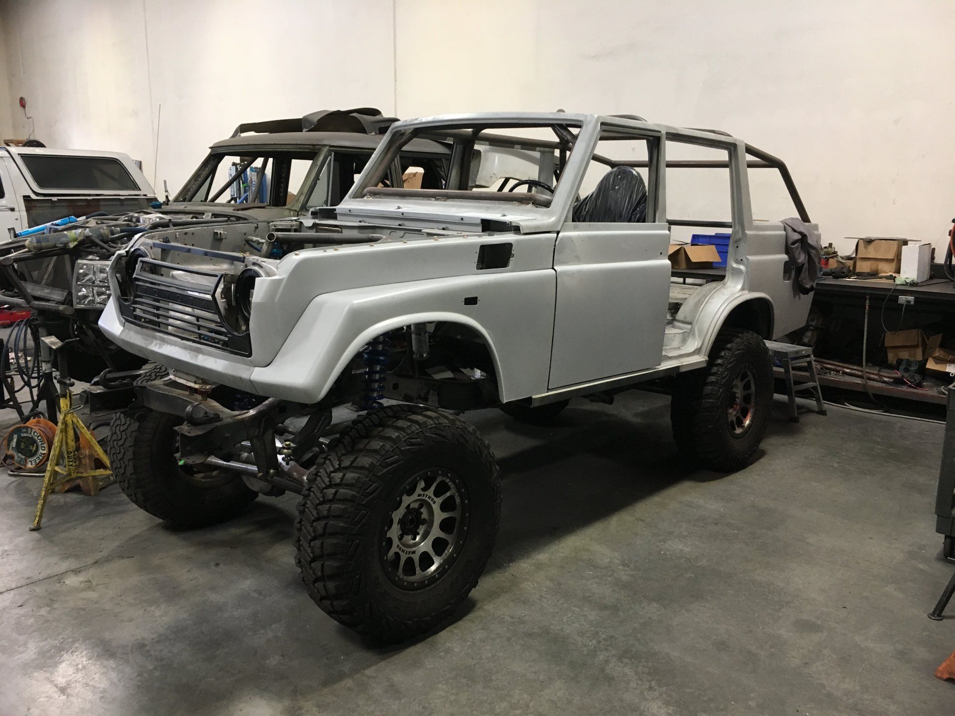

Nice rebuilt hood hinges.. going to be putting motor/trans back in
Full droop in front( what it'll look like if it caught air at Surf-n-turf, which it will hopefully in 2018)with front fenders trimmed. Extending rocker slider out to almost opening of wheel well.
Rear sitting on its own weight. Ride height should be just a little lower with weight of fuel, roof rack and rear bumper/spare tire. It's adjustable if needed...

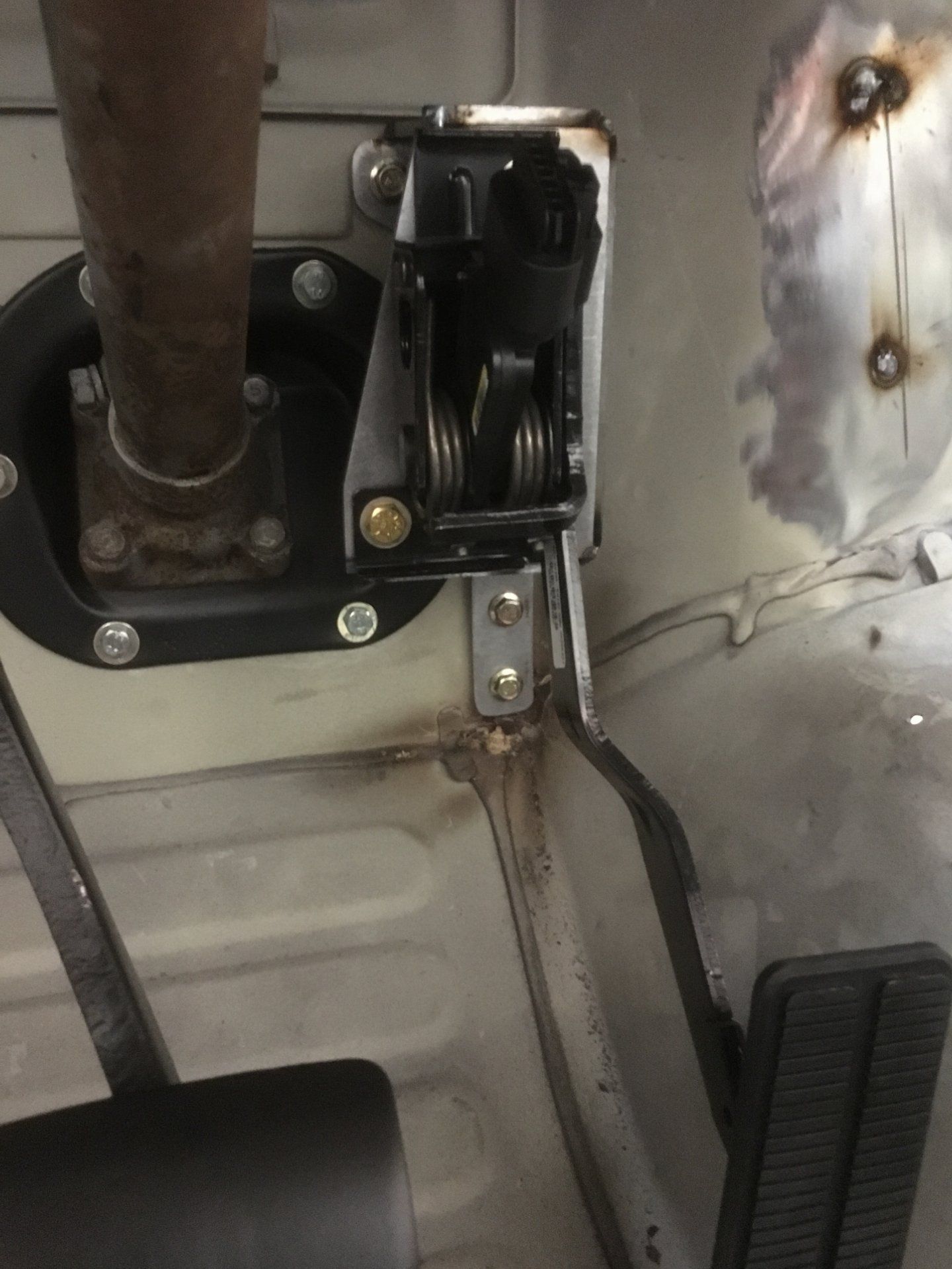

Anyone else putting a "Drive By Wire" pedal for a GM motor in their 55? This works pretty well and we could make a few more??
I'm running one, but cut down the pedal arm so my leg had some more room to stretch out. The adapter looks nice. I love making stuff like that.
Mine is drive by wire but it's from a 2005 Tundra. I'll probably talk to Jonny about cutting some plates with the right bolt pattern for mine when I get to that point.
Sitting on its own weight on all fours. First time in years. It's a roller finally. Motor and trans will bring it down.
