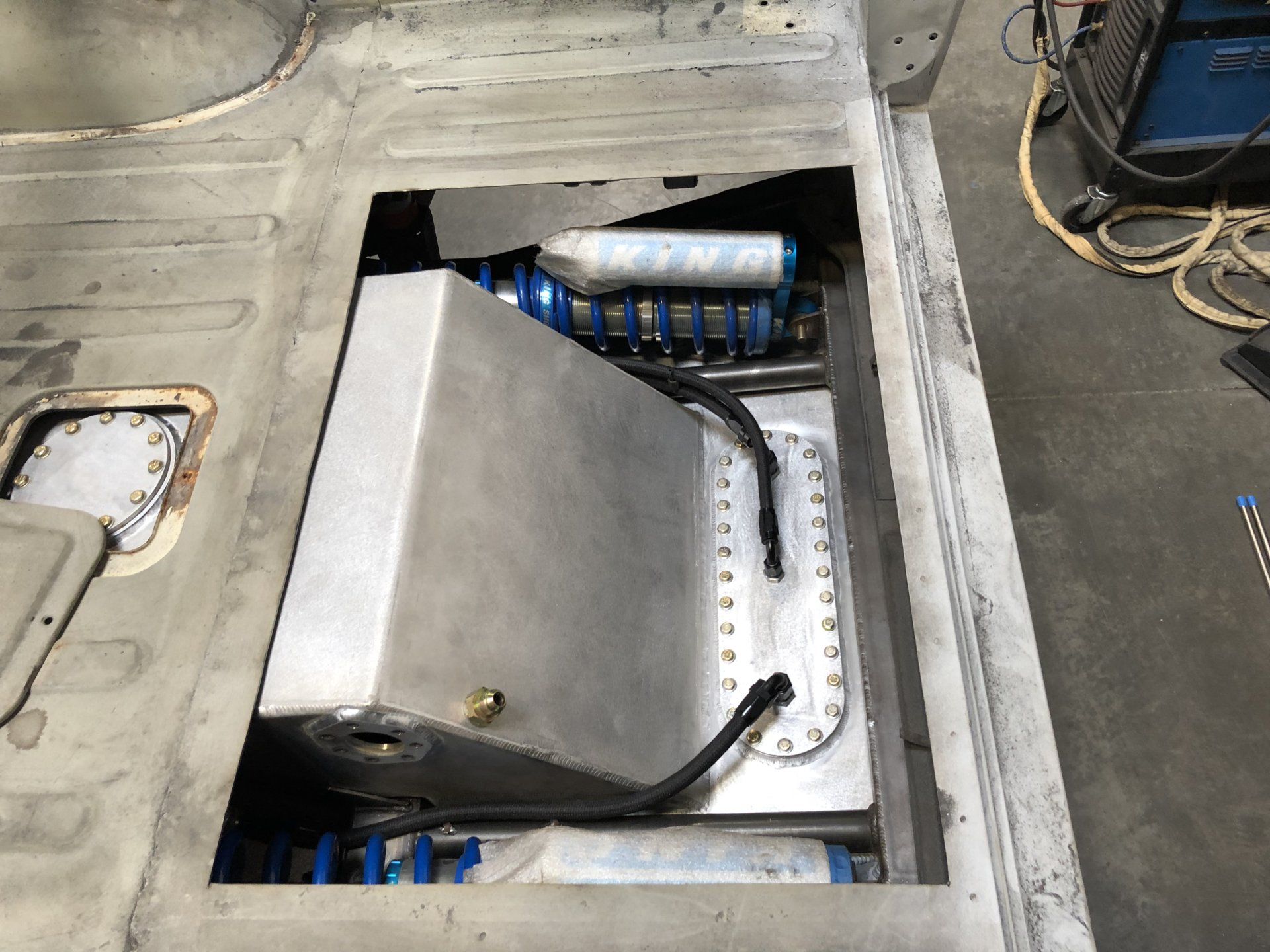

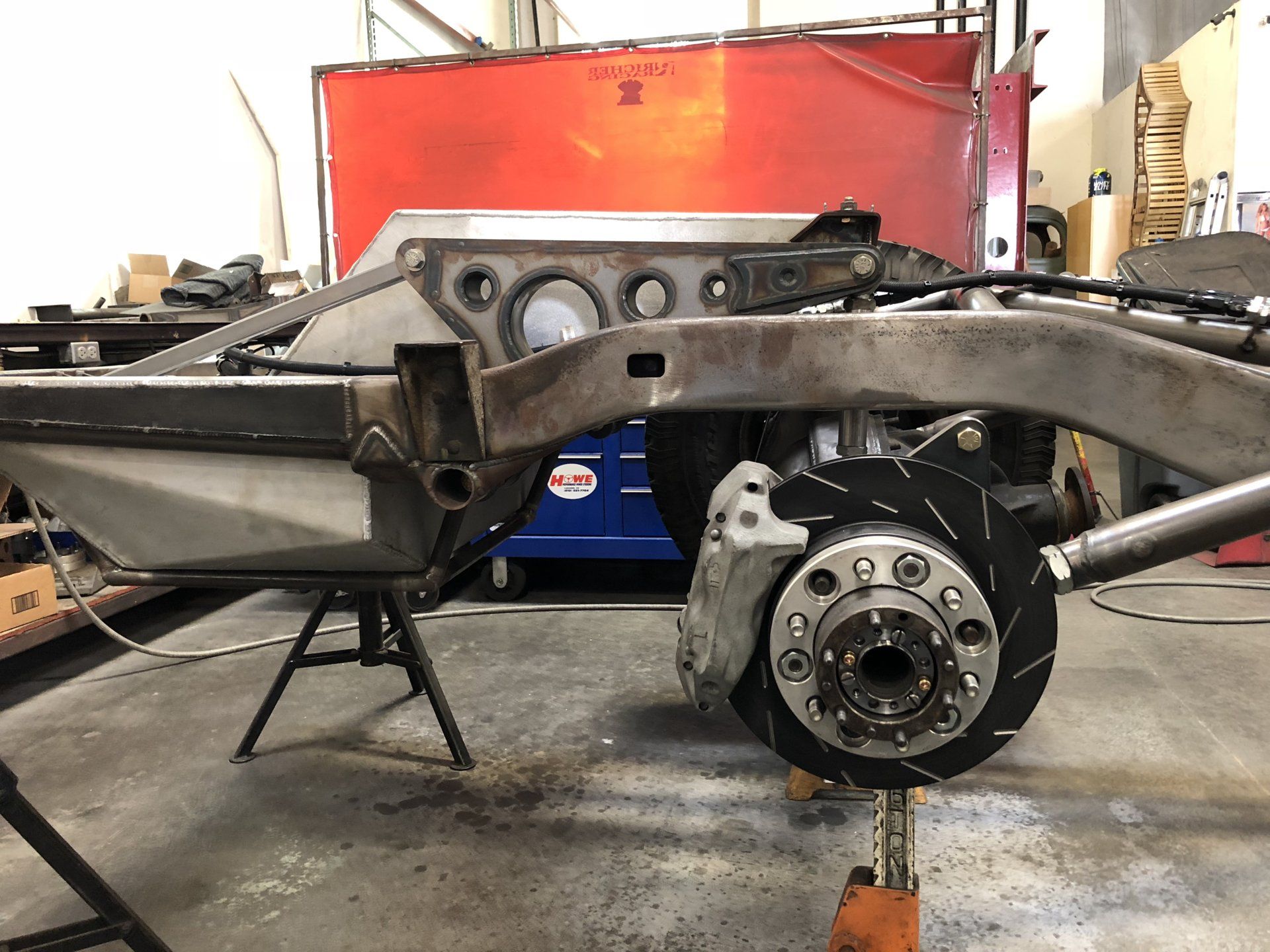

Plumbing pretty much done. Now the crazy rear sway bar design. Not much room. This will take some brainstorming
Yes. The cage below it comes off and I can reach all connections and it shimmy’s right out. Not a quick job, be can be done..
when I do the wiring, gonna set up master connections for cab wiring, motor ECU so pulling the cab won’t be that hard. Brake and fuel lines will have disconnect points as well.

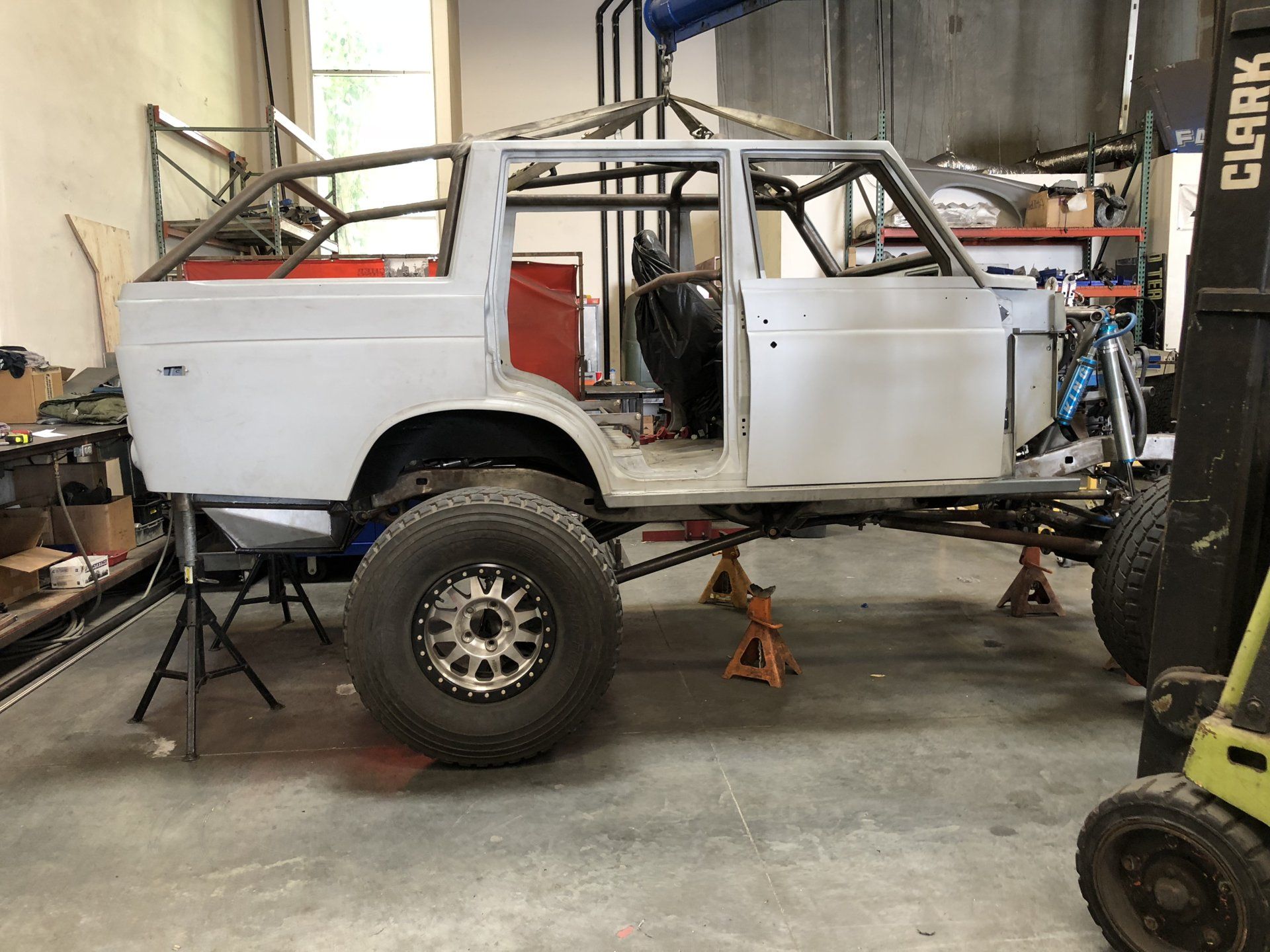

Body back on until it runs.... access panel in floor for fuel/suspension access. We’ll make a nice plate cover. 37” tires might be pushing it with rear clearance. Not trimming!!
I want to keep the two tone scheme, just not sure colors. Not factory. Thinking a silver for the white and a gunmetal type grey for the color...
