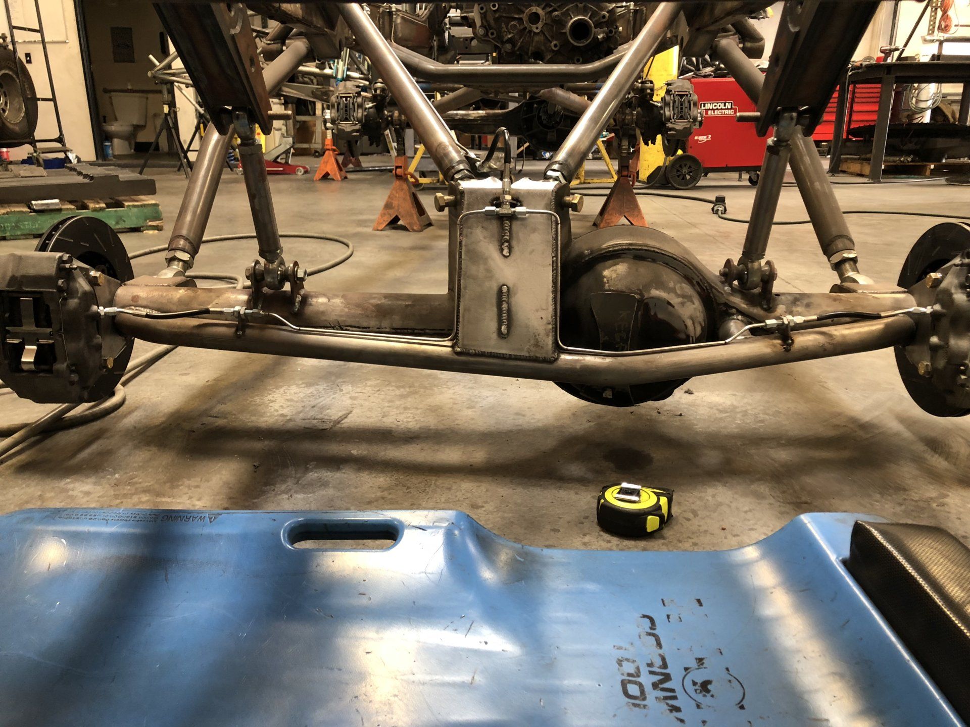

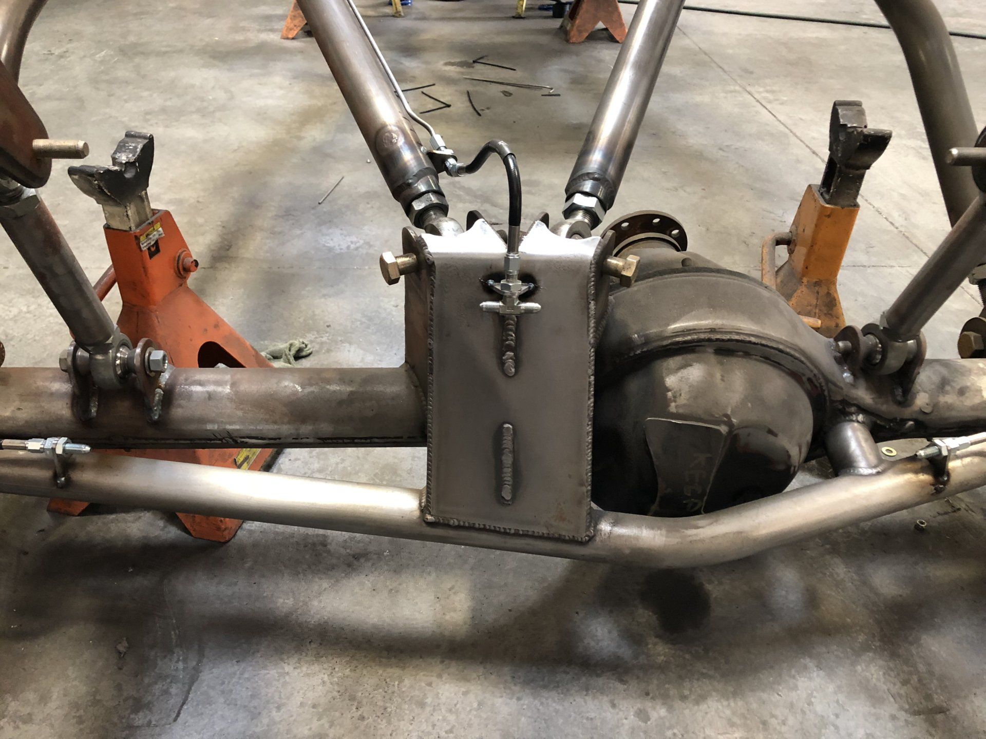

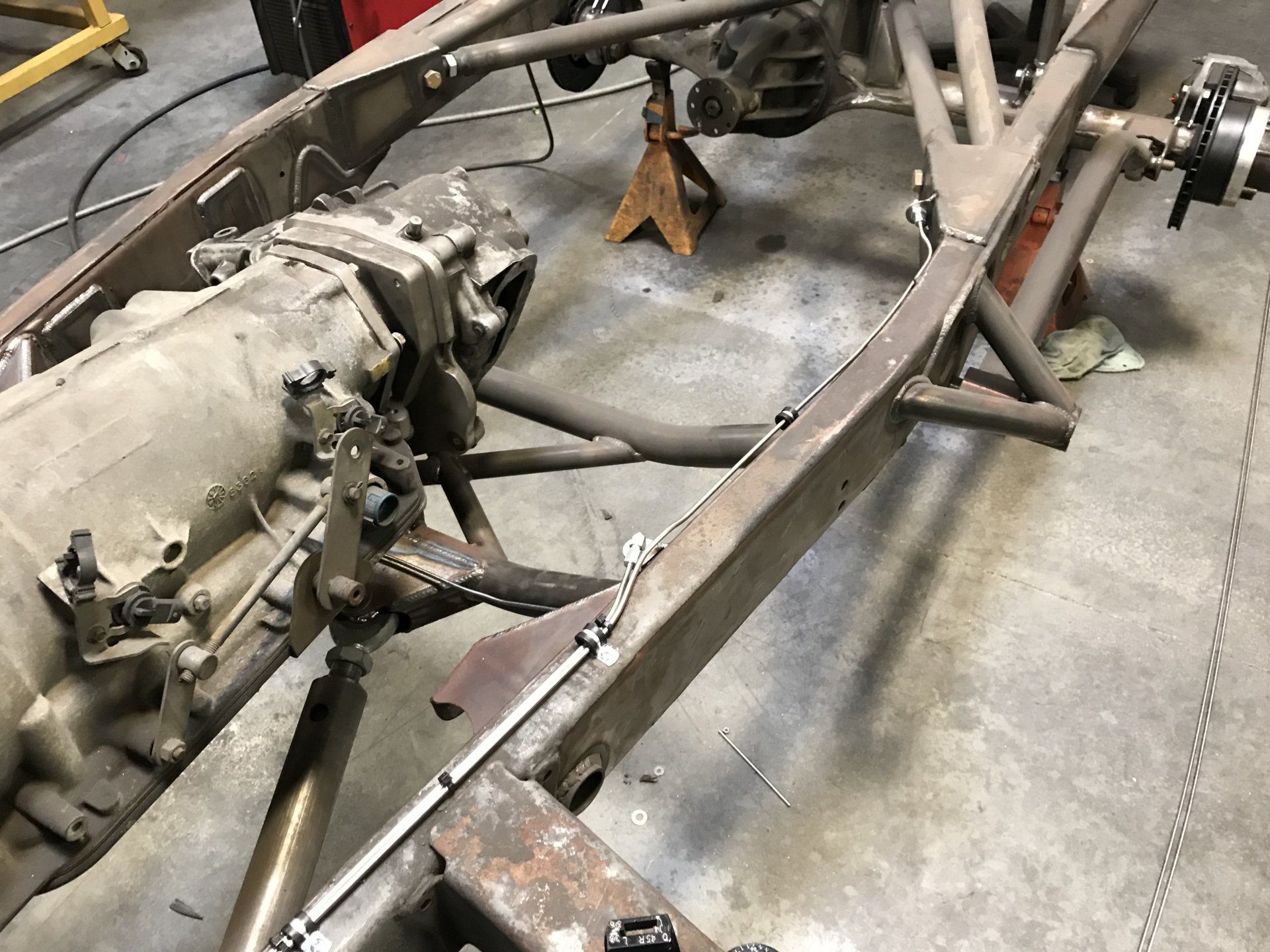

Plumbing has started..
Tidy, what are you using for the flex lines? Kinda use to seeing SS braid on everything...
It's actually had 5 different guys over the years welding on it since this all started. All the guys at my buddy's shop Richer Racing that are doing the fab are a great group of dedicated fabricators that love the craft. I'm fortunate enough to be buddies with these guys. They're used to building Baja racing trucks(trophy trucks), and love the challenge of the "OLD" truck. Hopefully if performs well off road and on.
One day, I’ll be rolling up to the Pig Party in this thing. One of my goals...
The flex lines are rubber lined SS braided. Helps protect them to last for a really long time.
Can I ask for a part/ brand name? Really like this idea as opposed to bare braid.

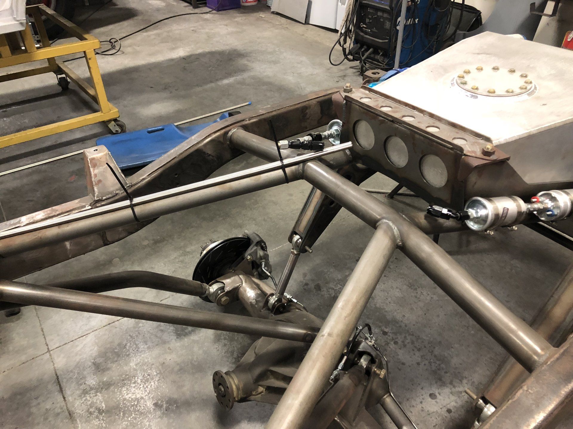

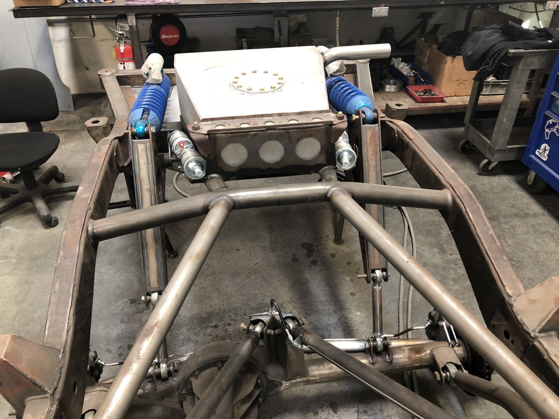

Fuel tank plumbing started. Running dual pumps/filters in case 1 goes out on a trip I just flip a switch.
Pro!
Man that is a lot to tuck up under the load floor, or is that gutted?
There’s space. Im not cutting out any of the floor. I’m putting in about a 2”spacer on body mounts to make room for all the goods....and the 37s/exhaust and whatever else..
