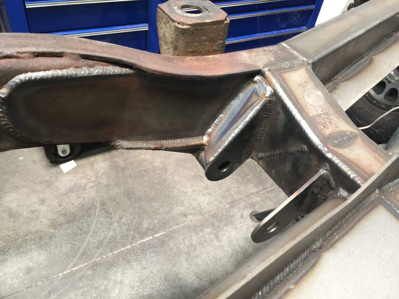

New cross members finished being boxed in. Pivot mounts for cantilever arms all gusseted and boxed. A little each week and I might get there..

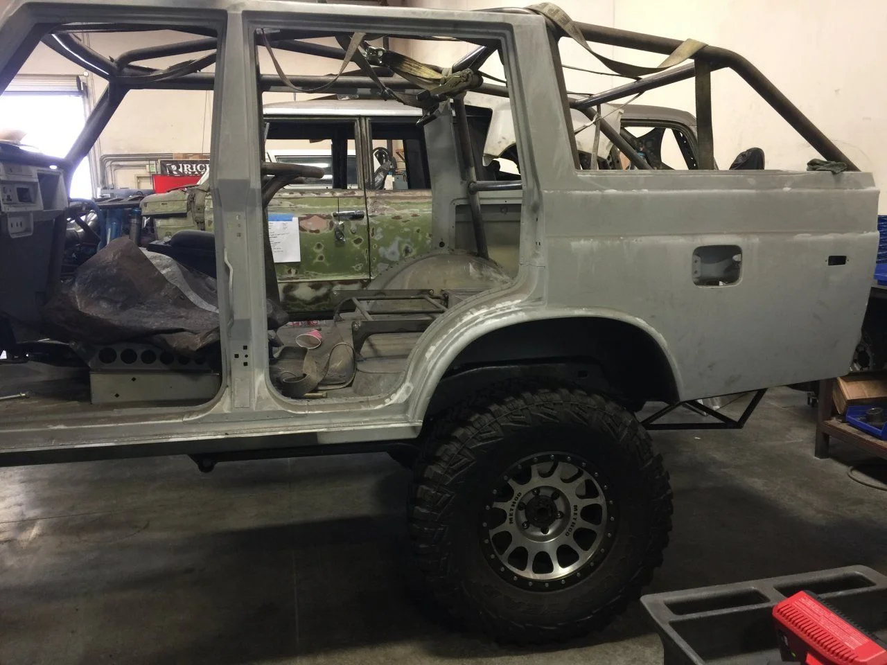

Wow. Been busy with life. Got some pig time finally. Put pockets in tank for spring clearance and some protection below. I'll plate in the spaces on the tube frame. Next filler mount. Need to make a custom flange so tank can be removed. Stay tuned...
Rear all welded. Pulling motor/trans to get front finished. Closer.....a little

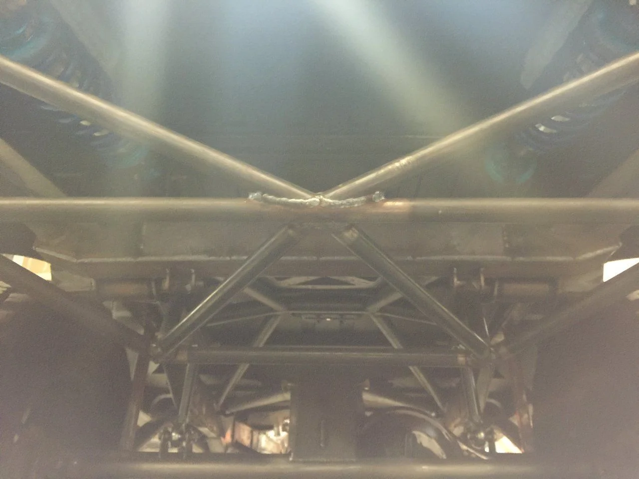

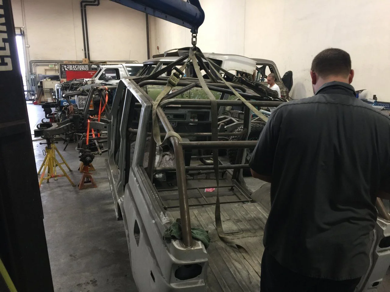

Gonna be odd not seeing any springs or shocks in the rear. They're tucked away pretty good. Now body back on to do tank filler.
