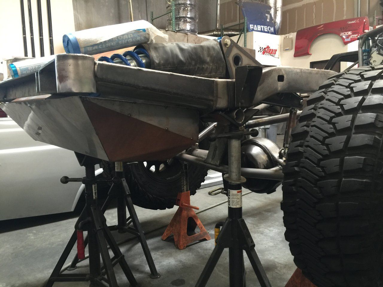

Fuel cell is pretty much designed. Funky shape, but it utilizes all available space.. Approx 25-30 gal. Going to fab out of .190" Alum with some baffles.
Closer....
Can't say I've ever seen a tank shaped like this... Now need to draw it up and cut out the puzzle...then we can figure out actual capacity. Need at least 20 gal.. And it'll come out with the body on..

Fuel cell panel cut out and waiting for bending and then welding.
After that, steering links, sway bars, pull motor/trans to finish welding in there. Then pull body and paint it....etc..etc..etc
