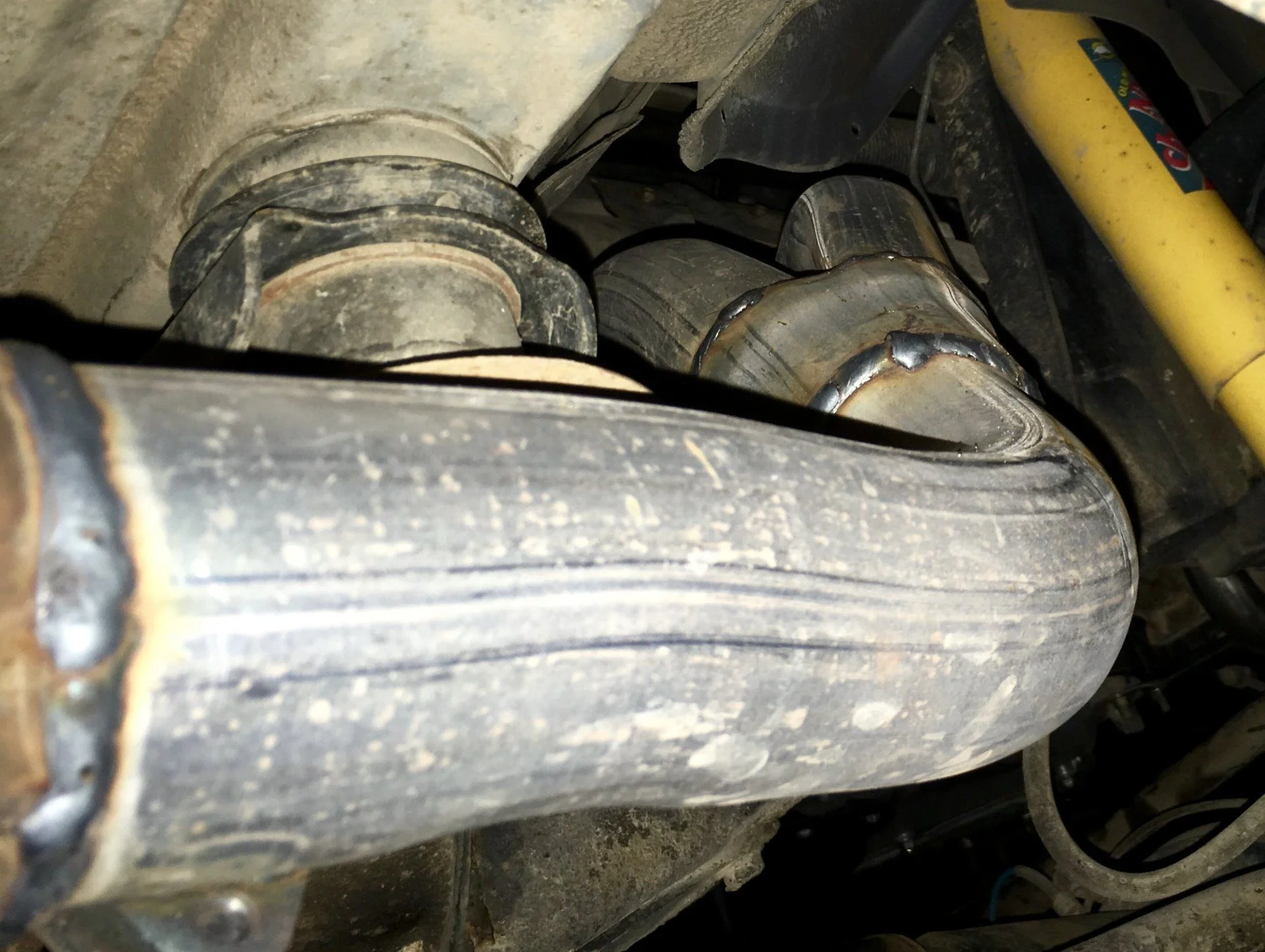

50 state cats and stainless steel. It is a lot of money but honestly a good custom exhaust is another league. Welded together.
Here is my y pipe. Ignore the water spots. The oem and the aftermarket don't open it up like that and the whole system went slightly bigger all the way back. Walker muffler. Magnaflow cats. Sounds a little nicer too.
