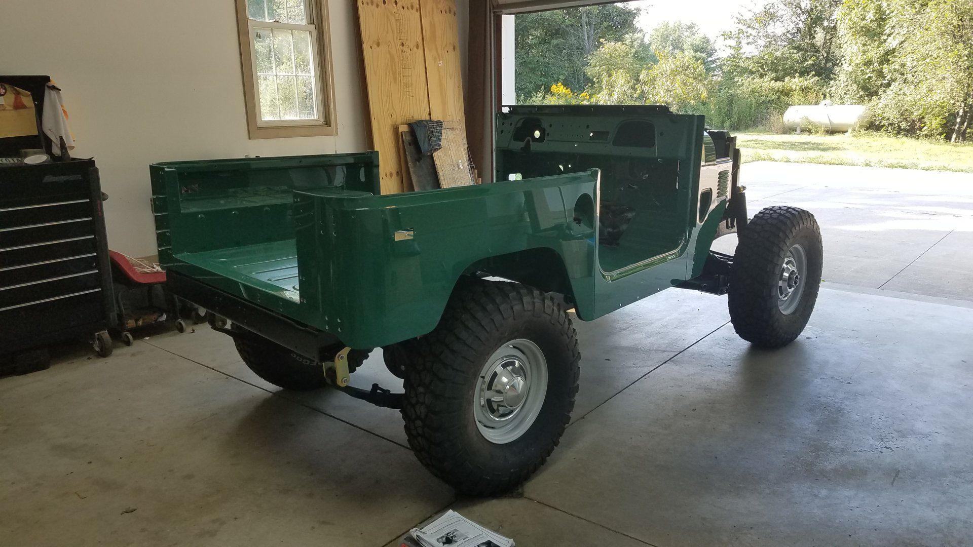

After spending Sunday in the woods, I think I’ve finally got the compressor and alternator in their final locations. I’ll look at it for a few days before taking it apart and painting or powder coating.
Is your Pewter Silver Powdercoated or Sprayed? If PC what color?
It’s sprayed, base semi gloss clear that was matched to the inside of a seat back. The metallic is really fine and doesn’t show in pictures very well.

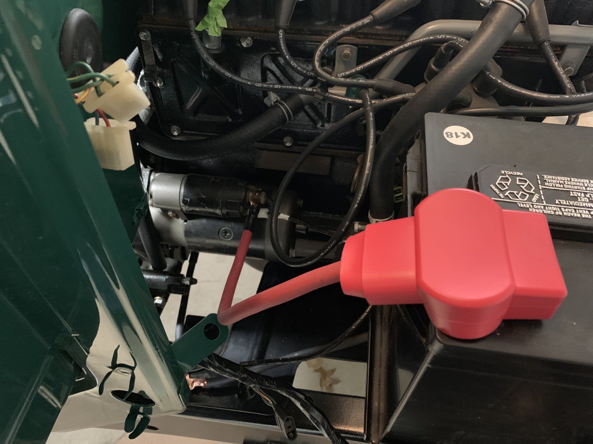

Our plan of attack is to get the engine fired up prior to having the front clip installed. Many thanks to @GA Architect and his detailed description of the parts needed to make the battery and ground cable.
I ran grounds from battery to block, battery to frame and frame to starter bolt.
Power from battery to starter and then the fusible link will connect to battery positive as well.
(Nothing is tight yet, I ran out of shrink tube and it will all come back apart to wrap up AC install.)
Im thinking of having the sides of my cruiser coated in clear bra, have you thought of doing that to yours? Might be a good way to help protect the paint.
That’s a great idea. I wonder what it would take to rip it. I doubt that this one will see anything besides pavement. I envy you guys that are out West and the amount of wheeling options that you have. Here it’s mostly mud unless you drive 4 or 5 hours.
The main reason that we decided on base/clear was the ability to fix any chips or scratches.
You can have the whole body covered in clear bra but its gets expensive. Good clear bra should last about 7 years-longer if garage kept mostly. I did base coat clear coat as well. I like how it makes the factory colors pop more. Another option is ceramic coating the paint.
