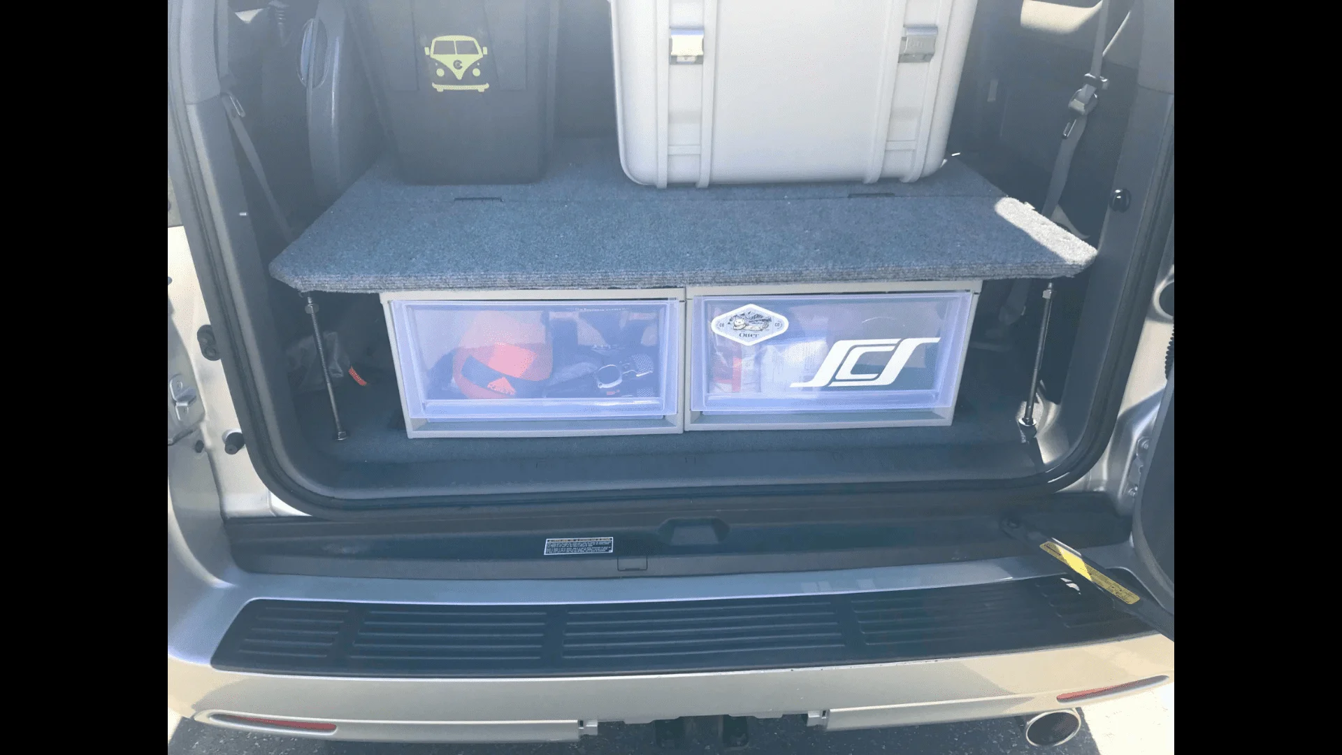

This is a 4x8 plywood top with a 2x4 frame anchored to the rear cargo loops and D-rings at the front seat bolts. Super solid, no rattles or noises while driving. The front 18" is on a piano hinge so I can adjust my seat rearward while driving but still have the full length to sleep on. The legs thread off so I can install/remove the setup fairly easily by myself. Right now there is a few layers of carpet padding and we use the REI 2.5" Camp Beds to sleep on. The bins are just cheap ones from an office supply store but have worked great! I can also fit one of the 5 gallon water cubes under there.

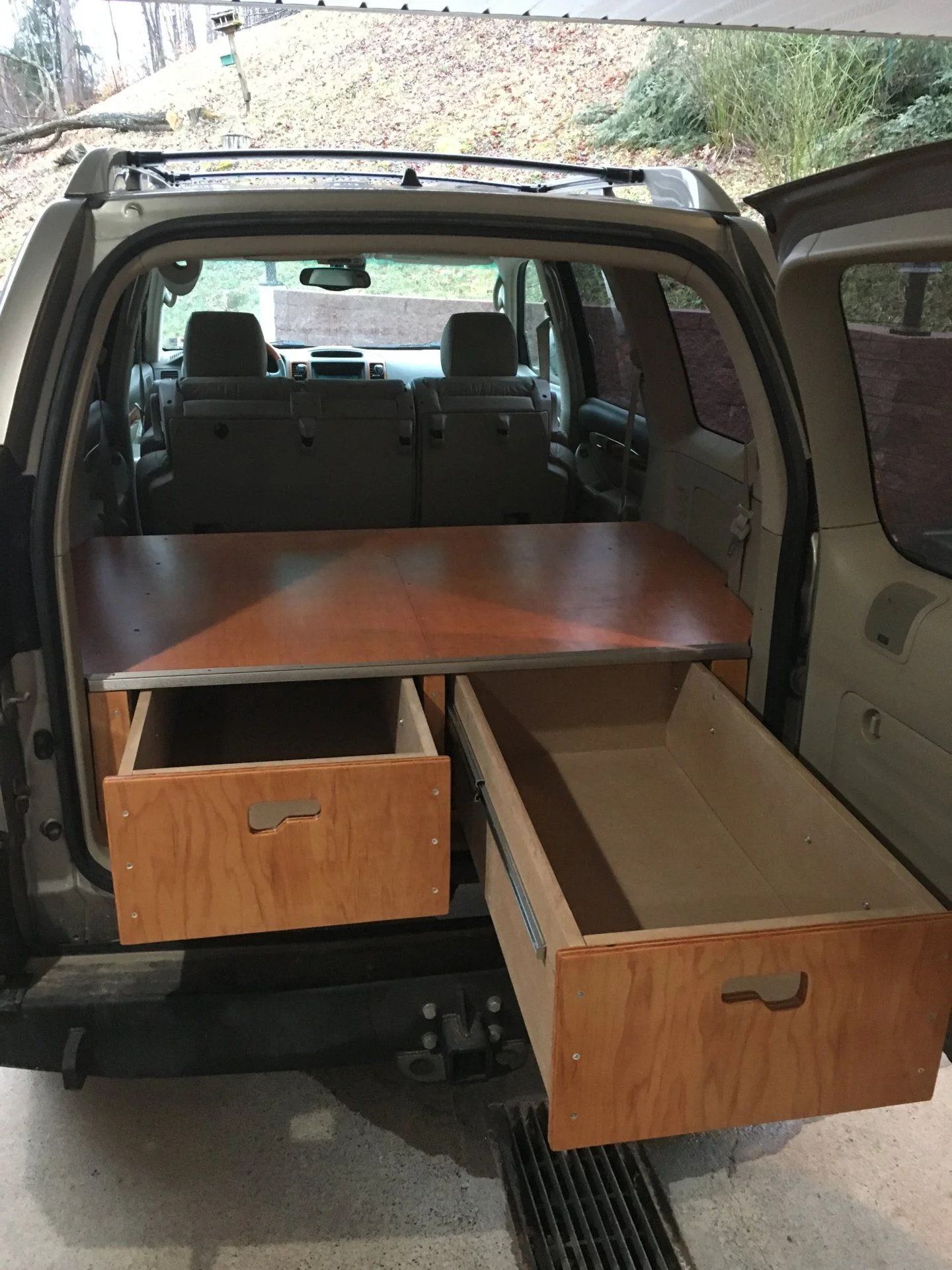

This is what I put in...it has been a great modification and we really never missed the 10" of space. just a plywood frame and simple drawers. Had to lift the dog in back when we had her, but otherwise it was great. Keeps everything organized and out of sight. And those deep drawers just hold everything. We can still load it up with the ice chest (a little heavy to lift in or out but it works) and all of our luggage/equipment

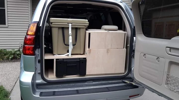

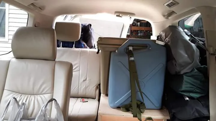

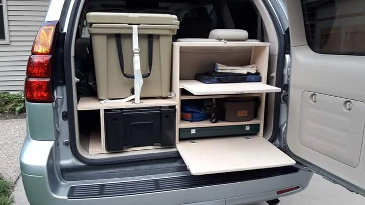

I made a simple one that had to leave one of the third row seats in operation. I have four kids and one of them has to sit back there. Mine is pretty simple. It removes easily and attaches to floor using the cargo hook bolts with a simple bracket. It holds two Front Runner Wolf boxes, has a built in chuck box for all of my camp kitchen needs with drop down table, has mounts for my Orca cooler and a water jug. With cooler and jug removed works as a single sleeping platform.
I like that portion behind the third row! That is pretty clever and useful!
:cheers:
Thanks! It was an extremely tight squeeze back there. Had to plan to fit equipment where the distance between seatback and rear door worked. Very happy with it. Was going to make that piece removable but added more complexity and would be less solid. Survived a two week trip across southern Utah and the Grand Canyon.

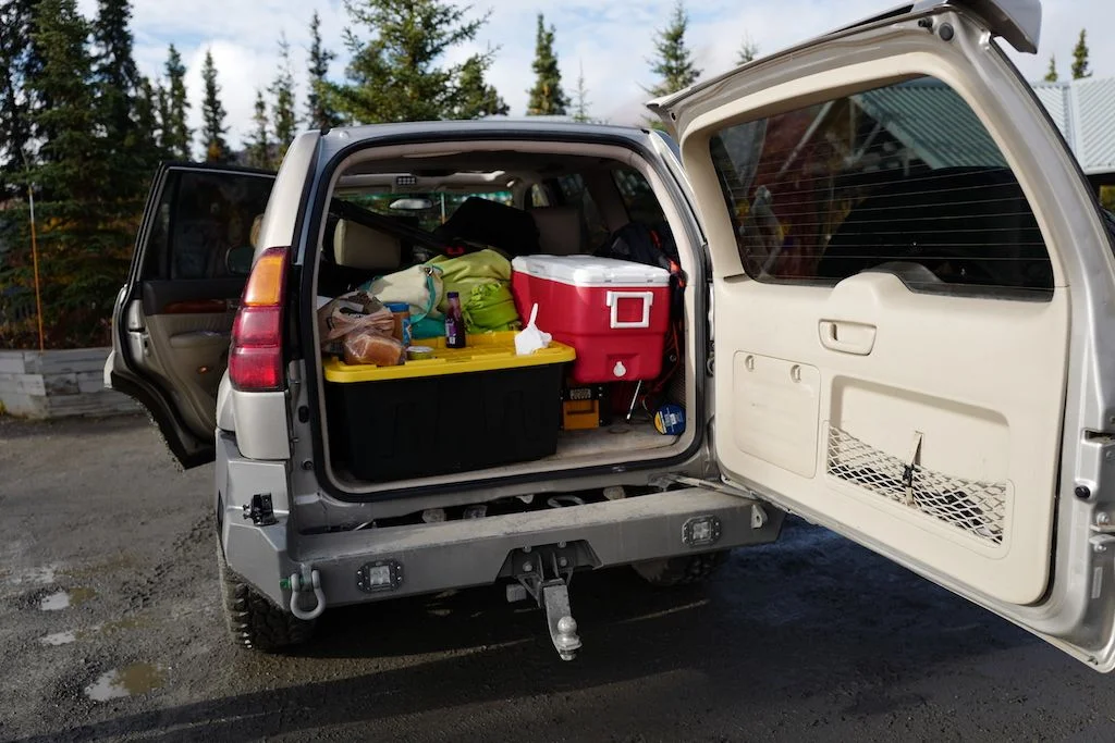

not drawers (yet) here, but a rack so separate cooler/kitchen from the (current) junk show of gear, bags, cloths, stuff...
most soft goods (tent, sleeping bags, pads, chairs, stuff) go on the roof (box, or in drybags in the basket)
junk-show version that prompted a rack build
BQX6B6N1ogqxZ5He_YSwH9t64XvLCAmlsXCpVTI5_l4L85I6MDgTUdb-_BGX2ypdfkz9Bqsi3QFQ3kyk7flBFaPg8W4XQG3lIYg-qV_V4Bai7IOnUxBD5i-c4eEBBDZj4kvzj5bRVePY9IBbm9WkcisamvDkVHMin72dJcNPEJENsXxtjPYRmhUlNyZMSY6uv9Wiis3o5po0z7k8L_-TStU95NkAOHm3MK5eIwJMl0Z4iaYjCu_EMMm4OdyMJTwT8MAI7UJDP76lN8wOnUuAq6YlzkCiyo2czC3-NaumDdSR5L4-PASWARwTwqGaH7H38SH8a5b3oPG4IKPsqp5L6DOZk3aCFWJoxJI4msvlsWm9DkWxtTxq5qVh9pwXKGafRojI1OLWubSgPU8fOXFJORHdBnDECS5TWzq7s-nJJ8j2Vb6jMk9YonFIPF_tWBXqsp6TN9EkDbUYkyR7q5-MgmcjdfkKutXWNYl8pf7JsRDg42ELDm-GMkTtUHnqM8NGdroxuCIc52fB_EXNLZBwiSCRlCDEGIZOQ2XDgD-qxfJocAdlLvRLYodujWj__nEwVJe4H6PmbId9VCQebxTgXA7yHL1mBUjEOmhtnItRERwUkQMPqB9SyTNXq2dU5KxNx1W4EOgKKNdBOjQN1Lec4u_jFraZ_XdxJxtkTssTycOcWGUqilD4dHgcKw=w1251-h939-no
full
which makes it nicer but certainly less organized but is not mounted in the hatch...
stSy_AxAC6WZQUufYOpihY-3jl5Dercx3hulNwr4-4D7ucbblRDHYSxX7hYh25GNFRzjUJqysJVvKp4po7x0JACFYP-5ADsU3qhlJcDSHbCo1Z0f3ml8TglfHP57Gt-goHymnGtXsgs6nIxvjzmzKKb7beqaM32kEMzF-0FC9pCPrKJjKJK2Lap0ld_t-RVkwZ_7qFMmd-tgnmqzIaqfS0NwmHhyAsSS2VXzE4aSDKgZHCPbVCFYbY8UeA4NZlWJqmDR44RNmnZwKd-xUy13jeDsuVzClMU-PjKuZj5FfcKvZpJ_4hesUfDGLXEe7iPb04gXxw6TVa-05dULTsdhdRDZHrLBU2bb7gc3YArq1LG7qh7YjPTRp-yJ6dLkZHmeX0XLN29wvmTMdANbLPmQegdBYQsJwxEPyjyztHi5k2W2ACeza9fUiiYCUphrOlG44a9bbjX6SS9sJDGoFf-XgfnpoW0_GS_Gw1hjONijz72sYPqHGsVim5mII1FEoXIKo_7DagnpoEEutviNrsP28bfUc9aVus6TzGp2qtLl0WsYybV78VLYVmu-DsvUTN6jCS5hVGrpcpx0IrqIx7MUUZOVXs4NbBc2tXdeCB_HWpayDFO5gFvl06_fuxouy-_haSt9eWRYaq68Z4-H8d219EZ7pBwTB3t5VPezmXd5YlZXg3VbpJuHVNsqaA=w1251-h938-no
