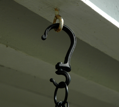

Just an IDEA, but you could secure these to a seated area easily. Get a couple of the circle head bolts used for hanging things -
4 to be exact. - Cut the circle into a hook by removing a little bit of the circle. Then measure the farthest point of the chair anchoring points. Drill the appropriate distance holes and use the newly fashioned hooks to attach to the factory mounting points. Secure with Nuts and washers.
Hope that makes sense. I am not always articulate when it comes to my engineering ideas. Basically you are reusing the factory mounting points with a couple home made hooks. Just make sure you buy large enough diameter circle head bolts.
the tension made from ataching the hooks should make moving around a NON issue . Also, you would need to (once mounted a couple times for fit) cut the excess off of the bolt end.
