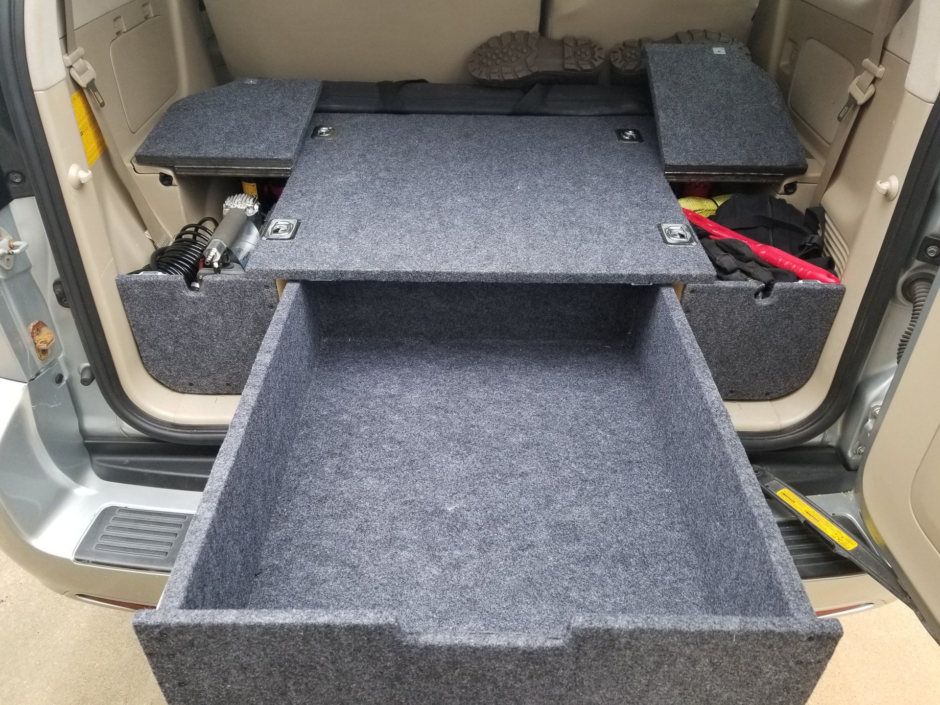

2 x of these from Home Depot. I wanted tie downs that tuck away cleanly so I could easily slide things in and out without getting hung up.@NJGX Where did you get those flush tie downs? Great looking setup!

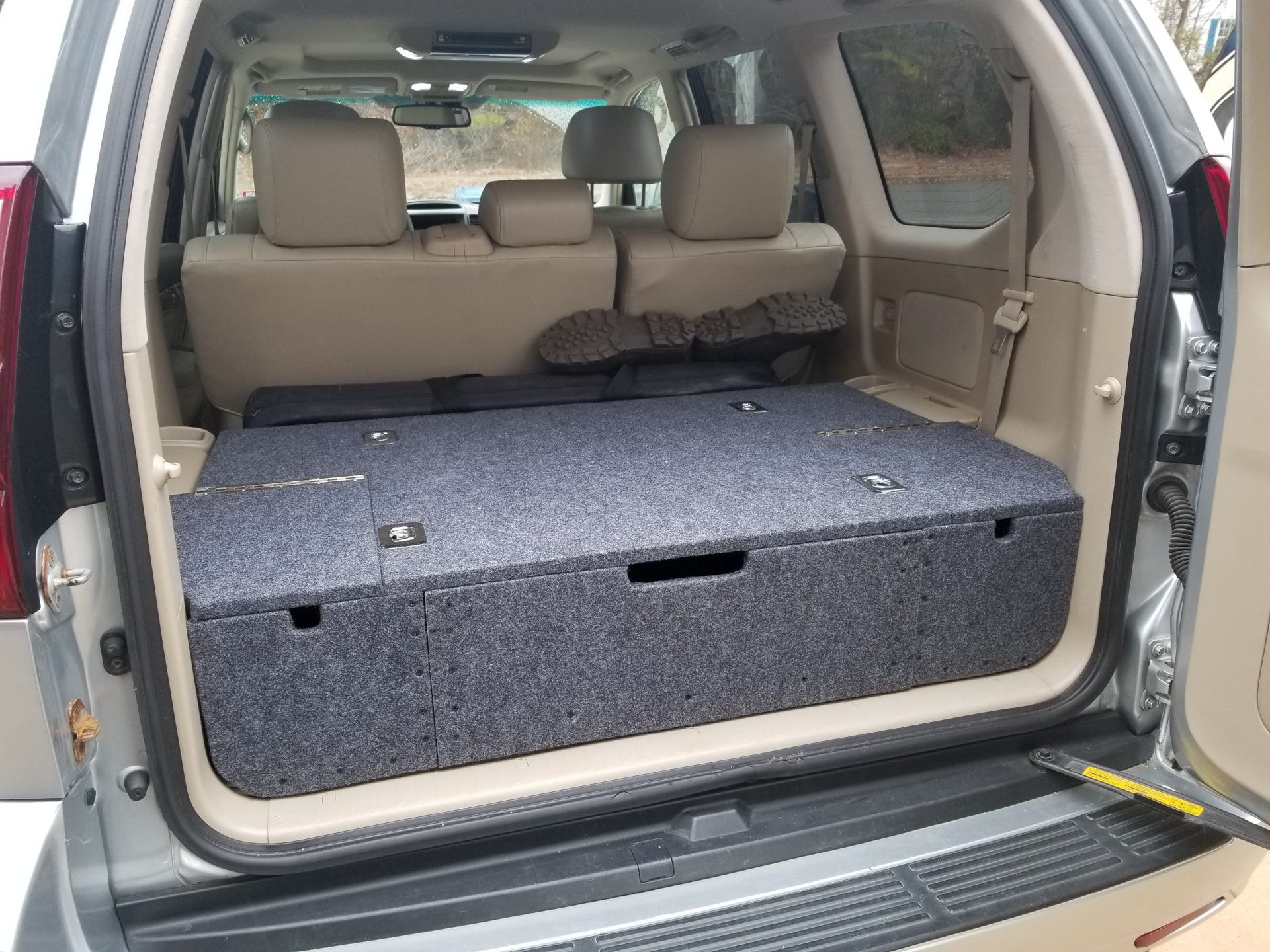

Hard wired and bolted the compressor base plate to the plywood floor. Got tired of popping the hood, connecting the clamps, and unpacking/repacking the compressor bag whenever I needed to air up. I just leave the hose and gun attached now, so all I need to do is hit the switch and I'm good to go.@NJGX
Is your Viair hard wired in that location or just sitting there in storage?

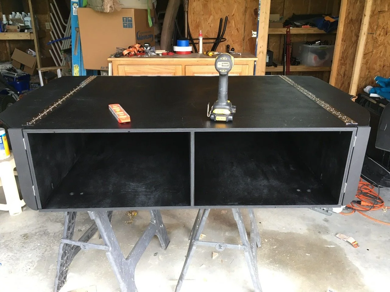

3/4" ply covered in speaker carpet, 1/2" ply for the "floor" piece that is secured to factory tie down points, recessed tie downs, and cabinet magnets to keep drawer and side hatches from rattling. Angled forward section so second row seats can recline and recovery boards have a spot to slide into. Side compartments house air compressor, tools, recovery, towing, and emergency gear. Center drawer for any other larger misc stuff I want to keep covered, as well as my fire extinguisher now. The whole platform sits level with to back seats when folded down and 3rd row seat mounts.
