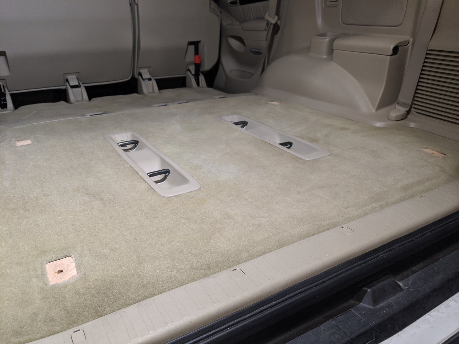

I used the tie down nuts in the floor to bolt in down.
Thanks! This looks like what I am working on... Did you just counter sink the bolt head to not interfere?
I took a pic, not the best but you can see one of them.
Nice job! I cut all my pieces today and before I assemble it wanted to get a clear picture of how to bolt it down.
3/4” pieces of plywood fit nicely after you remove the factory tie downs. The bolts are M6-1.00 and the heads are fairly thin so they don't really hang up on anything.

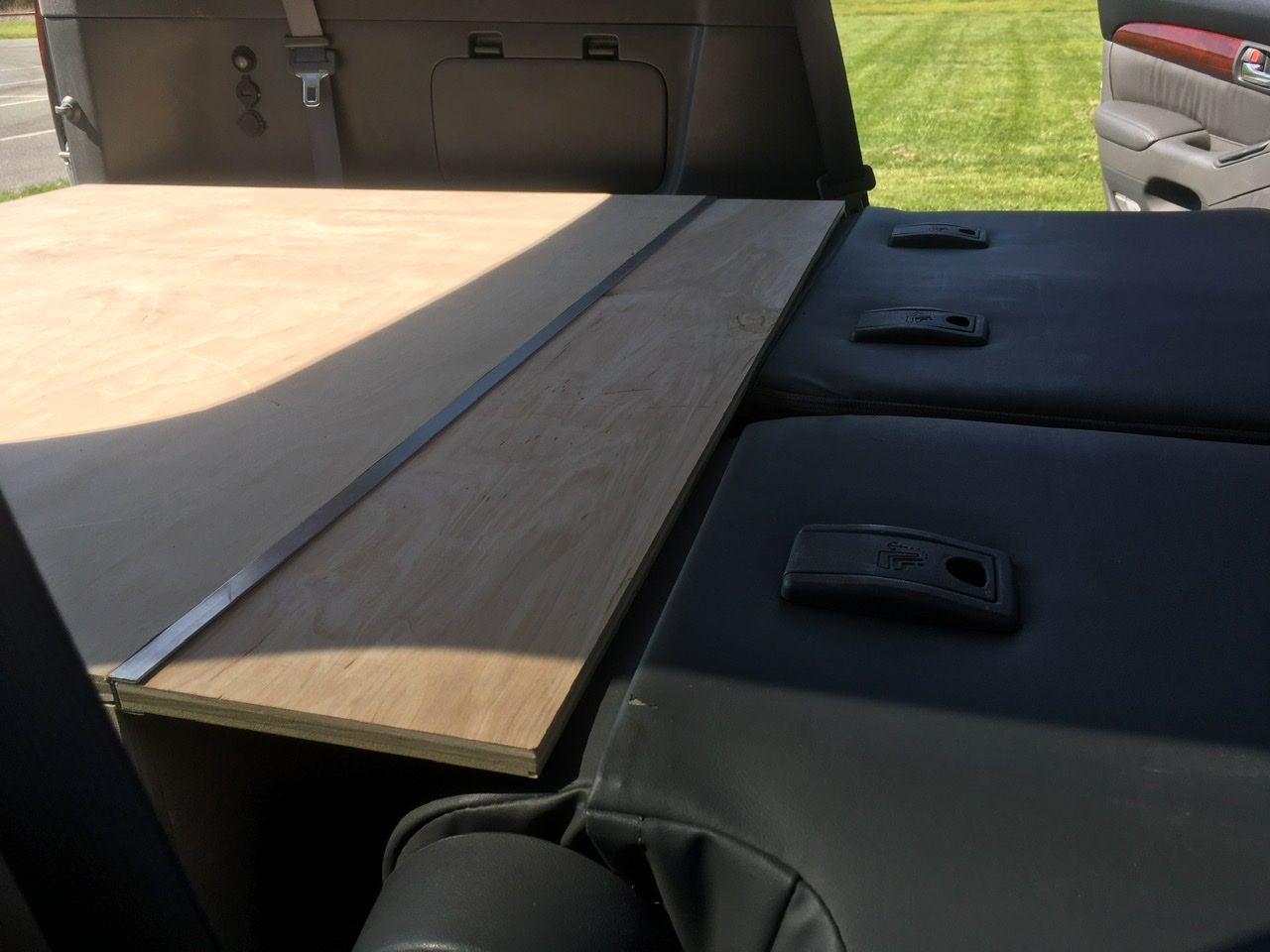

getting there...
Nice. 👍 My wife is too picky a sleeper for any gaps. LOL
I will have to fashion a way to keep it in the channel so that it won't slide out if kicked.
Also still working on the side panels. I got some piano hinges and will use those to make it more accessible. But they will need some support added to keep them level as well.

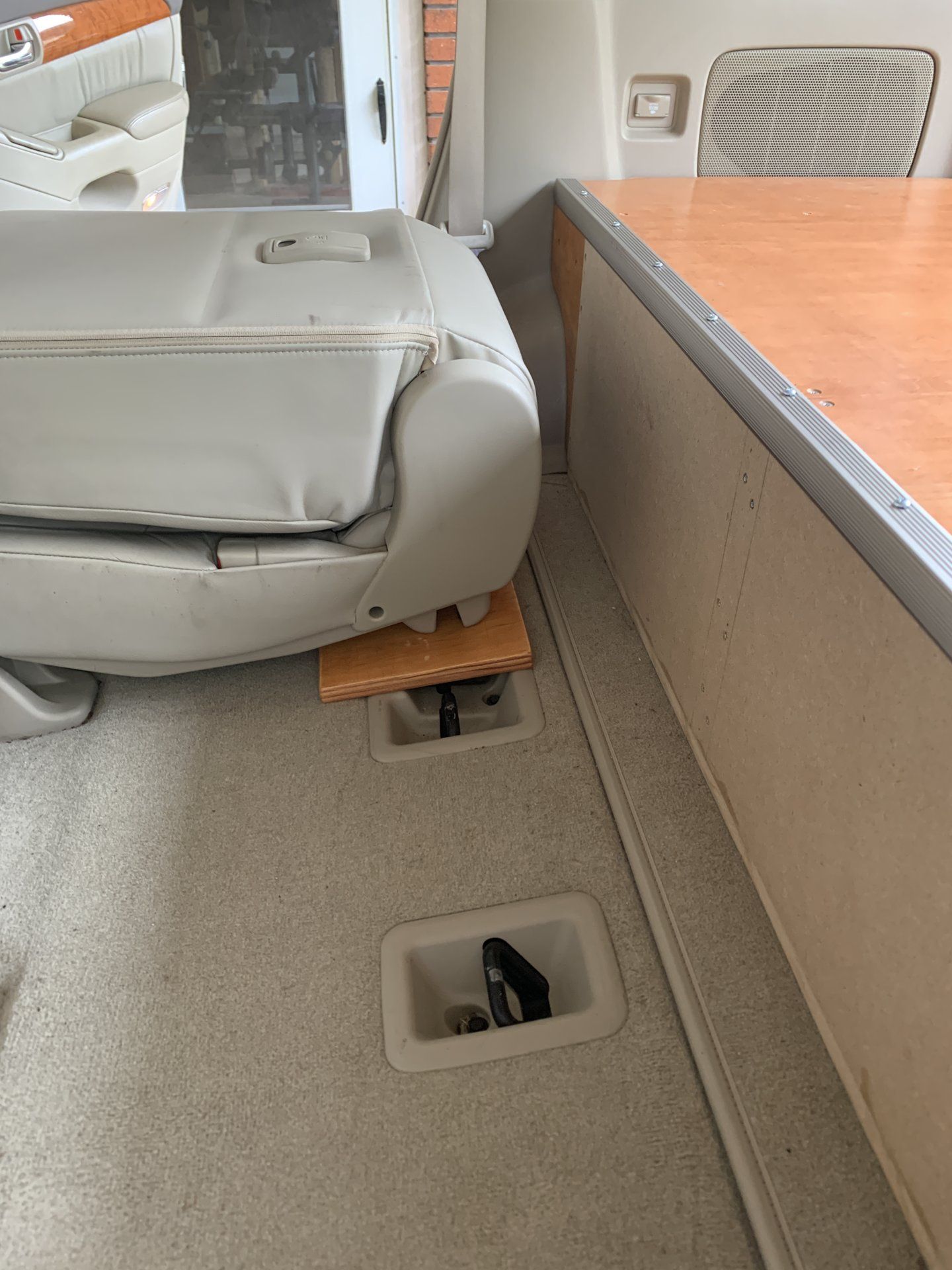

I drilled each of the four spacers with a 1/4" bit. You can drill them larger to make it easier to align when installing the base. The spacers fit snuggly into the carpet and I just leave them there.
I used a couple extra pieces I had left over and they level the seat out with the box.
The gap doesn’t bother us with my mattress’s.
The spacers fit in the drawers and don’t take up much room.View attachment 2272530

@yeos got it so the bolt still goes through the bottom of the drawers. I’m just going to copy your setup for the mount. Thanks!
@landwagon Your seat prop idea is perfect! I just modified it to still fill the gap much less cumbersome now.

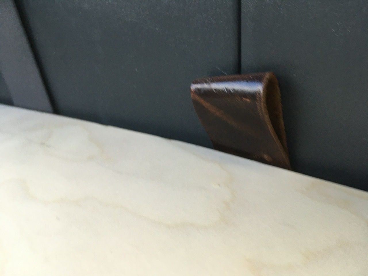

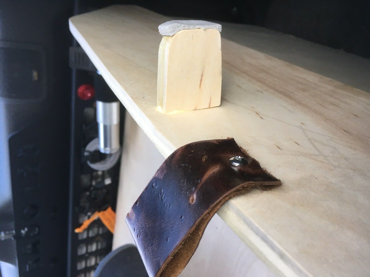

getting fancy, leather pulls for the sides. I’ll add more details in my build thread. Bedliner got done today. Pics tomorrow...

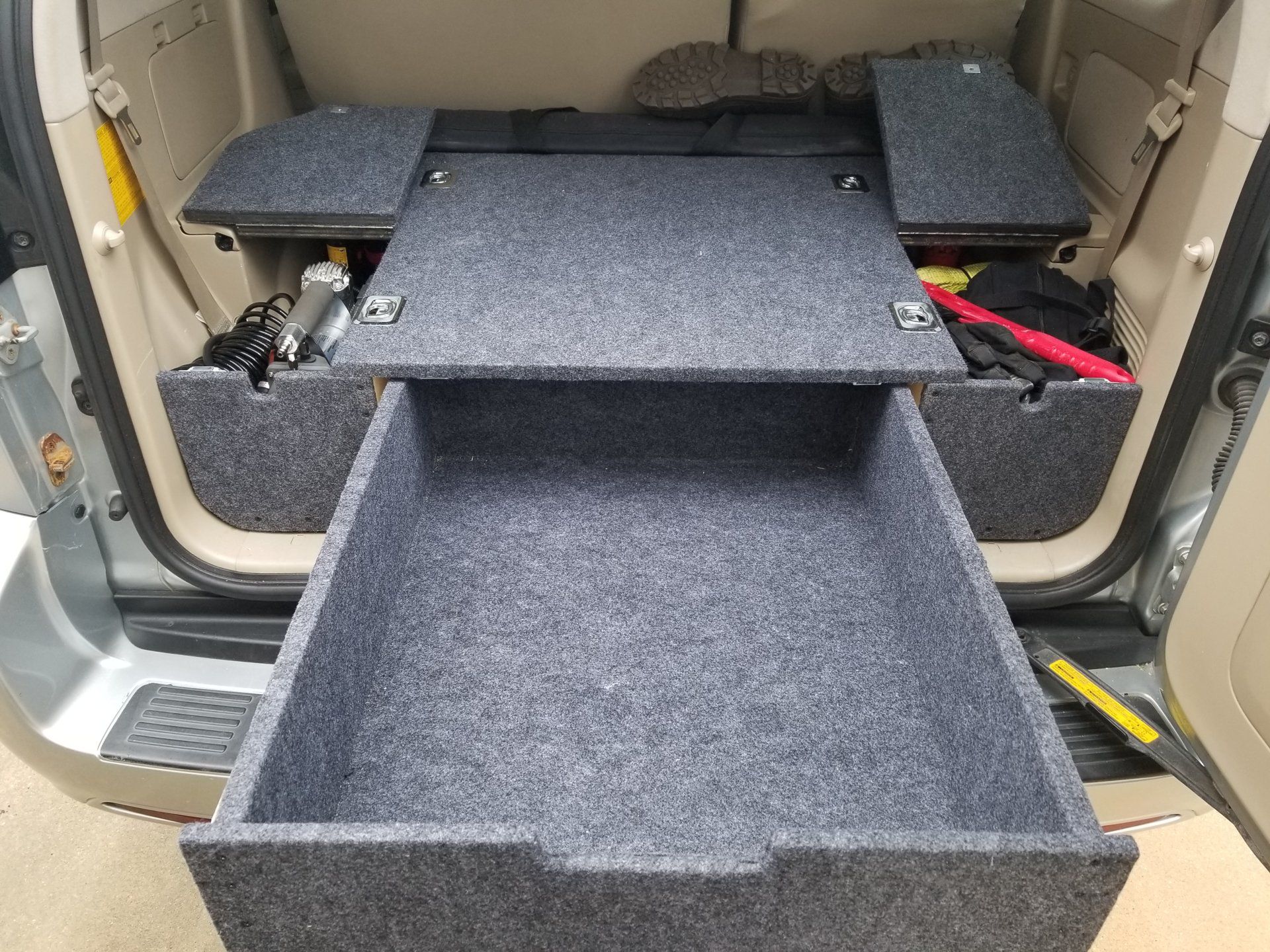

3/4" ply covered in speaker carpet, 1/2" ply for the "floor" piece that is secured to factory tie down points, recessed tie downs, and cabinet magnets to keep drawer and side hatches from rattling. Angled forward section so second row seats can recline and recovery boards have a spot to slide into. Side compartments house air compressor, tools, recovery, towing, and emergency gear. Center drawer for any other larger misc stuff I want to keep covered, as well as my fire extinguisher now. The whole platform sits level with to back seats when folded down and 3rd row seat mounts.
@NJGX Where did you get those flush tie downs? Great looking setup!
