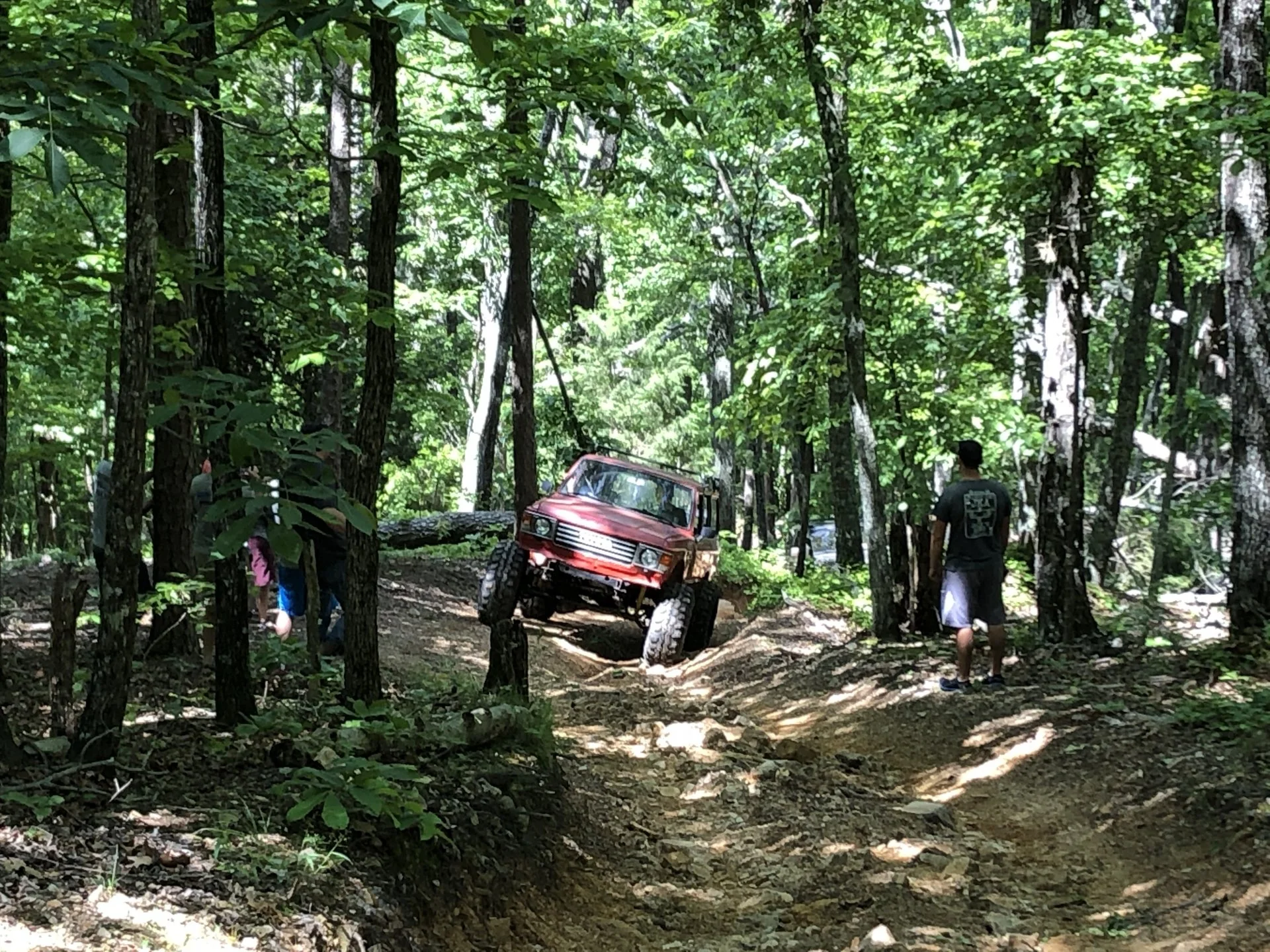

I see a 100 series on the trail behind you so it couldn’t have been that hard :flipoff2:
you going to Gsmtr?
Yea most of the stuff we did wasn’t very hard. That first video was the only hill where I ventured off from the group.

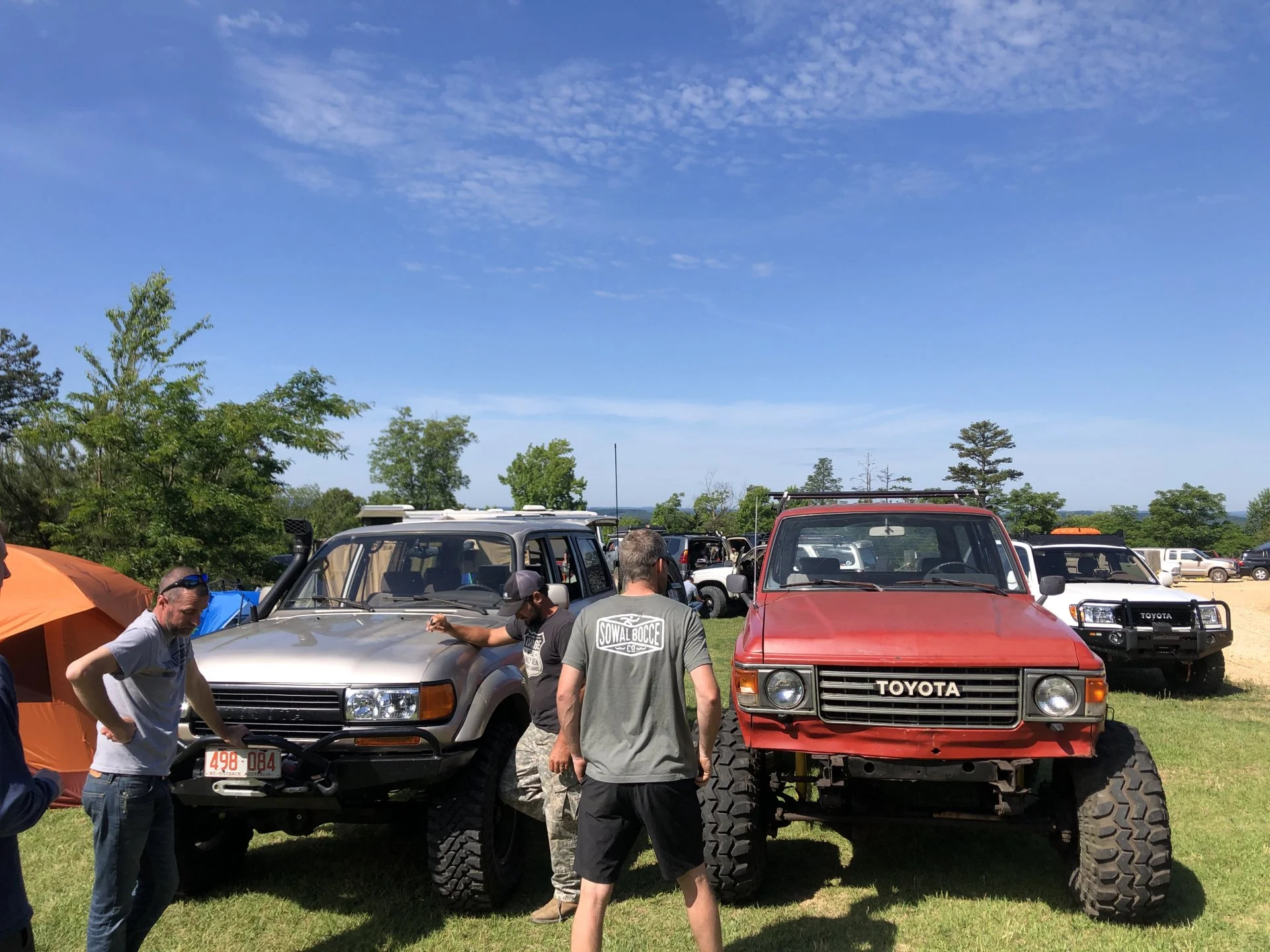

Somehow that looks wider than moonshine. What offset/width rims are those?
We have to do a day together at gsmtr. That thing is amazing. Full widths under 60s are a match made in heaven.
I haven’t measured them yet, but I’d guess 2.5-3” BS. They’re 15” wheels, so the offset makes sense to clear the calipers front and rear. I still had to grind a bunch on the new ones to get them to clear.

Bad Ass rig.... made my mother's RAV4 look miniscule. :lol:

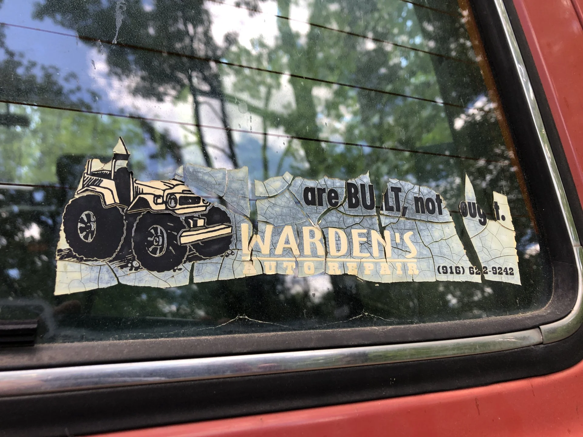

Bonus points for the old school Warden's decal.
Great to meet you Cole. :cheers:
Great to meet you as well Onur, thanks for taking some pics this weekend 👍
