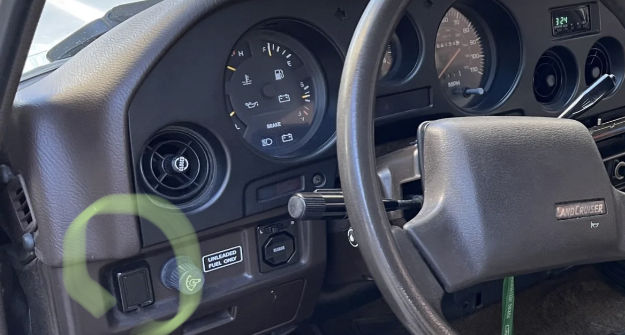

The other opportunity seems to be this spot. If/when I add a ham radio I’d like to add the faceplate there, in the ashtray spot, or maybe the cubby under the single din radio. Worst case on the ball mount I already put there which isn’t too terrible.
When if/I add lockers I’d love to find a smaller power window switch for this small blank and then add the Toyota magic dial where the current window switch is.
Sorry for the nerdery. Just thinking outloud/dreaming.
