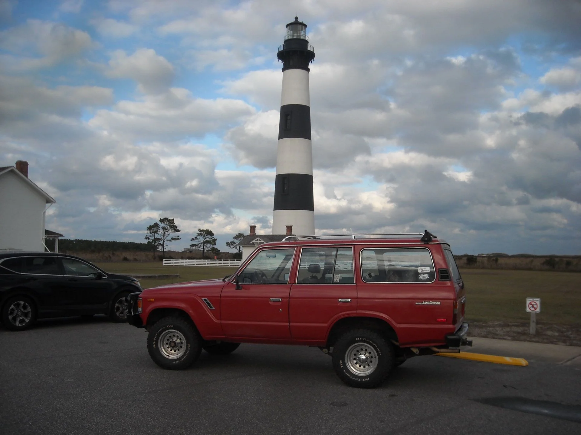

Great write up. Nice attention to detail putting this truck right. I'm a bit biased toward red myself...
Pea Island light house south of Nags Head NC near Oregon Inlet.

Strange looking license plate you got there. ;)
