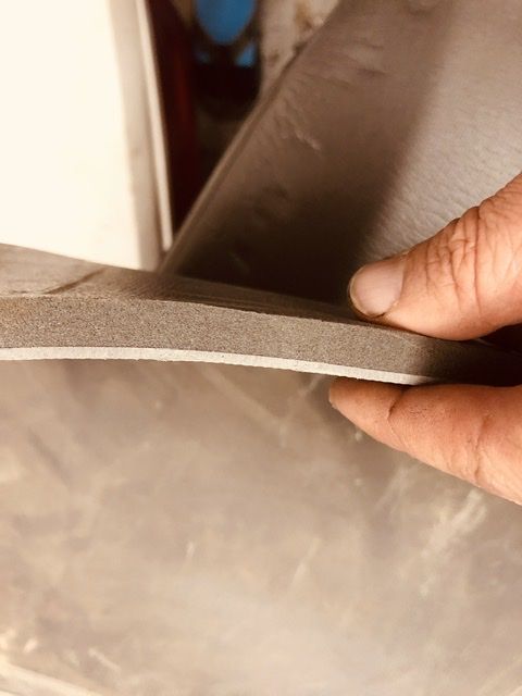

Pretty stoked on yesterday’s project. Kind of following Joey’s lead on underhood lighting here, but also adding some sticky foil backed foam insulation before attaching a new OEM heat shield (with 12 new hood insul clips of course). The foil backed stuff (sorry I forgot to get photos) does a great job of keeping A LOT of sound in the engine bay as well as reducing the phllbbbttt of the sheetmetal at speed (most of that is fixed by re-glueing the hood skin to the spars underneath, forgot photos of that too :/ ). I just used “The Right Stuff” rtv for that part, instead of the expensive (and very nice) 2-part adhesive Joey used, but it should last just fine.

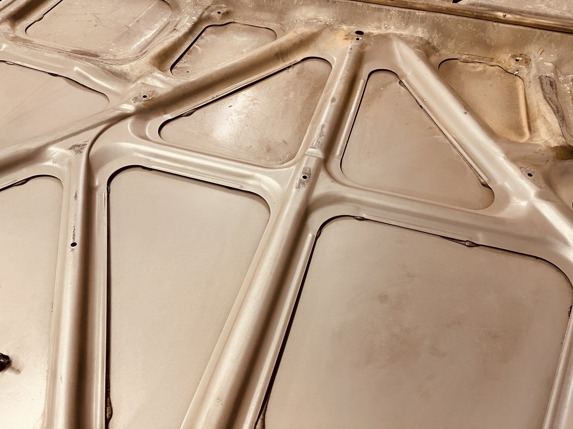

The BEST part was adding the amber Baja Designs rock lights though. I chose amber to be a little easier on the eyes at night, I even considered red but figured that might be a little much. Drilled some holes and set some rivnuts to mount them, will be very solid. Made a little harness and ran it through the hood spars (considered just taping to the foil foam but felt like a challenge for some reason), now I just need to find the little grommet he used (maybe he’s going to sell them??) on the exit hole to finish it off (will be easy to add later since I used a deutsch connector and can just depin/repin whenever). Finally, just popped it on the SwitchPro mount right where the wire comes out of the hood and was done with it.
So stoked. With the switchpro I have three brightness settings, and during testing last night the lowest seemed plenty bright. We’ll see next time I have a night repair (like swapping a radiator in a parking lot on the first night of a week long trip). Will be nice to not have a light dropping on my head! There is also now a very satisfying “thunk” when shutting the hood instead of “tWaAaaNg” like it was before.
ONE HINT: don’t lay the hood upside down when glueing the skin to the spars. Have it standing on an edge. The weight of the hood will not allow the skin to relax into its natural state and you’ll be unhappy when you flip it back over. I didn’t have this happen, but can see how it could happen

-halfway through cleaning underside of hood
