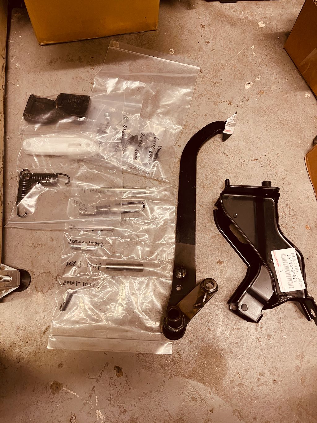

I meant specifically the clutch pedal, bracket and other parts. Maybe I didn’t look hard enough but I didn’t see them on their website.
oh gotcha, got all that from japan4x4, was super quick.

Awesome. Could you post or PM me all the part numbers to assemble and mount the 80 series clutch pedal? Only the bracket part # is visible in the photo. Thanks
