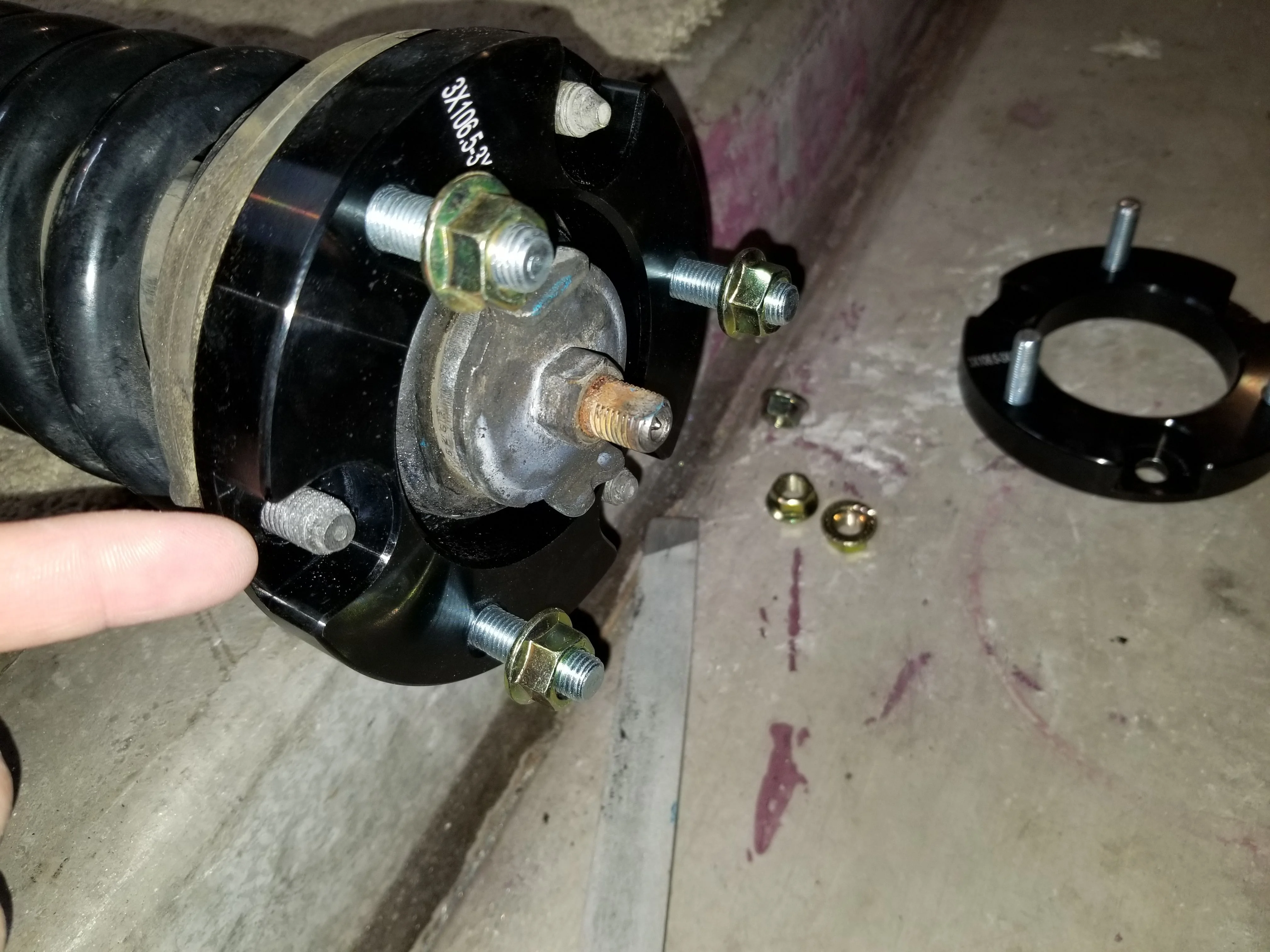

  2. Found a local used black bumper cover - will be researching how to prep and paint it silver. Front suspension apart awating 1.5 inch spacers to go on top.
  3. The adjustable dampening controllers were not easy to get out, broke both of them that had seized bolt in the back, stripped one out. Put back together with epoxy....

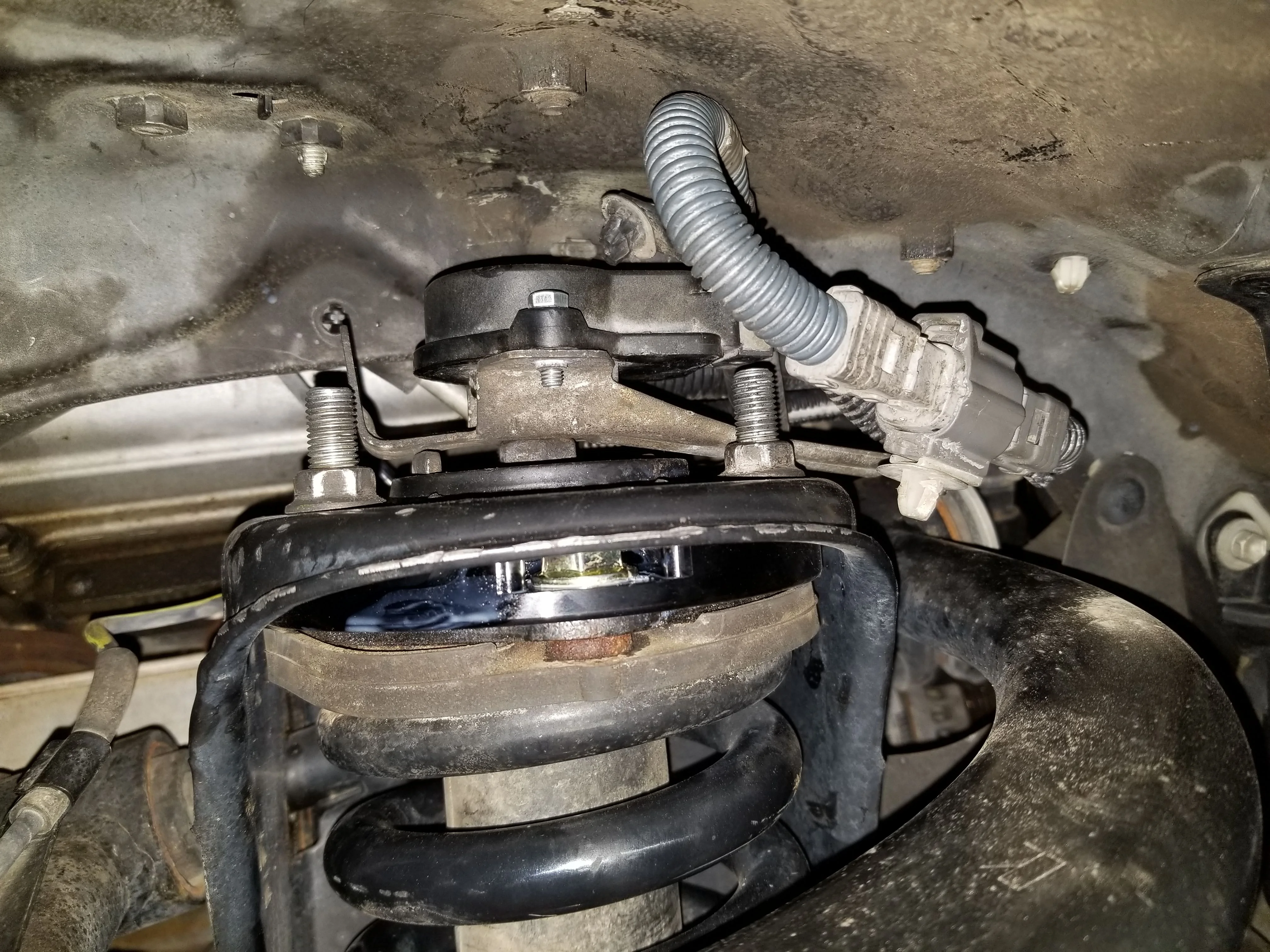

GX needs to be aligned before I start putting things back together. Before that happened thought I'd install 1.5 leveling spacers to give the front a bit more clearance. took a wire brush and knocked down some surface rust and primed over it with rustoleum rust converter. don't know how effective it is, but rust wasn't too bad to begin with. (mostly a southern California Lexus for 12 of its 15 years). Those suspension dampening controller modules, as reported by others, are a pain to get out. I broke both mine as can be see by the awesome epoxy job above. (all installed and still work 👍)
Some thoughts:

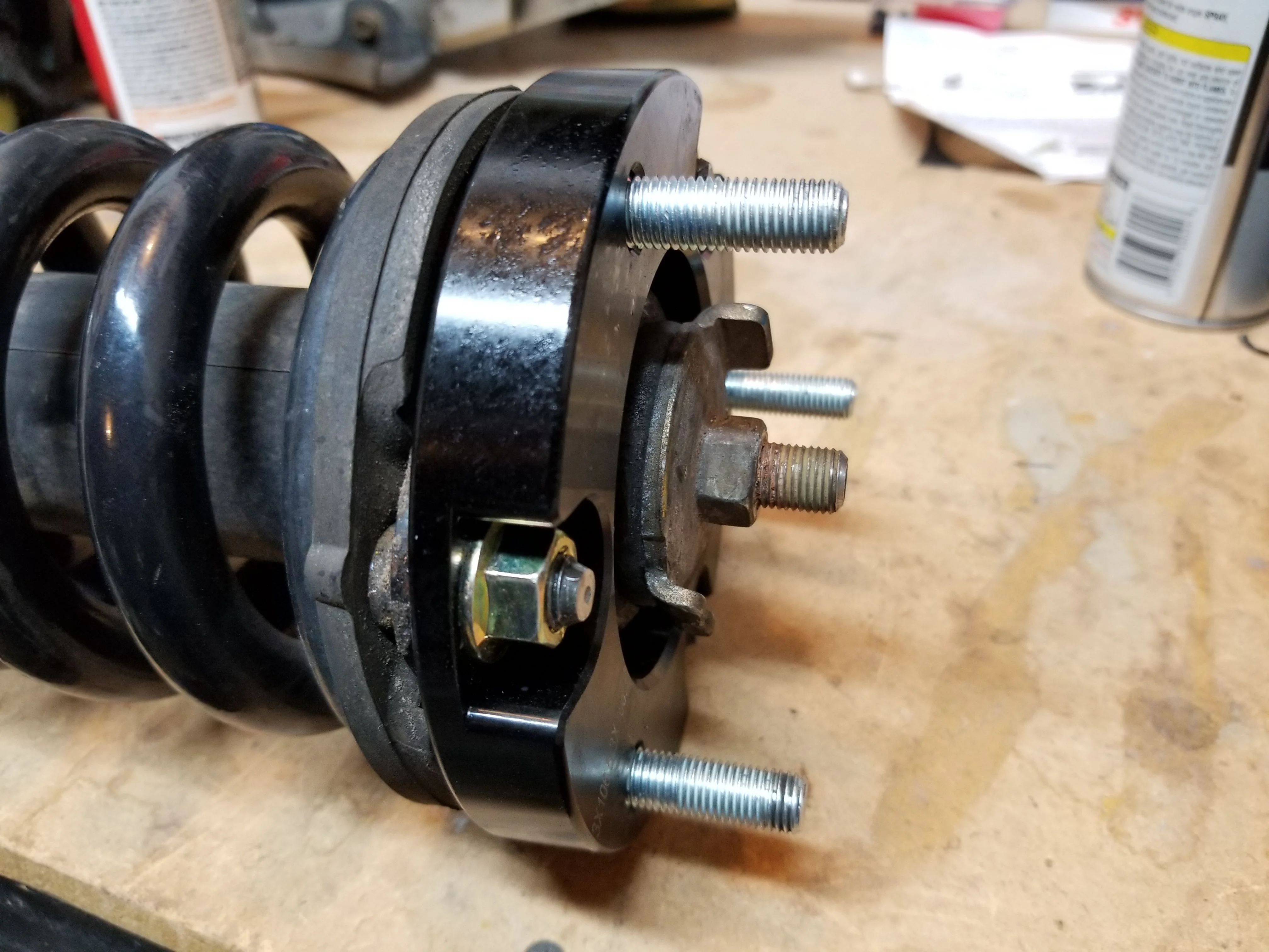

  1. Someone gave an idea to replace the tiny Allen head bolts, holding the dampening control unit to the bracket, with regular 4mm bolts so you could use a socket - turned out to be easier, but only slightly.
  2. If your spacer is 3/4 inch thick or thinner, you'll need to file/grind down the three studs on the shock a little bit.

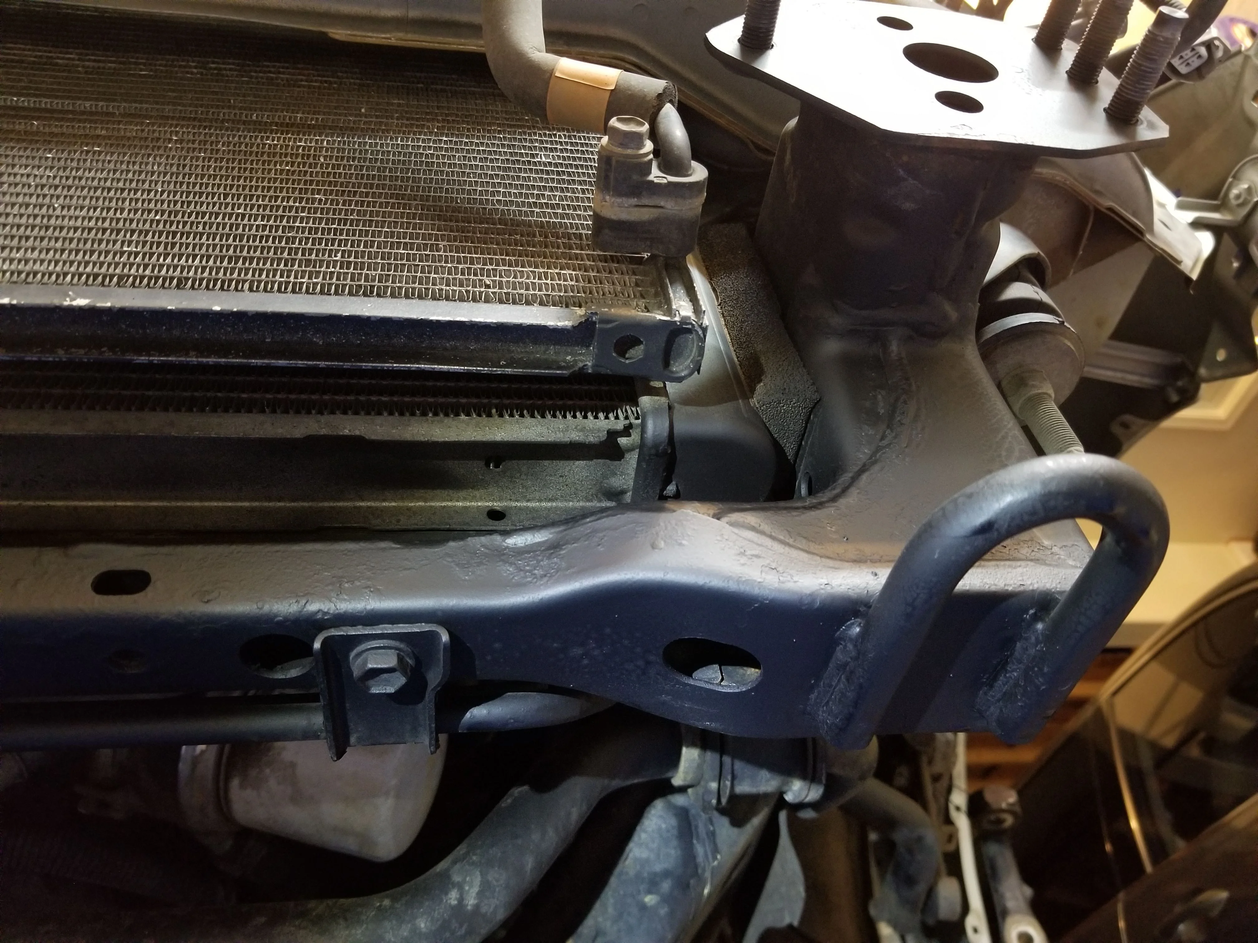

  3. The lower front frame horns? definitely don't look like super strong tow/recovery points as demonstrated on a YouTube video here of a Prados from end being ripped off.
  4. I had some surface and some advancing rust under the front frame support under the radiator. I wire brushed that and other locations (lower shock pertch on LCA) and hit them with some rust converter/primer while I was there.
  5. The 3/4 spacer added just over 1.5 inches from floor to upper front fender.
Bracket assembly reinstalled after complete:
Spacer placed.
Painted after rust removal:
