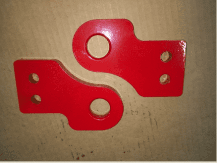

Treaty Oak Off Road recovery points for 120 series (GX470). I think I may have noticed this when ordering, but ignored it with eager, impulsive haste in ordering ;)
"Due to a design change for 2006-09 model years, it will be necessary to remove the factory tie down points for use with a hard shackle."
Trail Taylor indicates similar mods to factory loop are needed for 06+.

I followed trail tailor's step-by-step installation instructions. They're simple and easy to follow. Basically loosen radiator to swing it back, loosen fender liner clip to give drilling access for opening up top, in-board hole. Take care to not puncture radiator then bolt it all together. I dressed the new drilling with Q-tip-coated paint and everything mounted up easily. As I was doing this I thought, "hmm, sleeving the top hole would be best so as to not crush the top box" but I also just wanted them mounted. No torque specs were given anywhere so it's easy to crush unsupported boxes when tightening. . .
So. they're mounted, if i did it again, I'd spend more time and sleeve the top hole for added strength of the box. I'd thought about drilling out and plug-welding some rod too as I don't have, on-hand, a bit large enough, or tube appropriate for sleeving the bolts of the size used for mounting these bits.
AND so, turns out... factory loops interfere with shackle fitment in the recovery point. BUMMER!

So I'll need to grind them off, or see if I can shave down the inboard sides. I might weld a plate to the stubs for strength vs grinding flat... options/decisions. . . . But none of it is emergent.
When comparing, visually, Treaty Oak's to Trail Taylor's, it looks like the TO's recovery loop may be like 0.25" lower than the TT ones. Note lower mounting hole to the top of the recovery hole .. To looks about on the same line, whereas the TT looks like a little overlap on that line... I'll PS it in a bit to illustrate my point...

noob PS, but this should illustrate my hypothesis that these two products are cut slightly differently RE: shackle hole with respect to mounting hole(s), potentially slightly different linear force application as well...
I actually just removed my Trail Tailor points and replaced them with the Apex Overland points and can confirm that the TT points do not interfere with my '09's stock loops. FYI, I took out the TT points because the bolt head was touching with my ebay aluminum radiator no matter what I did- it may have been fine but I didn't like the idea of it rubbing together.
