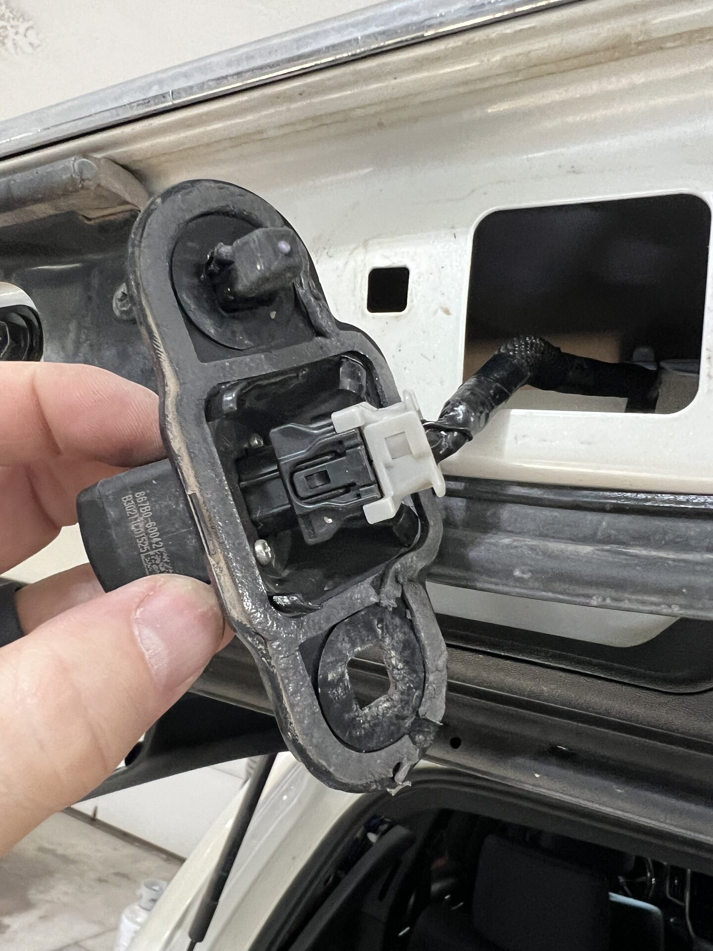

This is my Kaymar Kit. I think i was missing a mounting bracket. The instructions say it came with two mounting options, mine only had this one. Large wire loom connects in the upper left hand corner (rear hatch) headliner and runs down through the floor. Luckily they include a nice grommet. Then the smaller loom runs from under the rear quarter up onto your bumper to the camera.
You have to remove the camera of course. Kaymar instructions say to just remove from here. Those plastic inserts for the screws that hold it in are very difficult to remove - or they were for me. I ended up removing the panels from the rear hatch to gain access from behind. I was also installing a cruiser outfitters rear hatch release / handle so you can exit from the hatch when sleeping in the vehicle - so I had to remove the hatch panels anyway. You'll reuse those plastic clips to reattach the black cover plate that comes in the kit. I use a few butyl strips on the cover plate in efforts to weatherproof it. The factory camera mount had gasketing, the cover plate does not.

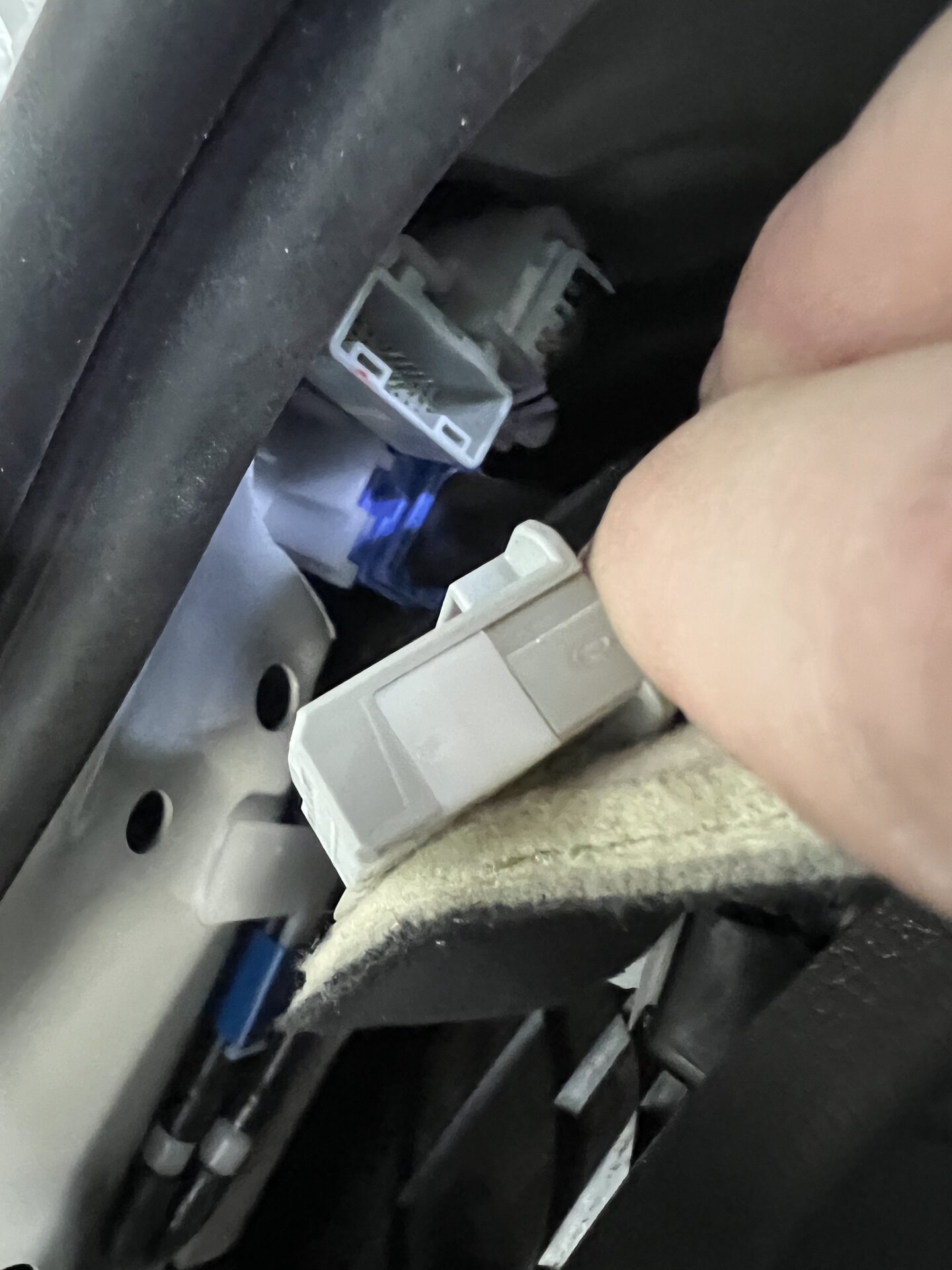

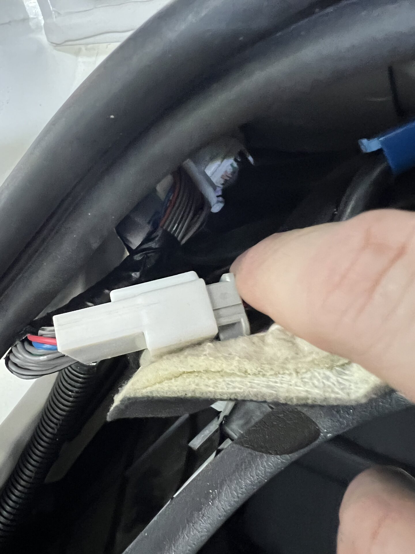

This is the plug just under the headliner you need to disconnect. You will need to pull back the upper and lower cargo panels to be able to access this area. First you'll need to remove the tailgate cover/flap trim piece on the floor. I just popped the first set of clips along the egde of the cargo opening and propped the panels open while I worked in there.
Then connect the Kaymar harness into the end secured up in the headliner and the other connector onto the factory one you disconnected. Route the loom down the rear corner.

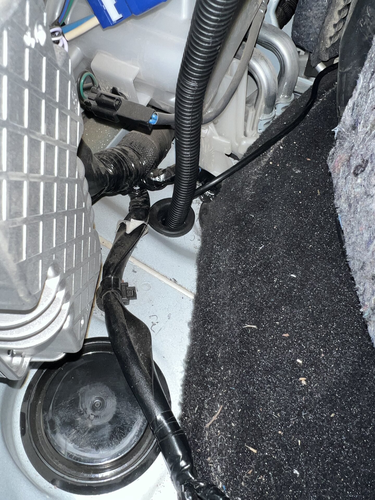

You'll need to drill a hole in the floor for this grommet. The corrugated wire in the photo is the Kaymar loom. I think the hole diameter is about 1 1/8". It was much easier for me to drill from below with an extension on my drill. I was also installing my radio antenna and fished the wire through that same grommet, that is the additional wire you see in the pic.
Installation of the wiring and camera were easy, it was just all the panel removal and drilling the hole, etc that was time consuming.

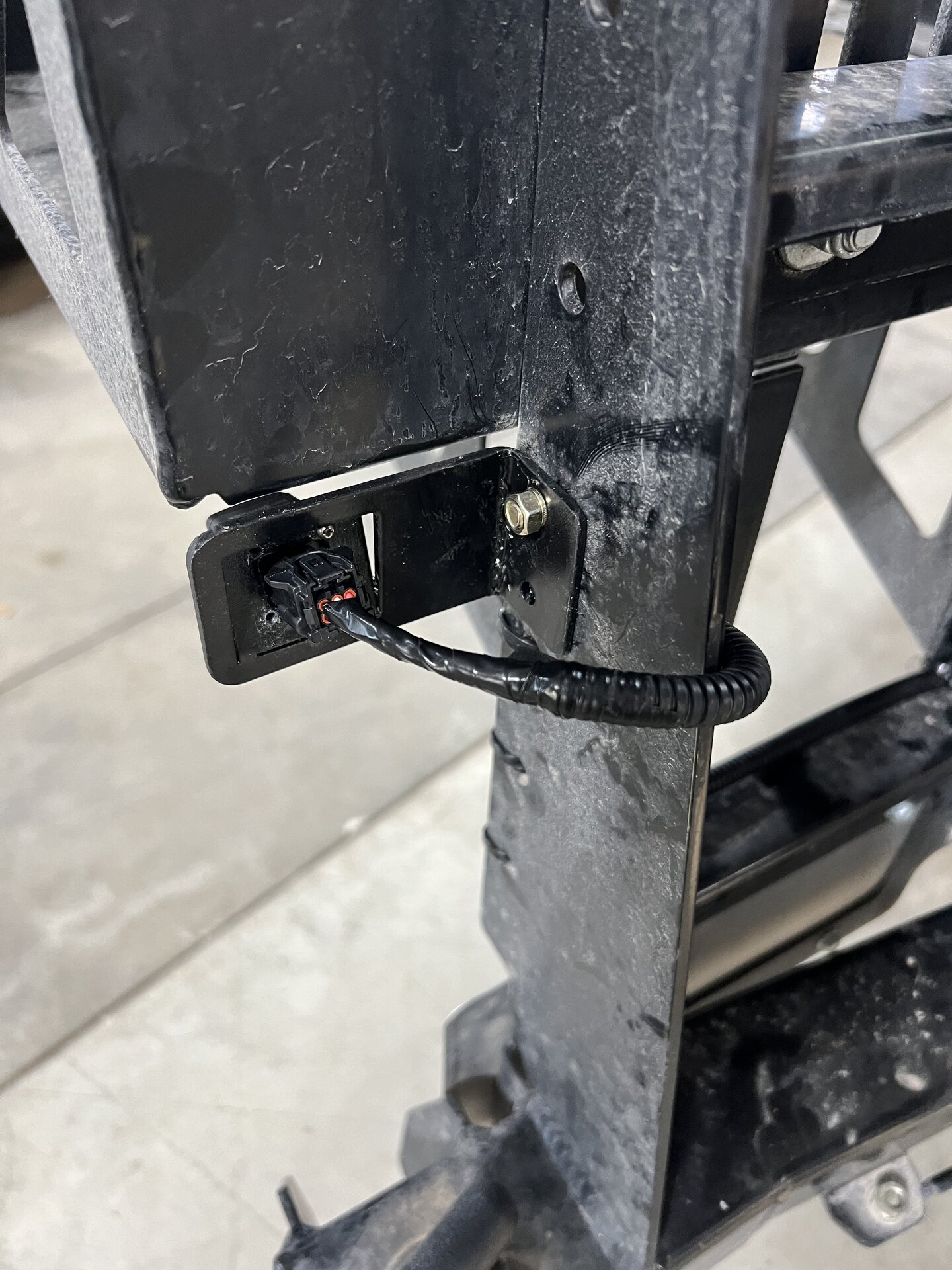

I modified their bracket and mounted the camera here temporarily. The wide angle still captures quite a bit of the spare tire. I fabricated another bracket and plan to install on the underside of the swing out basket so that the camera is about flush with the spare tire. I don't tow with my 200 so not concerned about the hitch. I mainly wanted to see what's behind me easier. Keep in mind that moving the rear camera will mess up your 360 degree view a little. From the factory its calibrated for the stock location, so moving the camera causes some discrepancy in the rear corners of that view, not a big deal for me.

I mounted my camera on the bottom of the Slee basket about 1" out from the face of the spare tire. This seemed to give me the best view. I bent a piece of steel thick enough to be solid. Drilled the same hole pattern on the back as the Kaymar bracket so I could mount the camera. On a wet day I did have some glitching on the camera view. I think I need to seal up the connector from water somehow. Don't really want to use heat shrink because it would make it difficult to remove if I had to - but then I'm not sure why I would.
